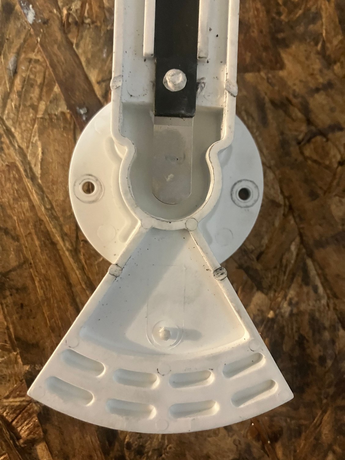

Here's where it gets interesting-at this point I went all the way in and pulled the front apart to check the cap and rotor. I used a Standard Motor w/ brass terminals. It was all put together correctly but the rotor has a groove worn in it from the inside of the distributor cap. I searched all kinds of threads and didn't see this on anyone else's rotor. I'm guessing that is not helping create good, consistent spark. So, I'll get another cap and rotor, compare, assemble with distributor off the car and see what that looks like.
