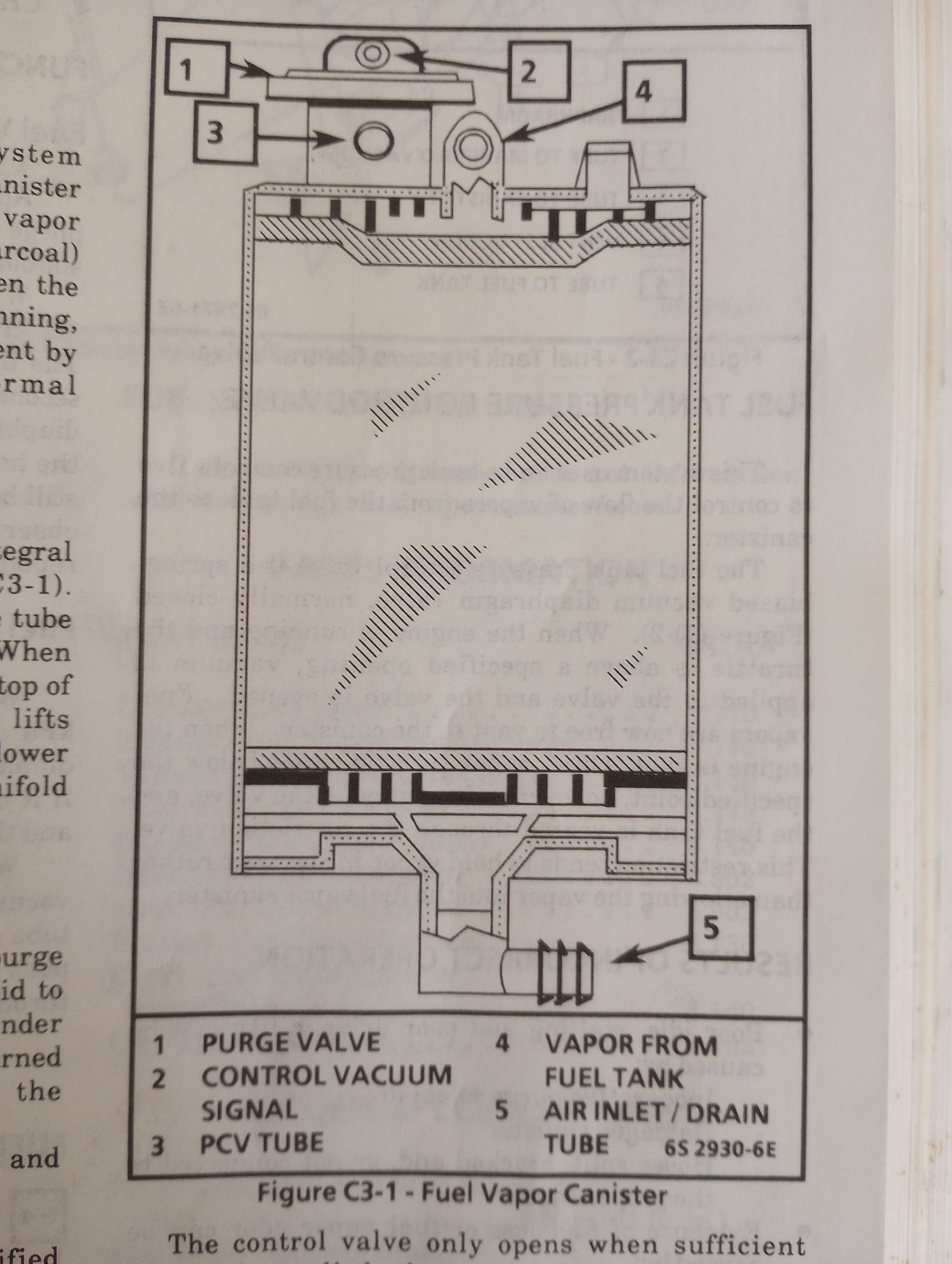

I am including the picture from the service manual for those that need it. I can never seem to find one that has pics that aren't available...
My question to everyone is where does the control vacuum connect from the motor. I am suspect that the last owner had no idea where it went and i have vacuum lines from the can connected to other ports on the can. that is probably why my fuel tank vent isn't working right when it gets hot out. Can someone look to see were the top Port #2 goes to the engine? thnanks

i found the anwer...comes from the TB to the canister. I guess it helps when you actually have vacuum going the canister
