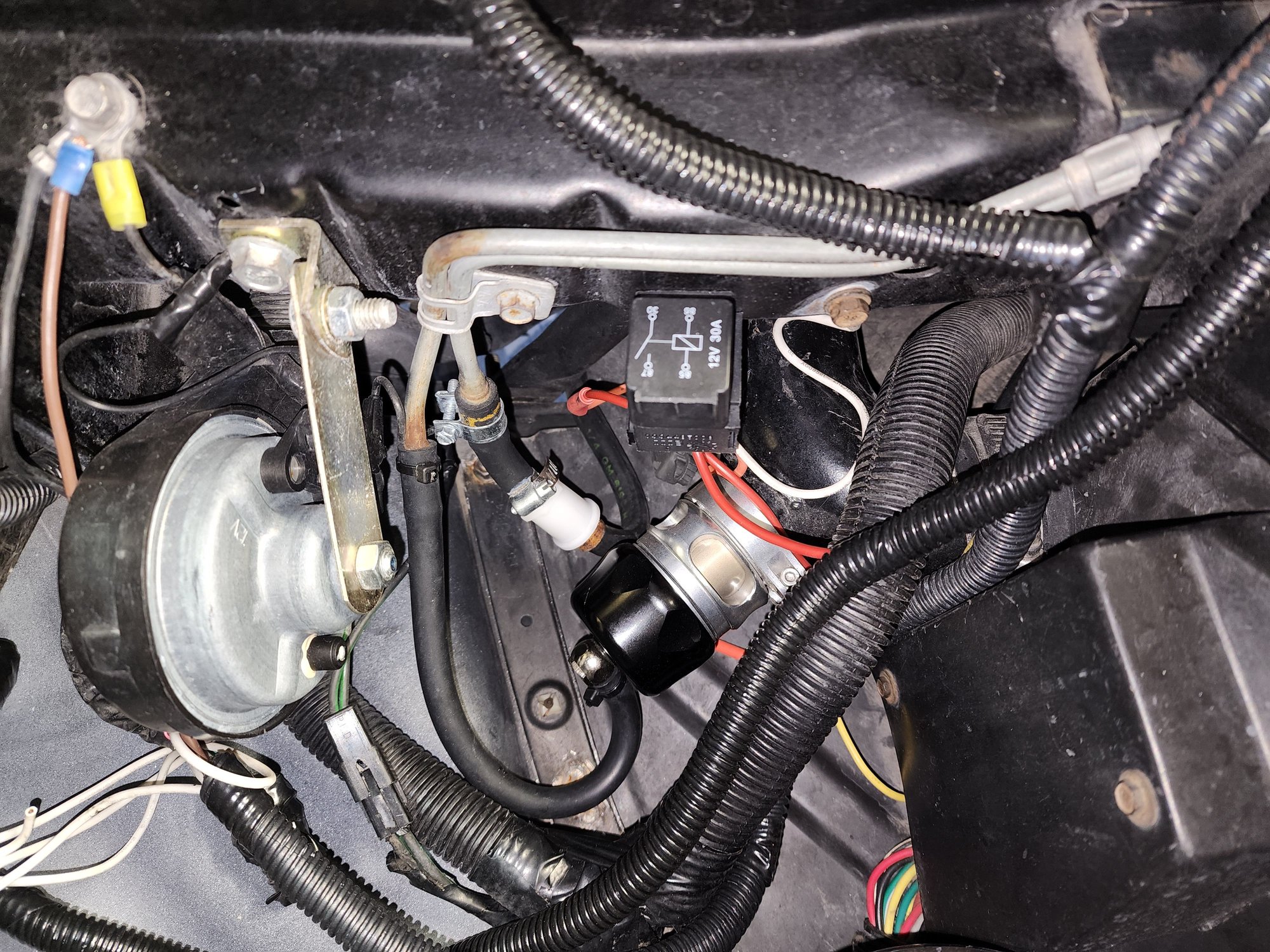

While it's very difficult to see as I painted it black, the charge piping is closer to the rear than the front of the area in front of the wheel. The canister (at least on an 85) is in the front of this space. I doubt it would be in the way. The bigger concern is going to be the passenger side where the coolant overflow tank is.
Also: just turbocharging the car won't make the emissions items "irrelevant". You will have to change things about your PCV system as it isn't designed for boost pressure in the manifold and intake piping as it is in stock form. Callaway left the emissions items in place in the B2K cars. Procharger kits wouldn't be allowed in the Republik of CA if emissions components (including that charcoal canister) had to be removed for boost.
