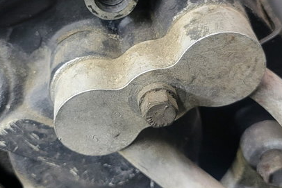

Does this look like the right bolt for the a/c connection. I think someone jacked with it because it only has 3 threads holding it on.

Correct bolt would have been M10 - 1.5 X 40 likely and it would have a 'flanged head'

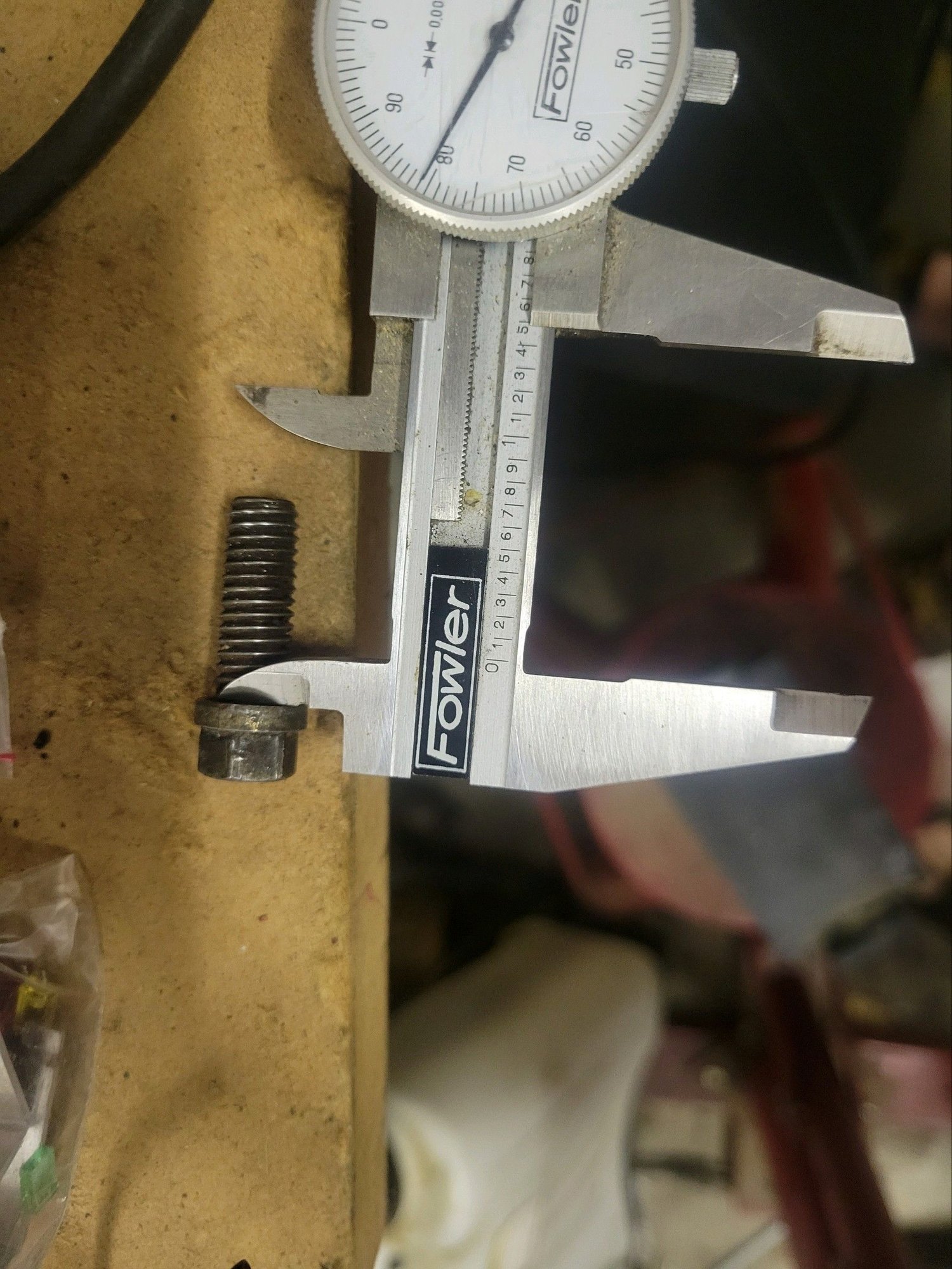

Mine looks original compared to other c4's but its really shy of 40mm (1.5"). It needs to be 40mm

That looks like a bolt for exhaust headers.
On your picture there is a faint outline visible around that bolt, and that is from the original bolt with a larger head.

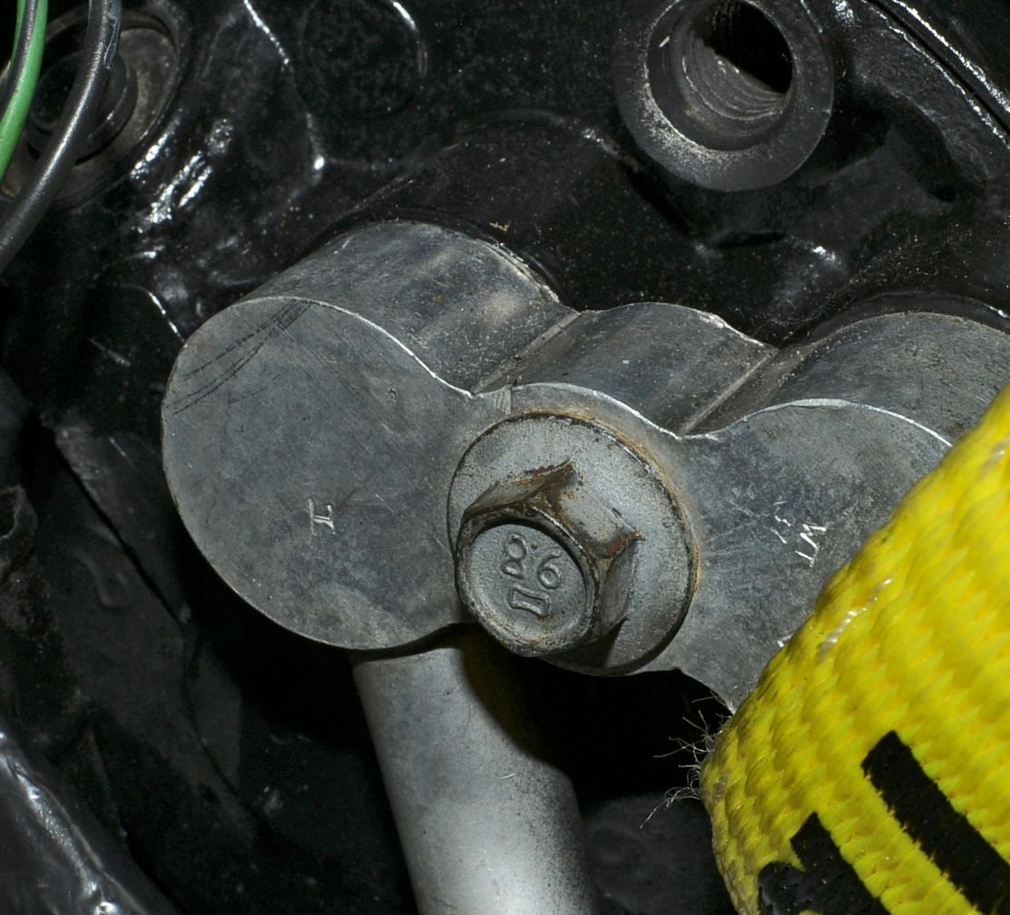

My 87.
