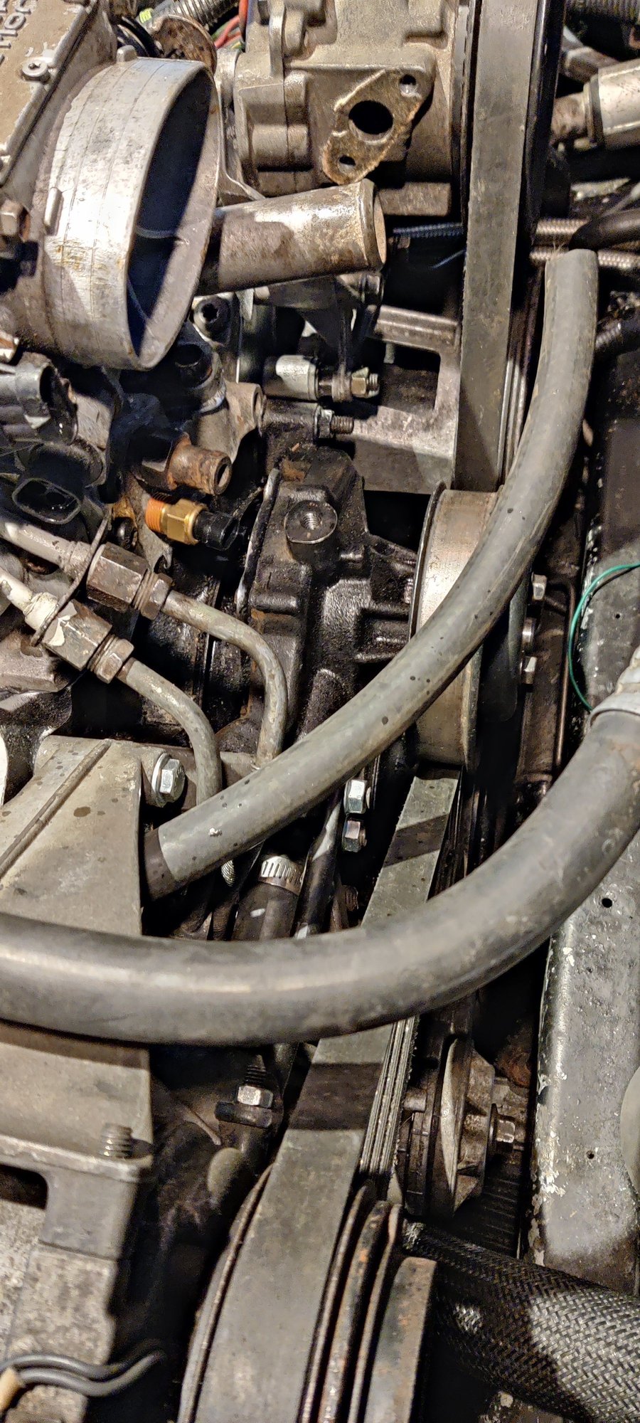

Hello everybody, I am finishing the assembly of my 89 6 spd. I removed the pipe that heats the TBI. I am wondering how you all have run that hose? to the heater core. Mine looks like it is going to rub on the valve cover. Oh and does anyone know what is the paint color of the valve covers. Thank you
I can just sneak it past the AC compressor. But, it is going to rub on the valve cover. Thank you

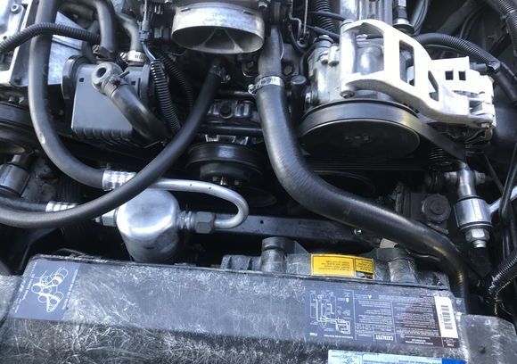

I ran mine this way when I bypassed the TB...sorry, these are the best angles I have pictures of...

I thought of that. I was hoping for something a little cleaner. Thank you
My thinking was to expose as little of the hose as possible to a serpentine problem.
Where it actually does cross the serpentine can be wrapped with a hose guard.

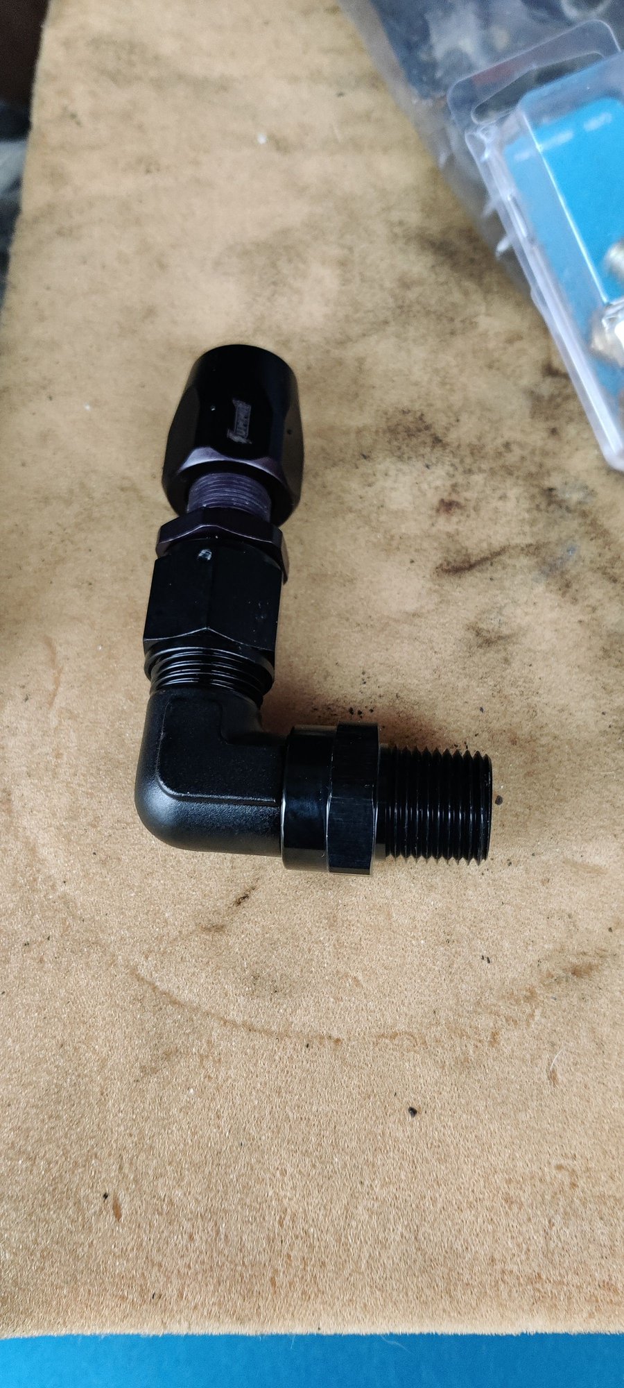

So I decided to route the heater core hose against the motor under the AC compressor. I tried to use fittings for braided hose. I ordered some from Summit. The compression nut would not go over the hose. I had the same problem when I was running braided hose for my oil cooler. I was sending them back to Summit. The technician asked why I was sending them back. I explained the problem. He said let me make upthe order and send it to you. I guarantee it will work. I did and the fittings did work. I am hoping that I can reorder and use thebraided line fittings. I think it would look so much cleaner
I am using a plumbing fitting. I painted black for now.
This is what I want to use
fittings
To Hose
