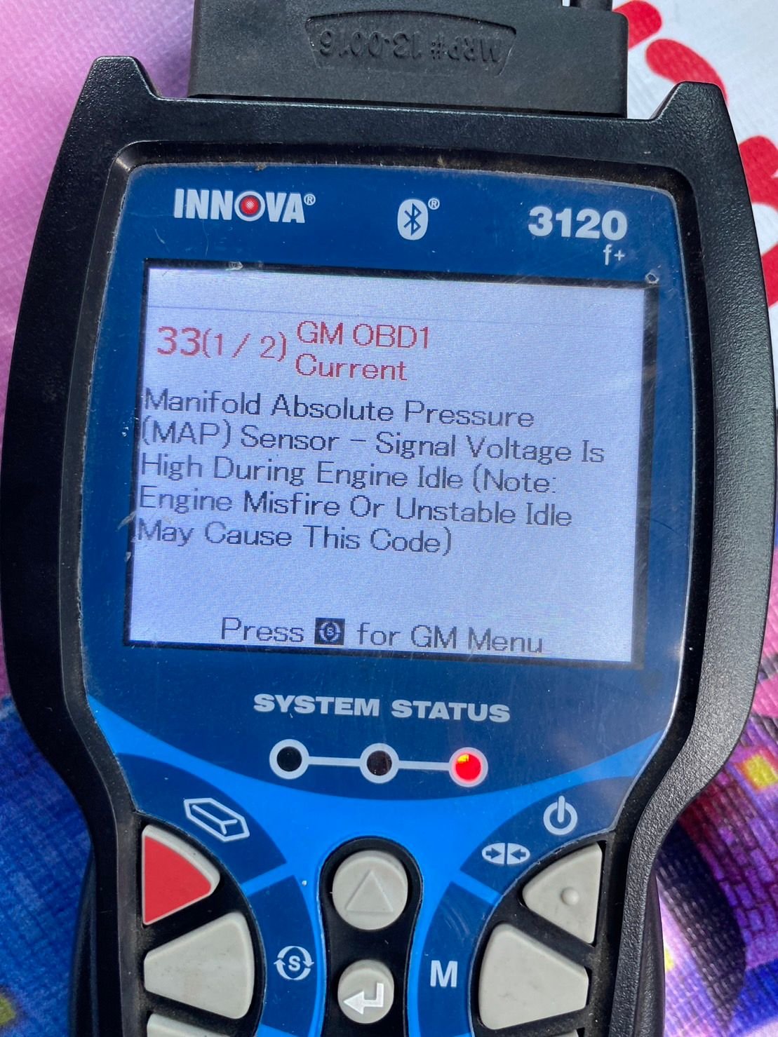

This is all I get on the scaner. the first one I did change the MAP sensor now it say the problem is with the prom?
To 1990 TPI prom?
