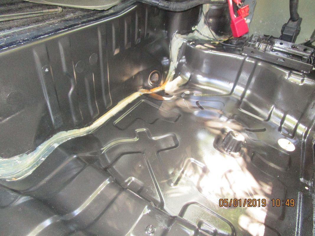

Grounds and power cable aside, now focus on the installation itself. You can add a battery tray to most cars by welding in a few angle irons and fab a hold-down. Make sure whatever you do it is attached to the vehicle properly and held down or the battery will fly through the air in an accident. I avoid battery box if possible by using the Sealed Lead Acid battery design, my favorite is Might Max battery (look on ebay for a battery). I tested a 48?AH Battery I think about maybe 8lbs pretty light weight, about half the size of typical car battery, its base voltage is 13.2V and it cranks over the V8 from the trunk easily I've used in friend's installs successfully since 2015's. I've also tried the smaller version out of curiosity they have a a 32AH design that works just as well and its even smaller, I carry as a jump box now. They are like $35-$45 back when I got it but they went up in price since then. Its sealed to mount almost any position and wont give off fumes when charging. It uses standard size attachments if you get the right posts for it. In my trunk I just use the walmart battery because every year they give me a new one free so why not and since its in the trunk its legal with no box I think. Its been a while since I Check the rules though in the past they just look to see if its held down and then kick you out for 10 seconds or whatever.
What else is there, hmm. Its sealed. Its wired right. Its firmly attached to the vehicle. I think thats it?
Not a corvette but shows the angle iron battery tray with slots for a hold down and decent designed connectors.

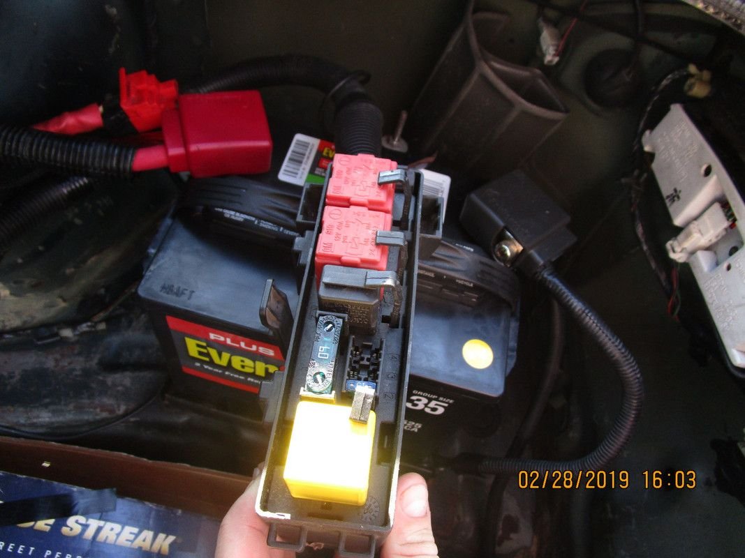

Ah, the connections and a fuse. Yes. I use 'knuconceptz' battery connector posts because they have insulation and multiple ports for wires (I run my fuel pump relays directly from the 8gauge port on the red terminal, very handy). I also have a 150AMP Inline fuse on the positive cable as it runs inside the vehicle and through the firewall. Use a proper firewall plastic insulated grommet designed for battery cables, not a rubber one, use the heavy duty plastic insert screw on style.
Here is the relay box I prefer for the trunk install in my vehicle
This box has a lid, so water proof. Its from some kind of SAAB. I prefer this one because of the 60Amp Relay and 60Amp Fuse (Yellow relay is 60) Perfect for high amp fuel pump. The red relays are typical 40amp for stuff in the trunk like water pump or methanol or whatever. kinda cool for $12 junkyard box. I don't use anything aftermarket in my vehicles, only OEM wiring/relays/boxes and only use solder and heat shrink to make connections. Never use crimps and anytime you have a power wire with a heat shrink I advise double shrink and sometimes even tape it up over that shrink. No accidents no mistakes.

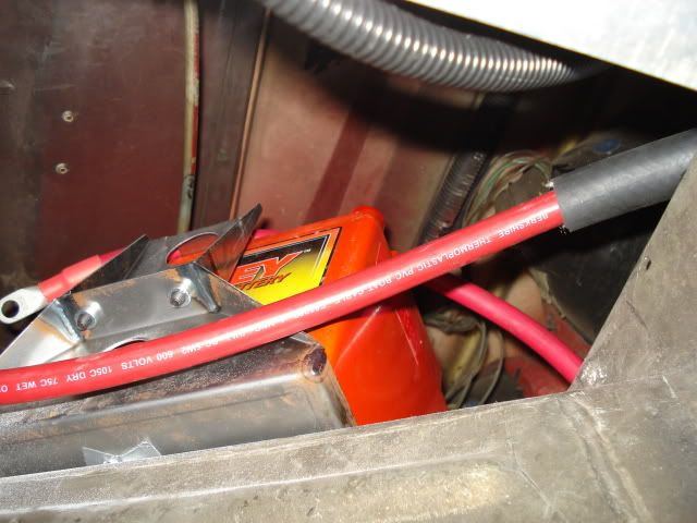

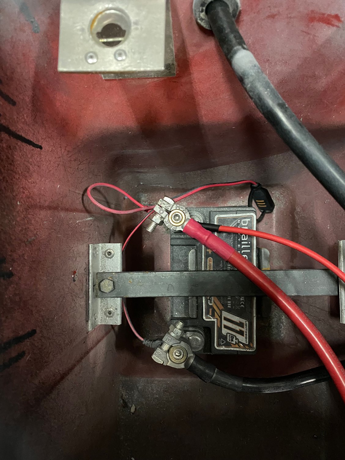

Here is where my Battery ended up. The hold down is a billet Aluminum one made specifically for the Optima. The rest of it was made in house. It bolts to the rear crossmember.
Old Apr 7, 2023 | 12:08 PM
Gale Banks 80''s Avatar
Gale Banks 80'
Joined: Nov 2008
Posts: 3,720
Likes: 557
From: Seattle Washington

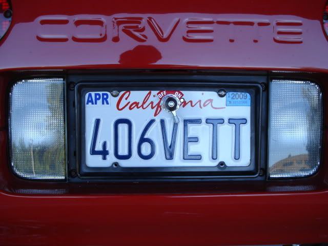

The ground runs to a disconnect before it goes to the original location on the Bellhousing. Note this car has had the AC deleted.

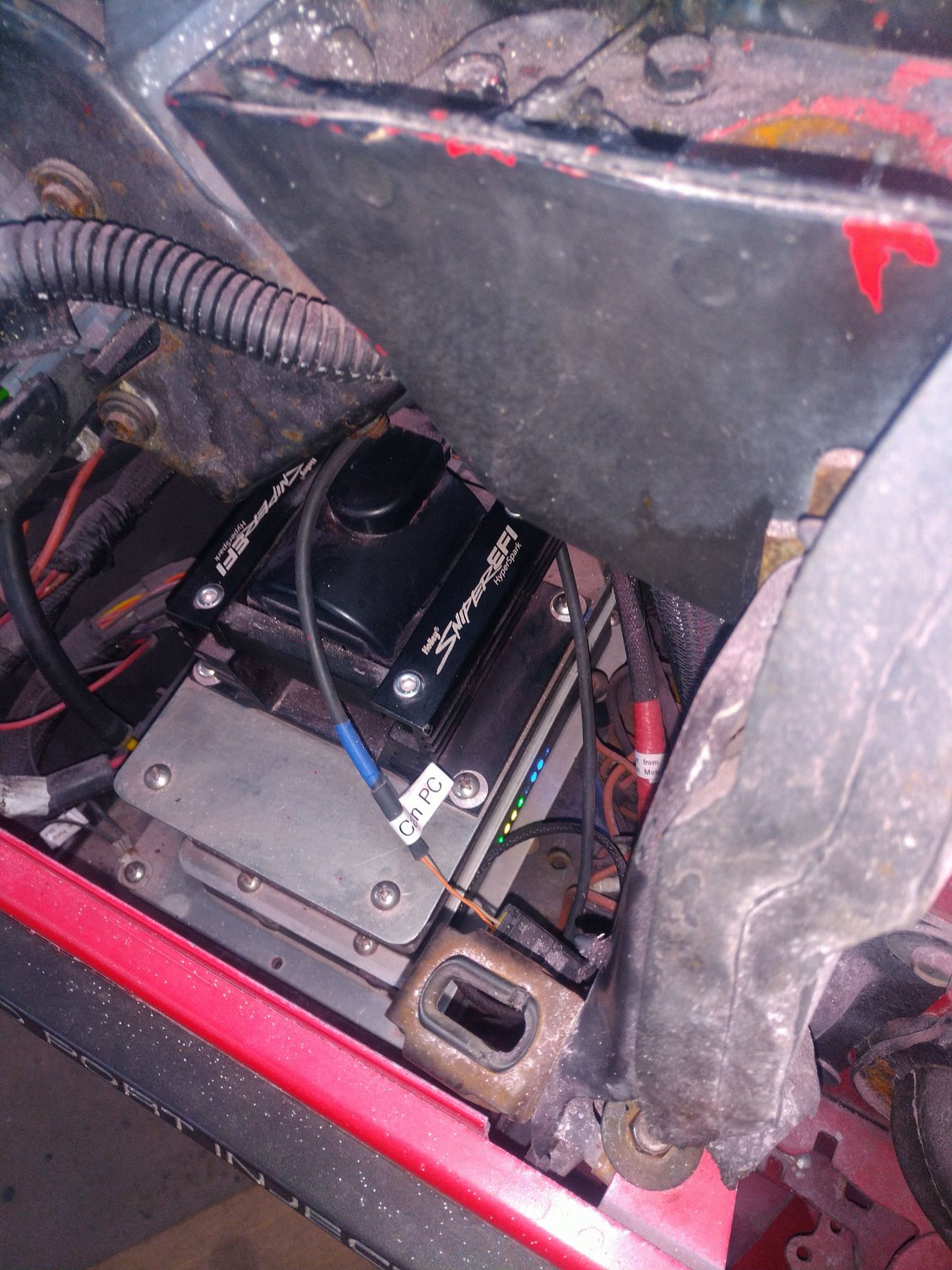

Default Ecm
The compelling reason to move it was to create a space to put my Holley Terminator X ECM and it's components.

Here's what I did...
