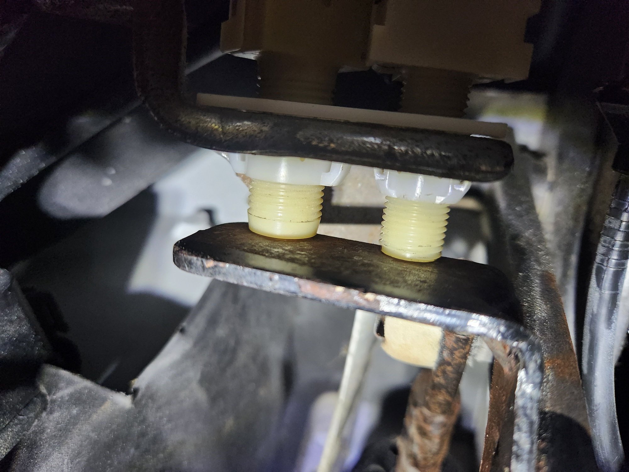

Here are some pictures of how they are sitting right now if they don't look like they're sitting right let me know ,and if you can please explain how to properly adjust it.

That's pretty good you're adjusted, now if you want remove the switch just put something between switch & plate and give the pedal a little tug back and the switch will slide back.
Great picture don't loose it Pictures say a lot like adjustment how it's held so things can be explained
