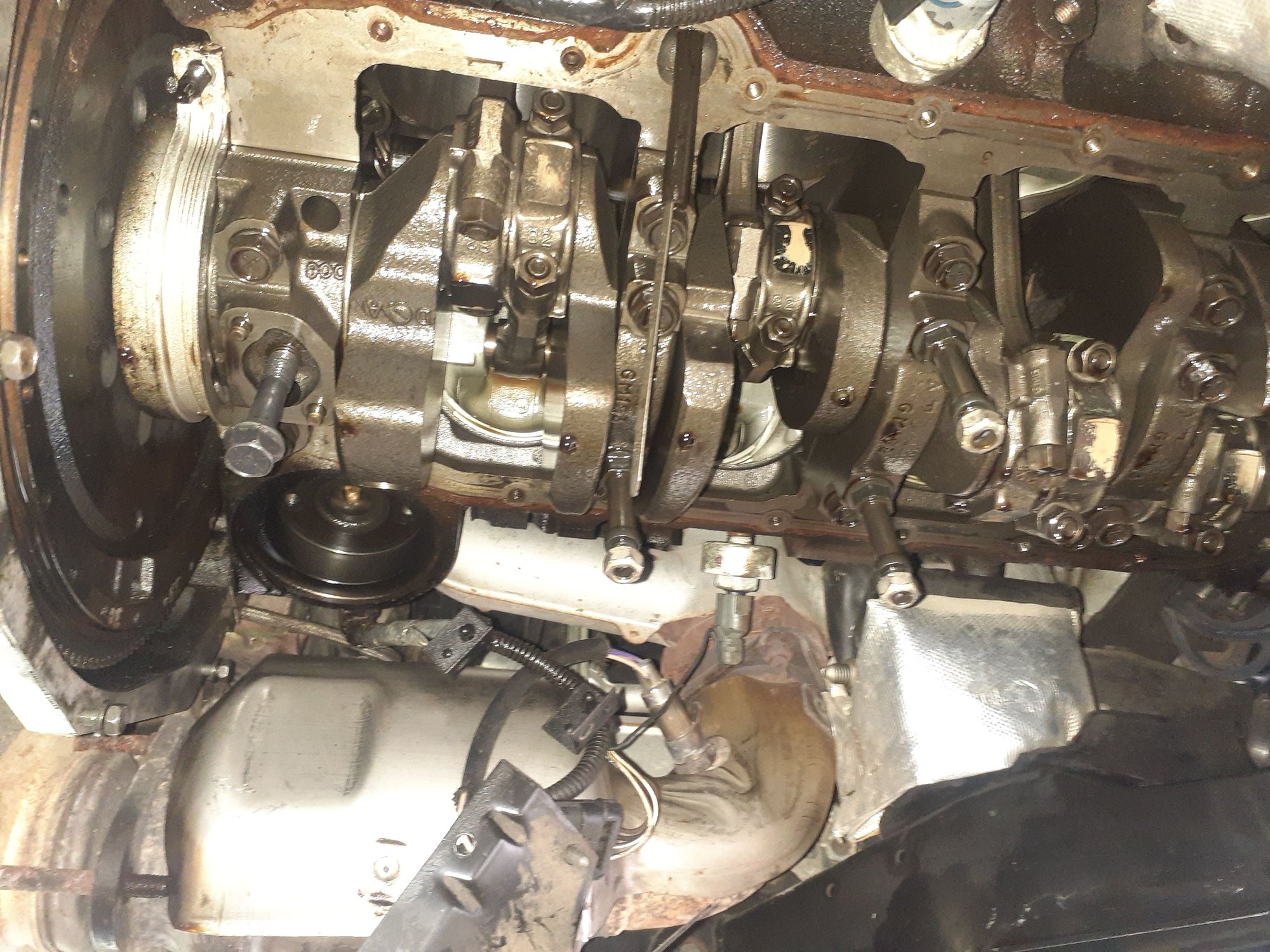

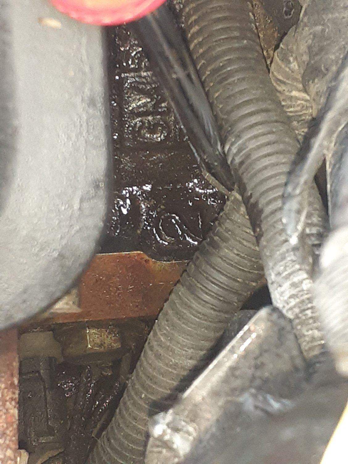

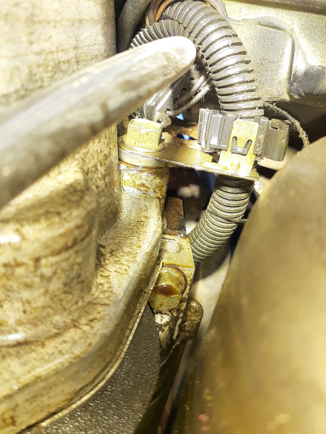

Started to tackle leak yesterday. Tookcar for a 5 mile drive and had 4 oil spots. No leaks from oil pain gasket.
I will remove oil pan and oil cooler area this evening.
First pic is from on top on drivers side as I noticed a little oil sitting on back of block.

Oil pressure sending unit ?
Not sure. Ill check that tomorrow. Thanks

Likes: 1,009
From: Pflugerville, TX

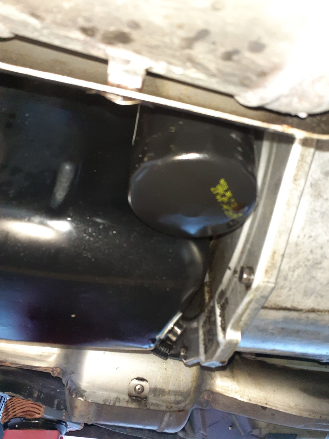

Started with removing the oil filter piece and then took off all 18 bolts/screws from the oil pain today.
Why did GM use 3 different sizes for the bolts?
Got all 18 removed in about 90 minutes. Now got to remove the starter tomorrow to get the pan out.
Nice 72 degree weather in central Texas this evening.
Place all 18 bolts/screws on the the replacement pan gasket so I can remember.

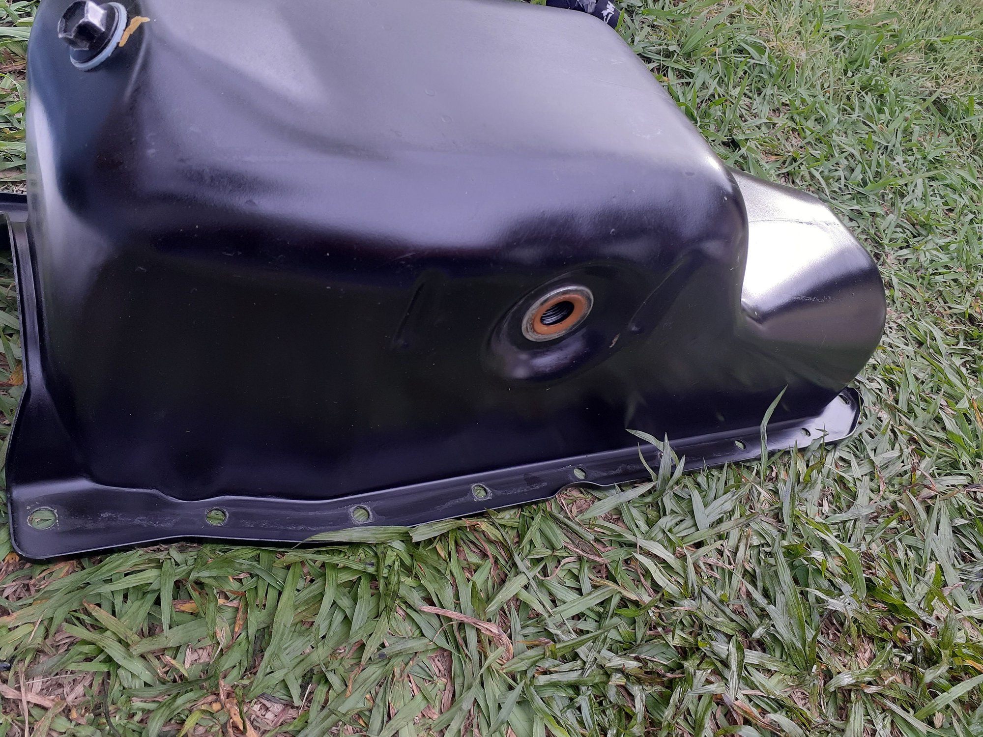

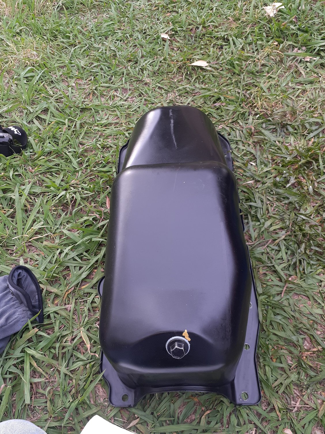

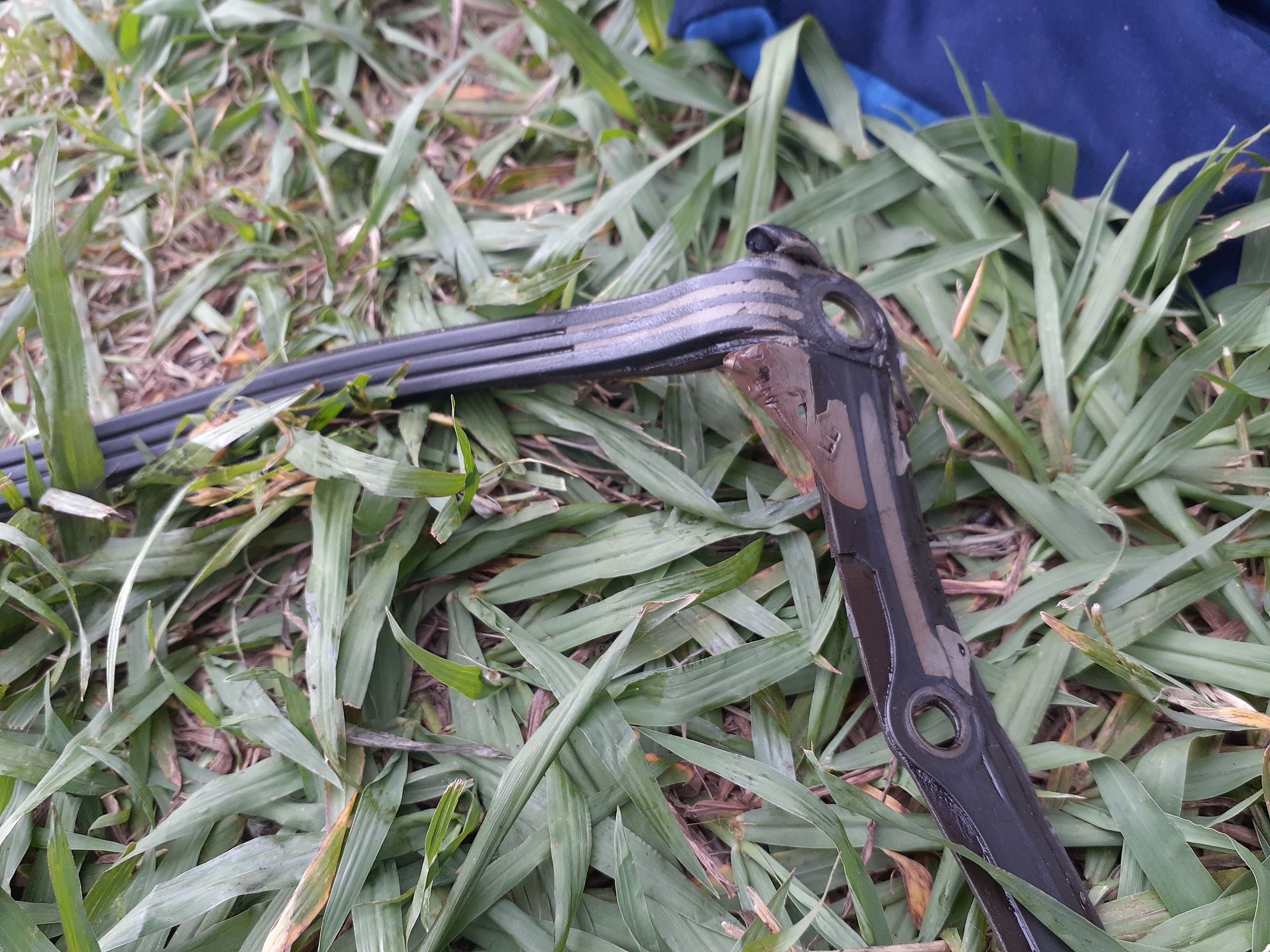

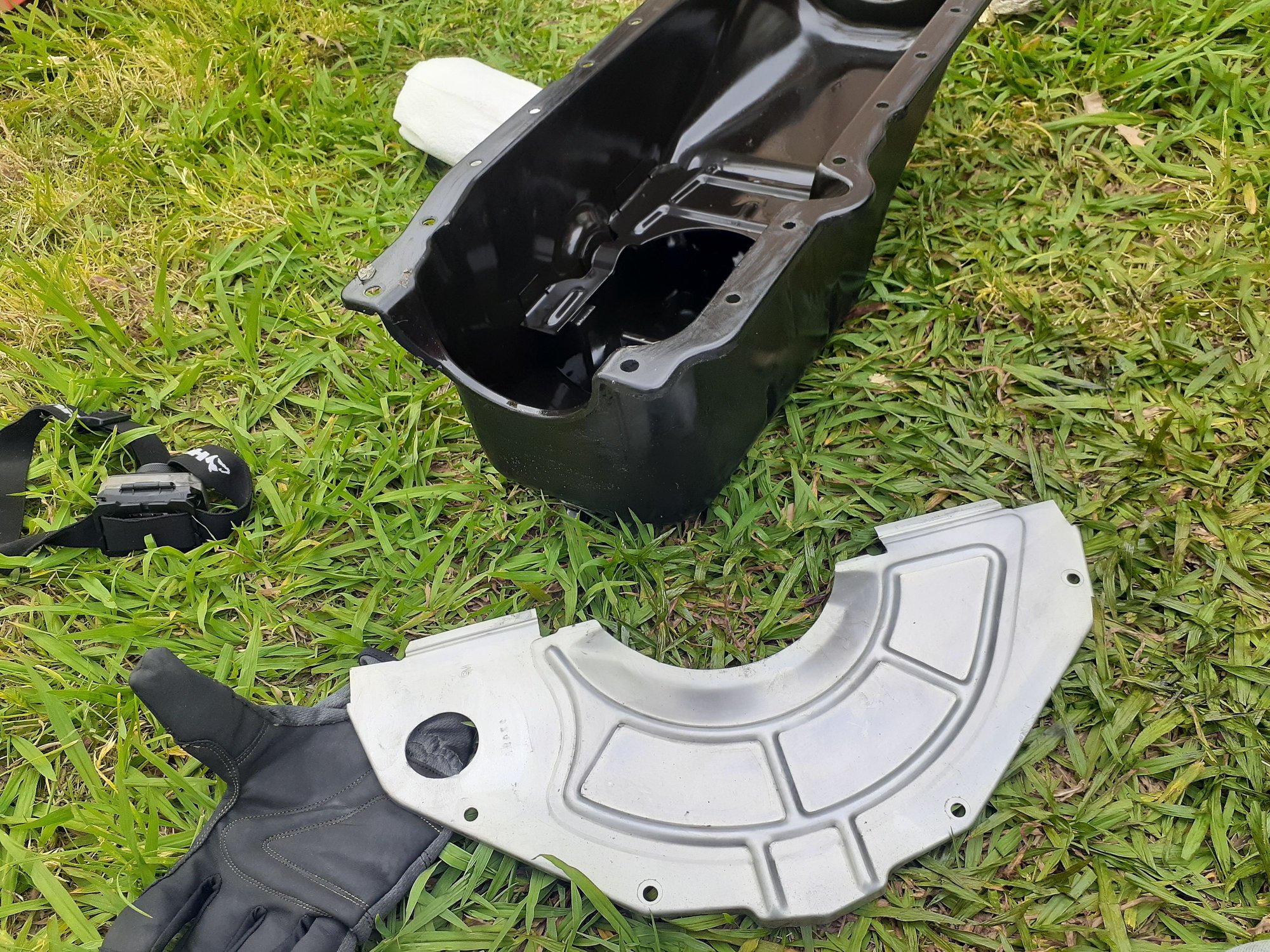

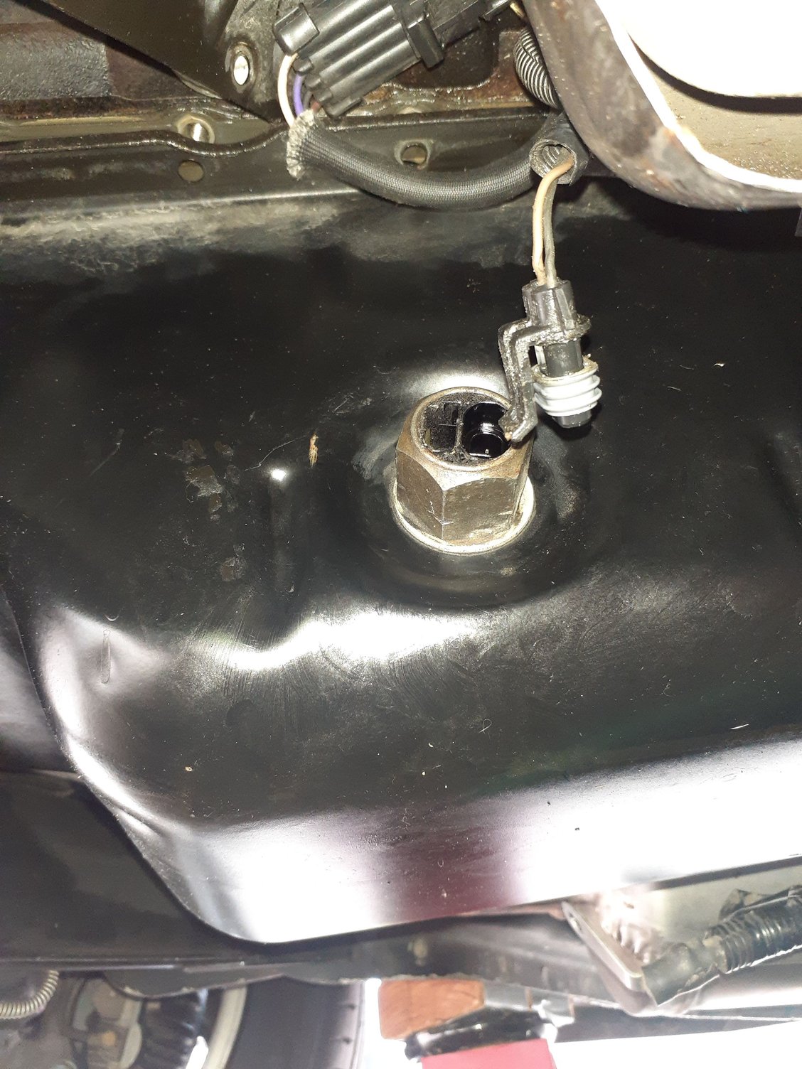

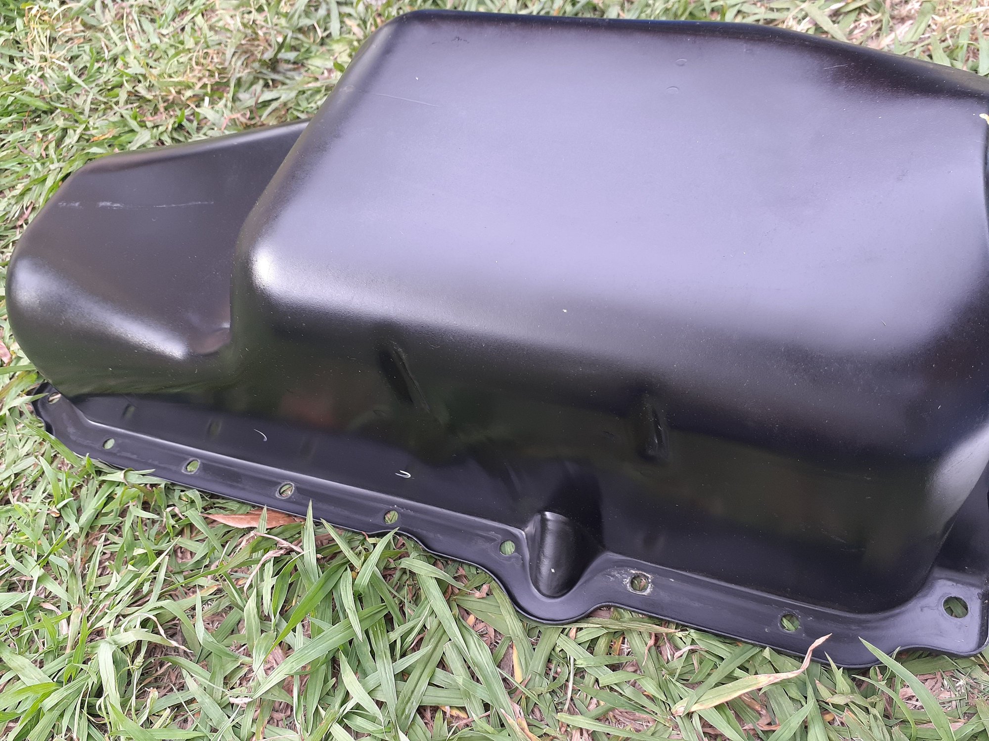

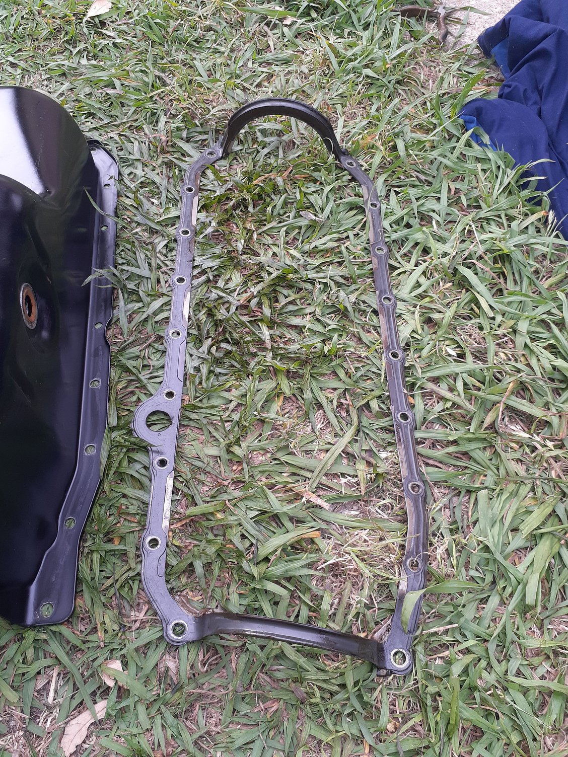

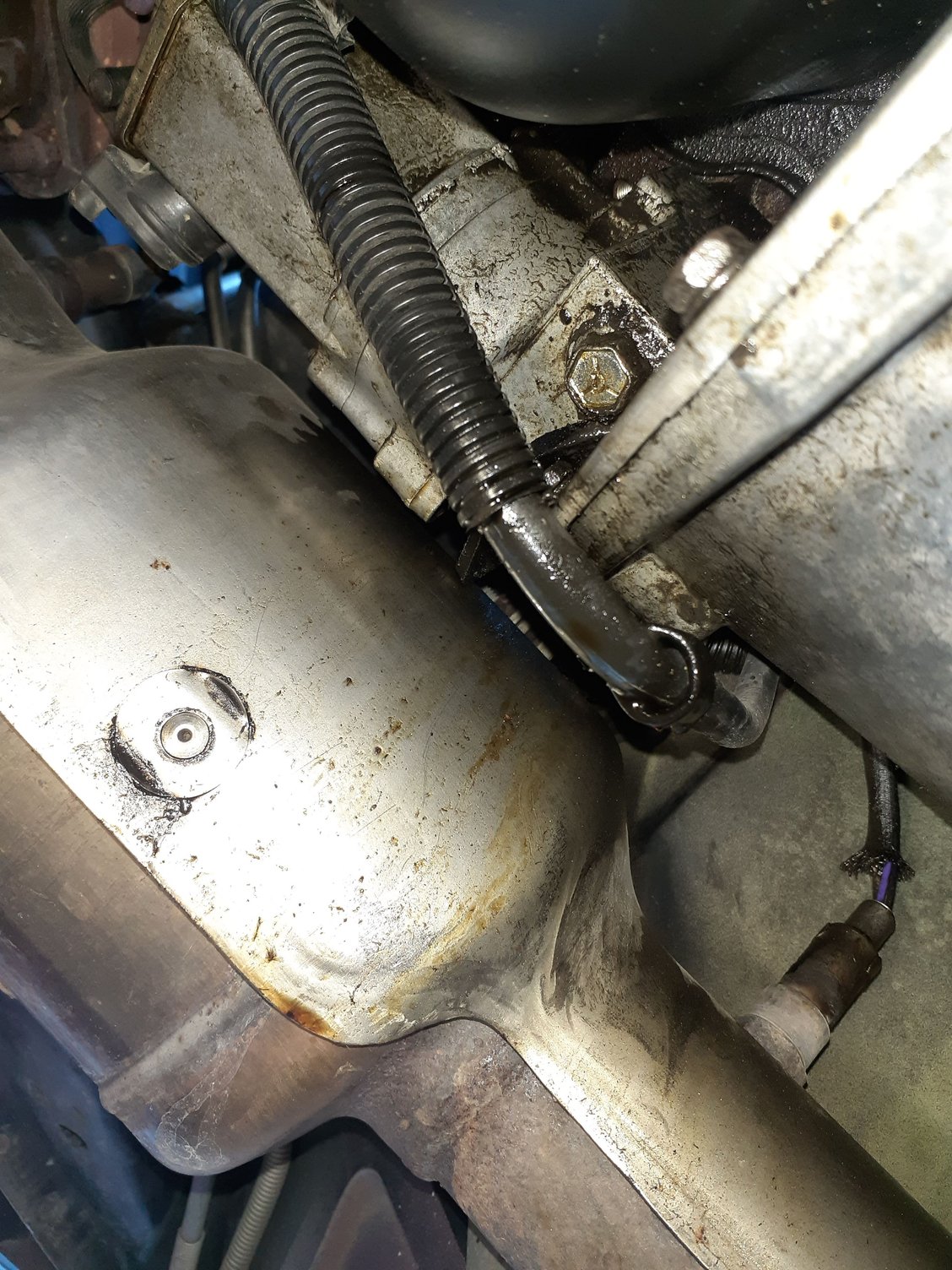

Finally got to wrench on removing the oil pan.

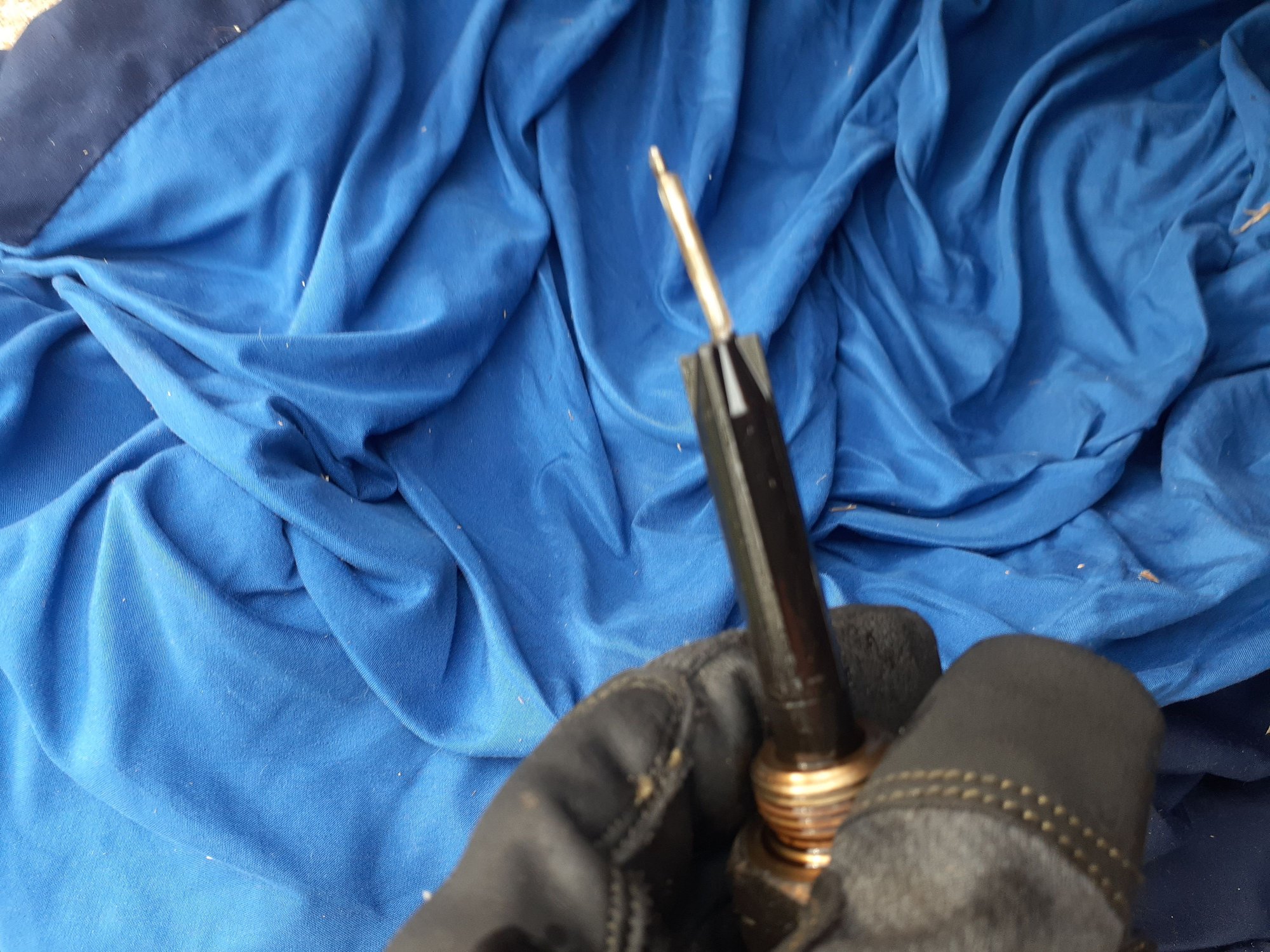

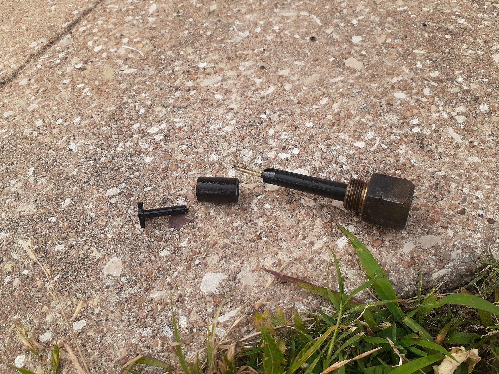

Broke the damn oil level sensor but just ordered one from Advance fro $31.29.
Cleaned up oil pan and engine to tranny aluminum plate.
Good 90 minute workout.
The dipstick going thru the original gasket thru me a curve but figured it out.

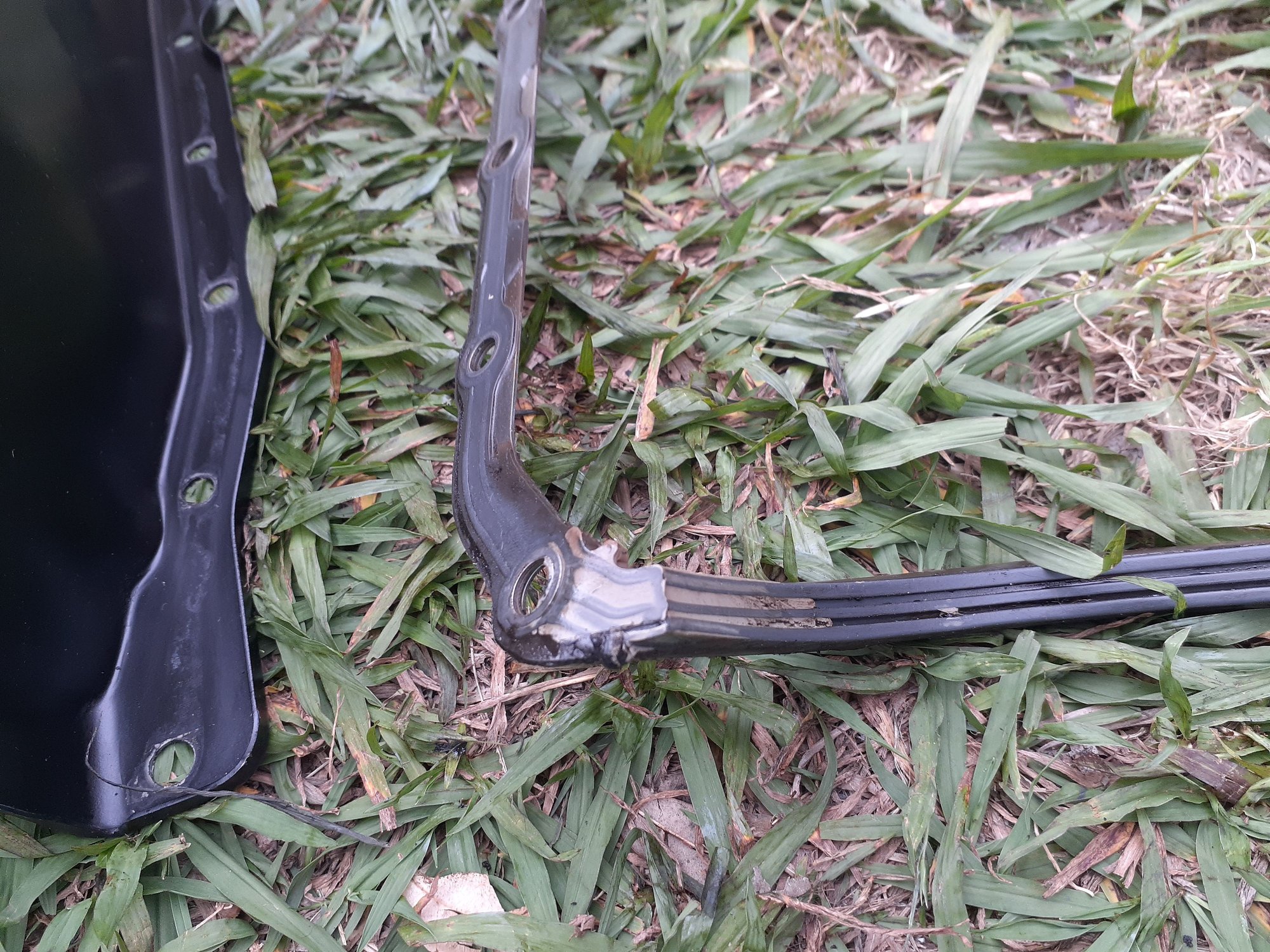

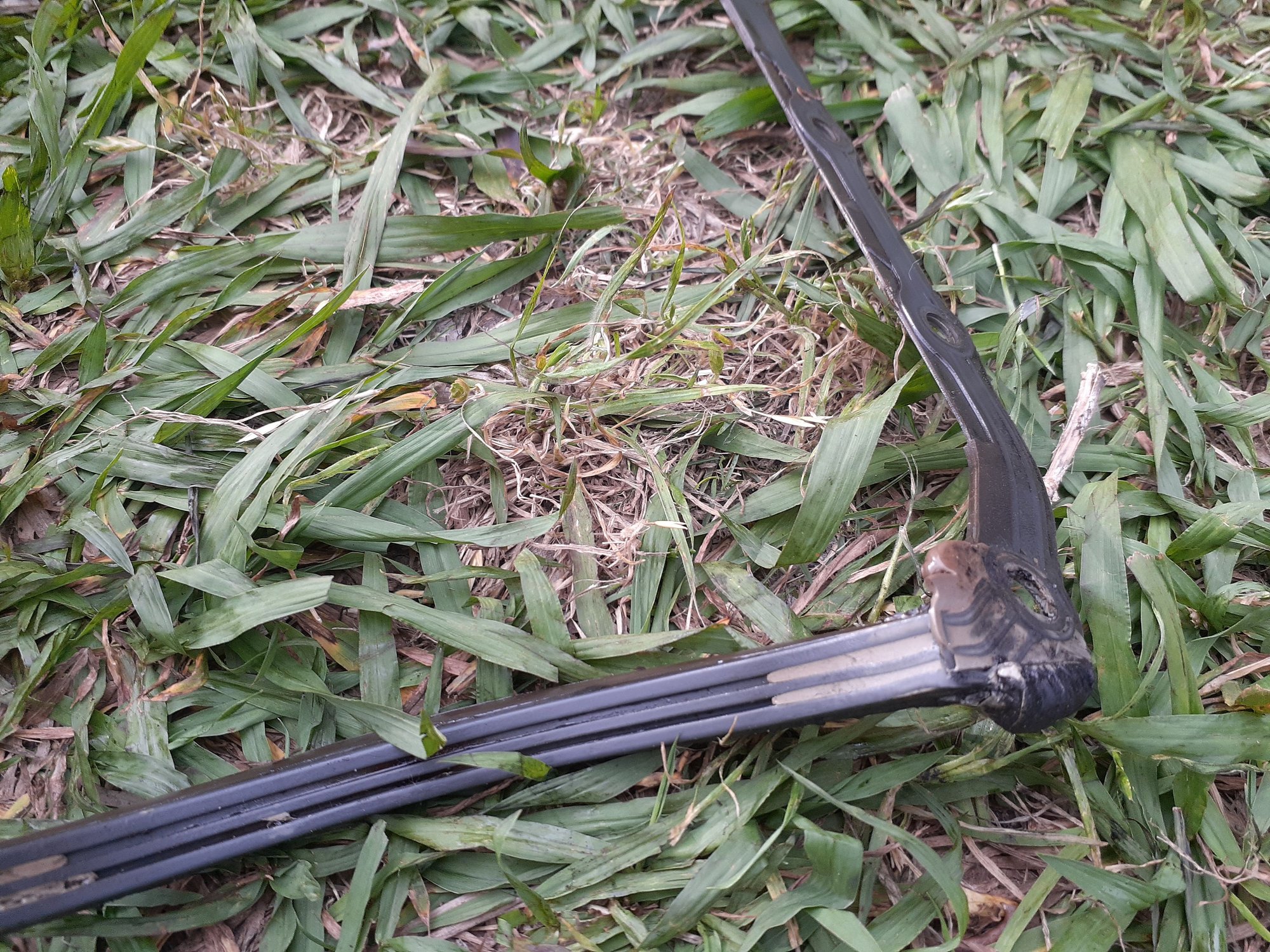

Did notice the factory or one of the owners but some gasket maker on the edge of both front and back ends of oil pan.

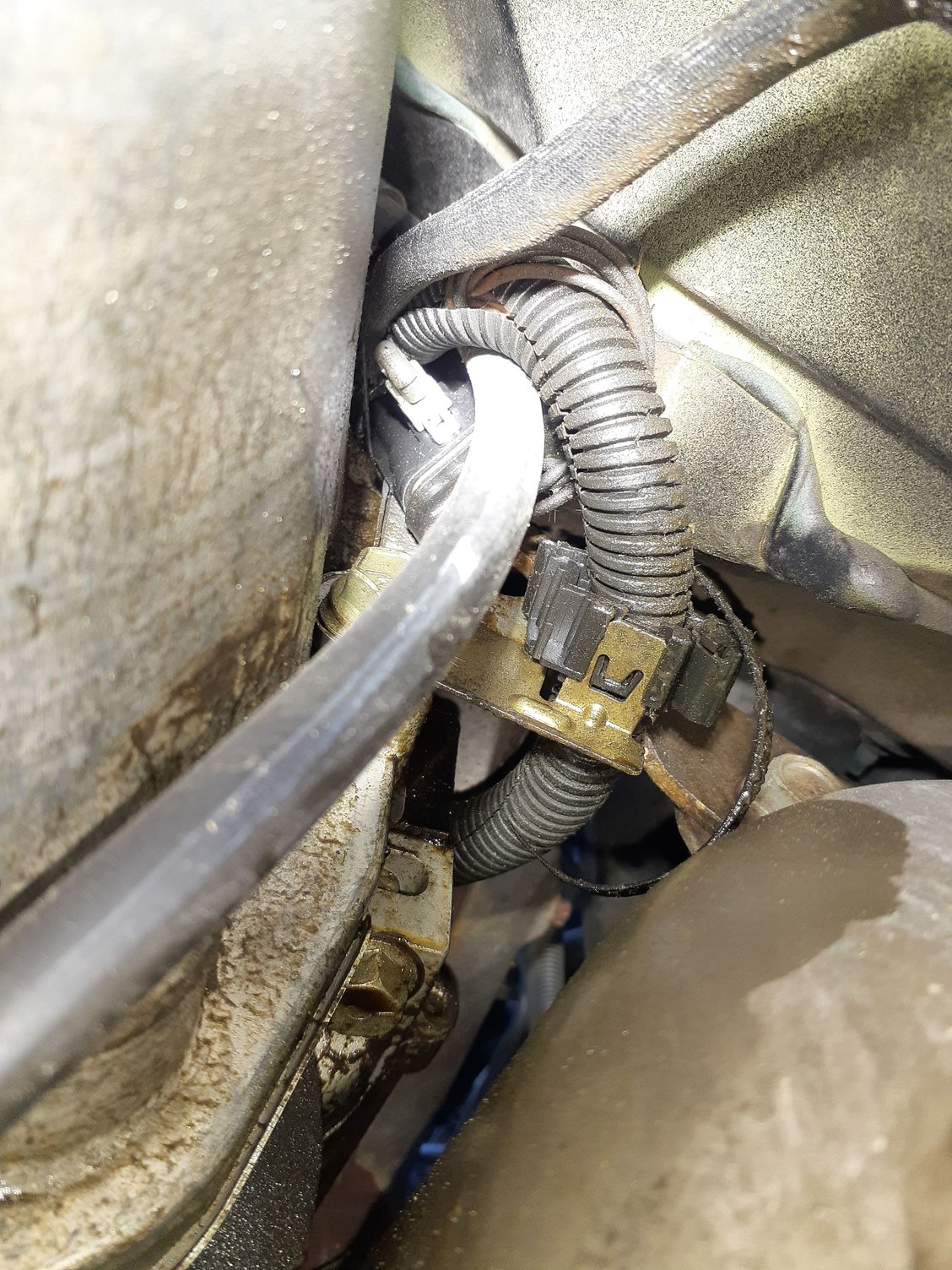

Also in 1st pic, the electrical connector to the oil level sensor is not fun to take out. Need to get deep in with very skinny screwdriver or needle nose pliers to pop it out.
Old May 2, 2023 | 07:56 PM
Topduarte's Avatar
Topduarte
Joined: Feb 2020
Posts: 4,473
Likes: 1,009
Pics of gasket maker added.

The FSM specifies to use RTV on the corners of the block where the caps meet the block. I like to apply it to the area where its needed and let it set up for about 10 minutes so it doesn't ooze out into the oil pan. I also try to smear a little on the pan gasket where it will contact so it makes a better seal.

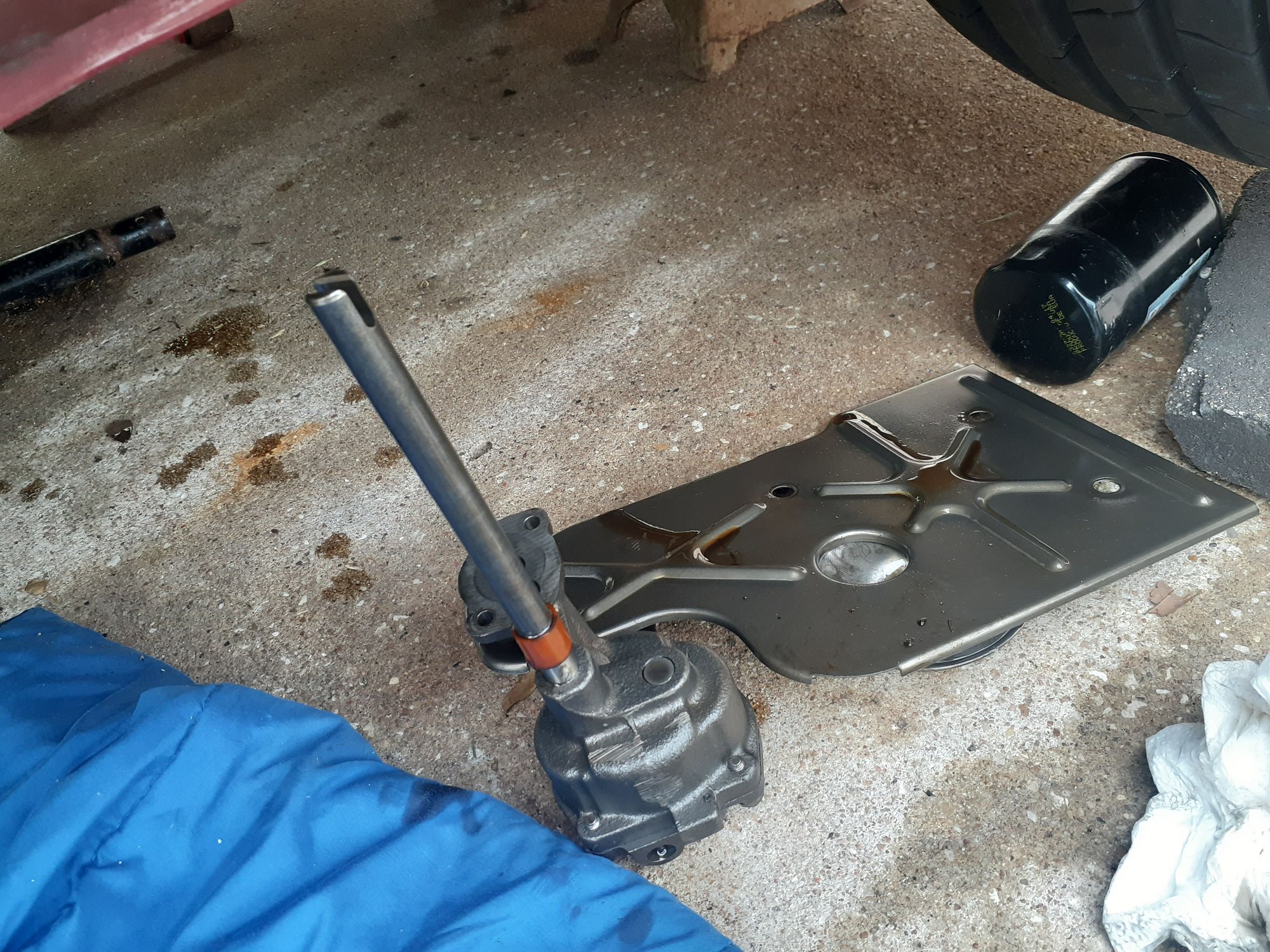

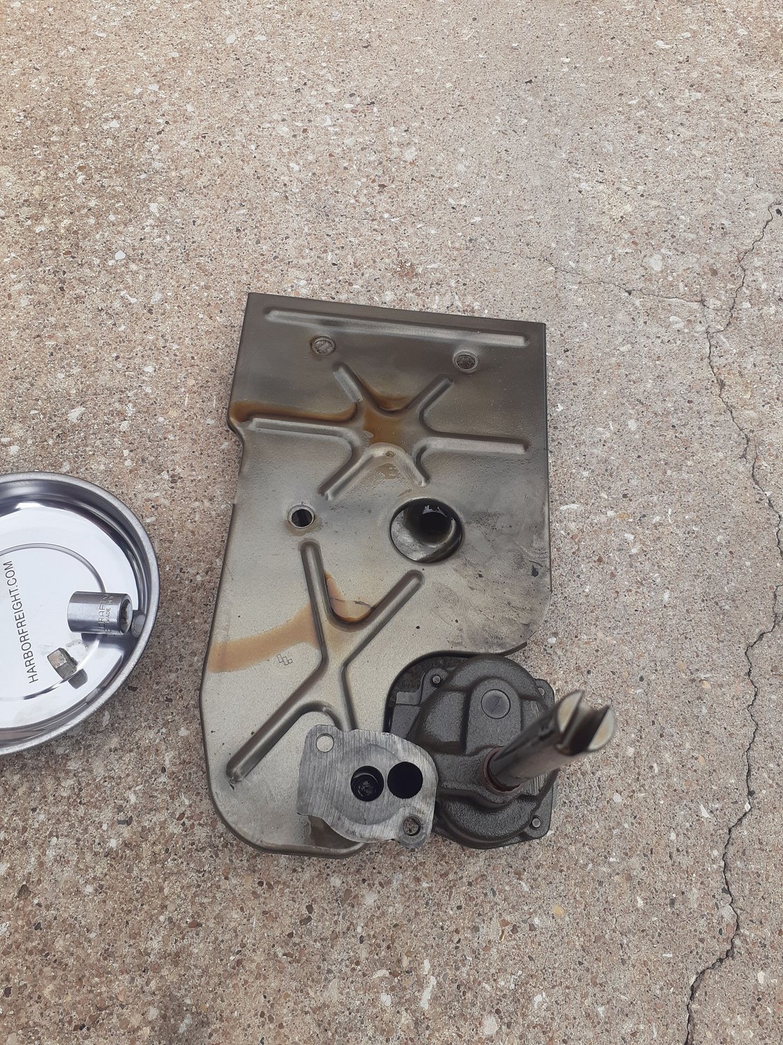

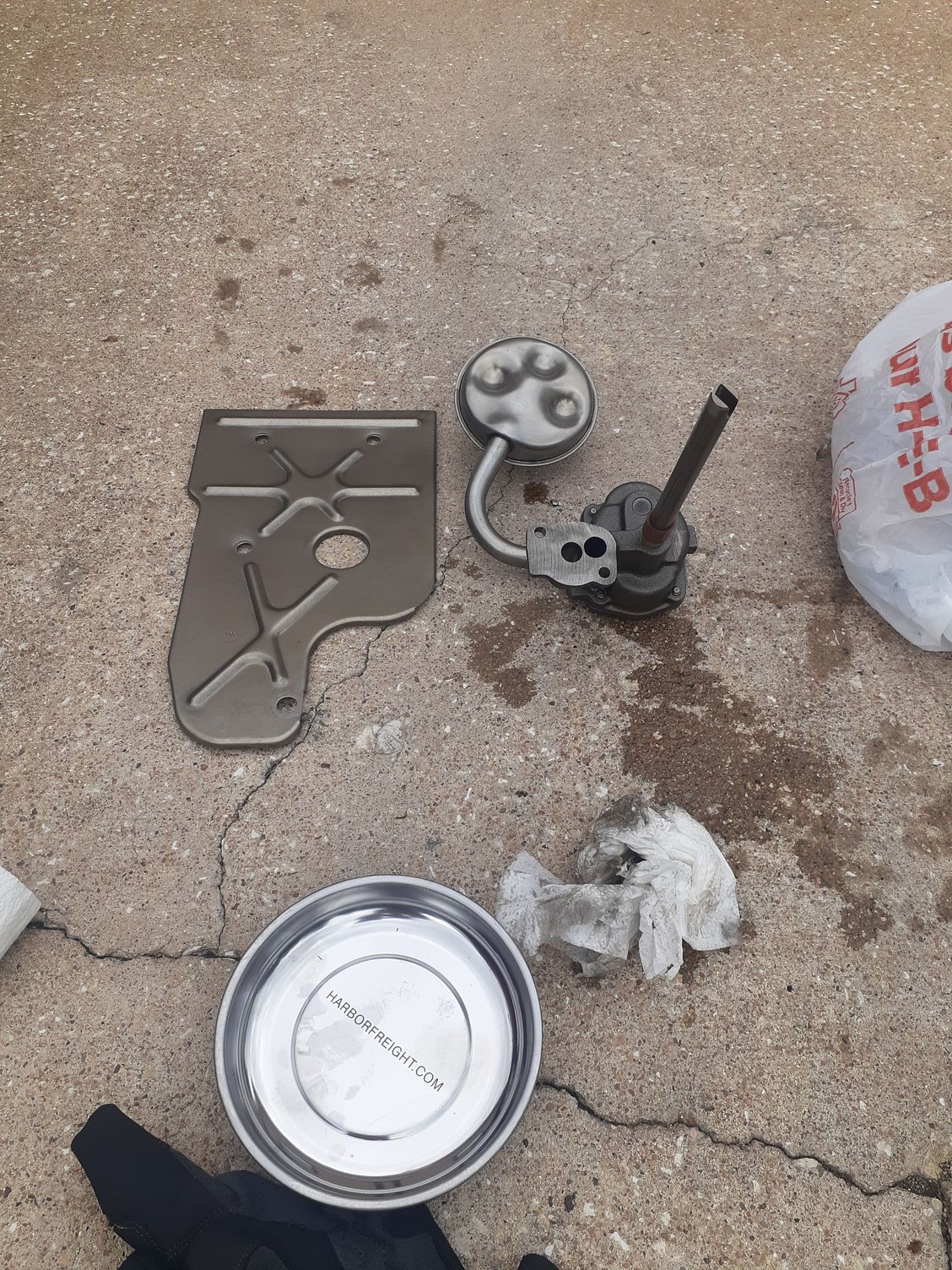

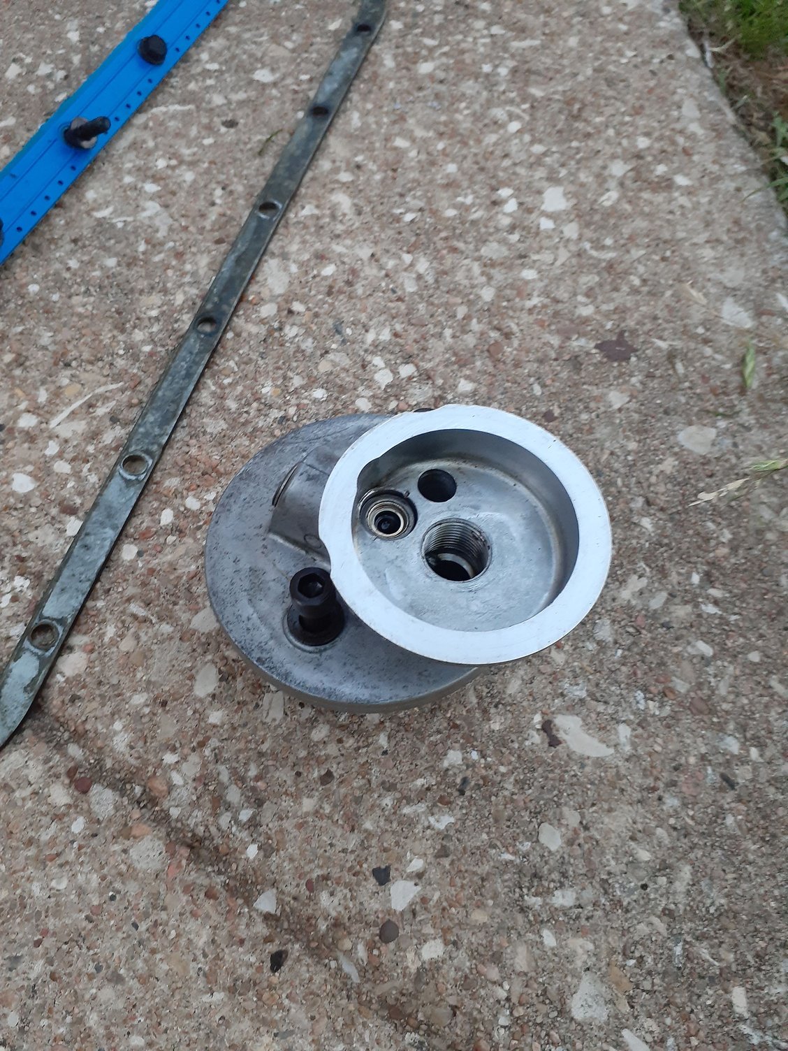

Removed oil pump today and broke it apart and cleaned her up.
Next is putting everything back together later this week.

I just dealt with that connector the other day. Terrible design.
