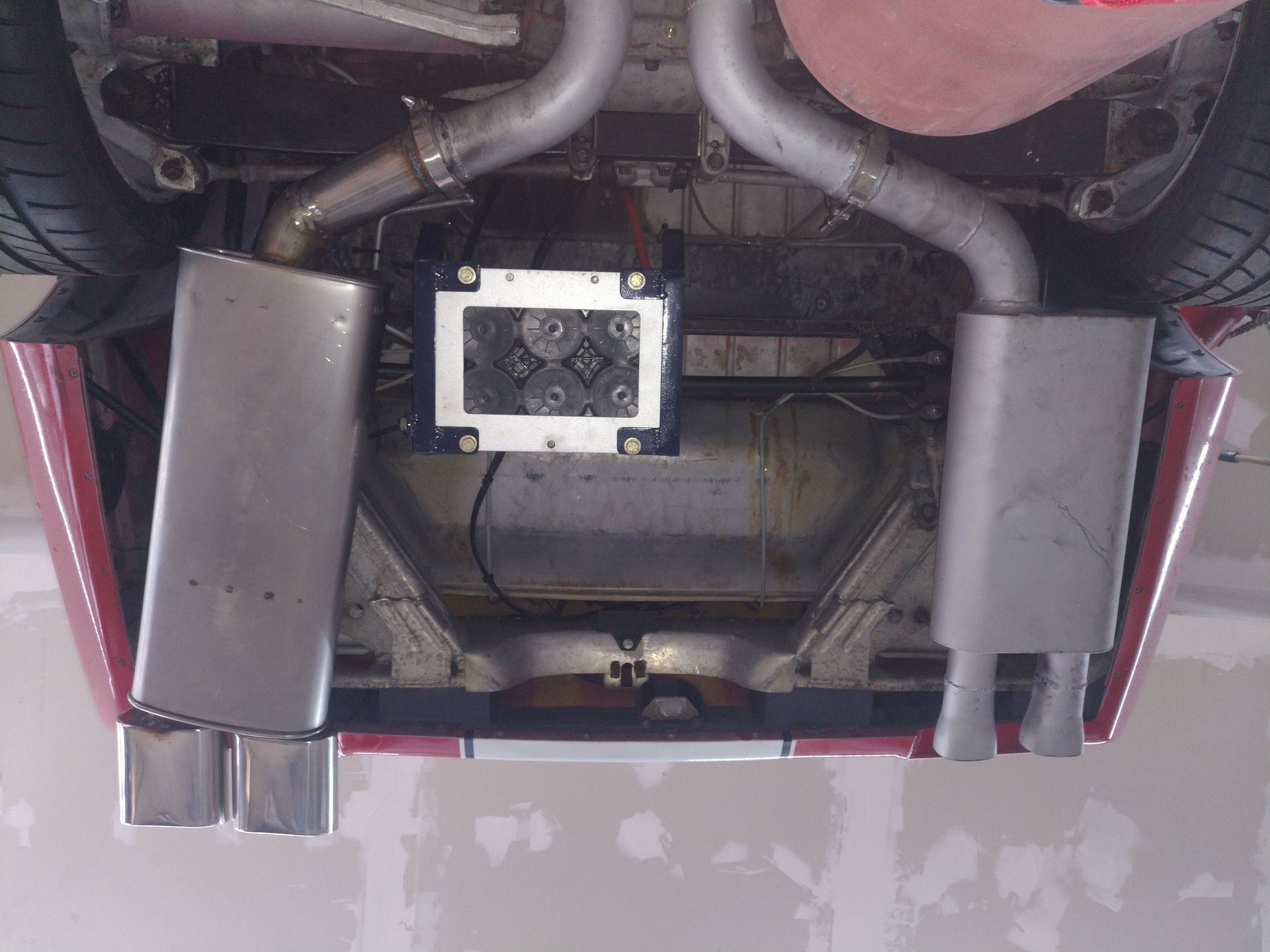

So doing some research I found the Walker Quite Flow SS line with some good reviews. So I have installed a pair and have gone for my first drive and really like them. Model 22719. They are longer than the Flowmasters and take some creative fitting to make them work. I had to put them crooked to make them clear the tires. The pipes were cut of flush so elbow's could be fabricated directly to them. Same for the Tail Pipes.

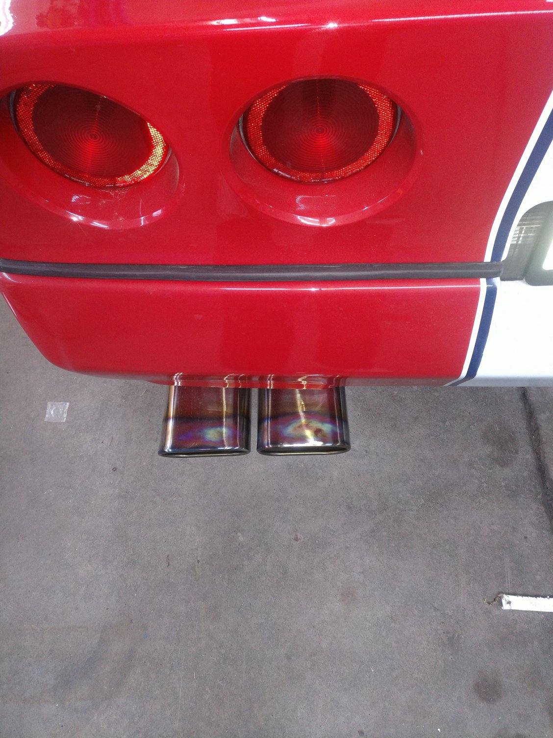

The Tail Pipes are some cheapos I got from eBay. The Walker 22719 is a production Muffler and not the same finish you would expect from one of the name brand aftermarket brands. They are inexpensive at less than $100 each from Summit. The Tail Pipes were $25 each. Anytime you are running a 3" exhaust it's not going to be quite. But these are much more bearable on a highway you might be able to talk or even listen to a Radio again. They have a nice low rumble at idle and good when your on it.

Despite the Tailpipes being welded up tight to the mufflers they still stick out further than I like and I might cut them 3" shorter.

This picture might give a better idea of the size difference. Weight wise however is not much.
