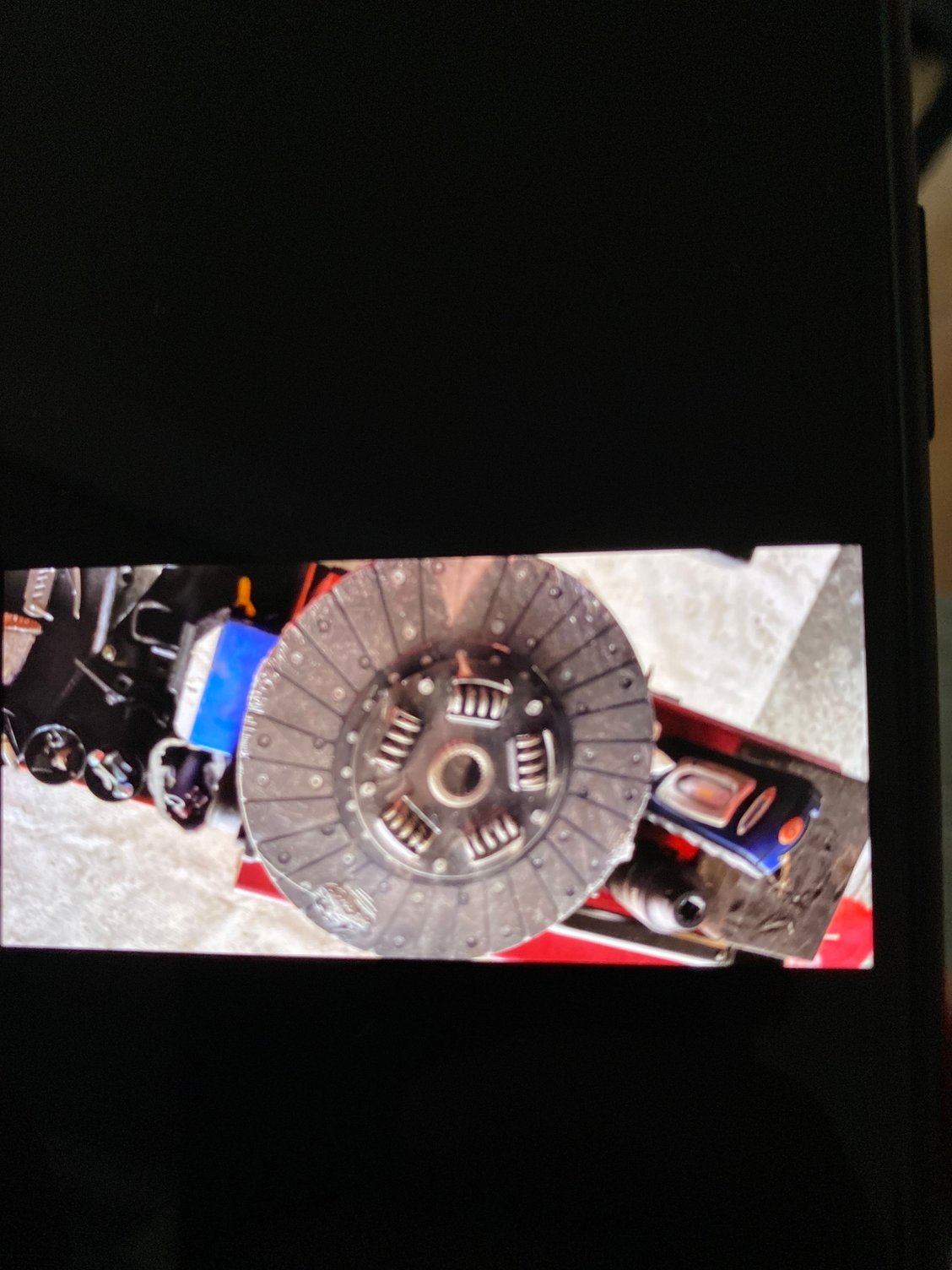

Did you use a new clutch disc with a sprung center hub when you converted? If not, the noise will be noticeably worse.
yes, a clutch with springs is installed...
