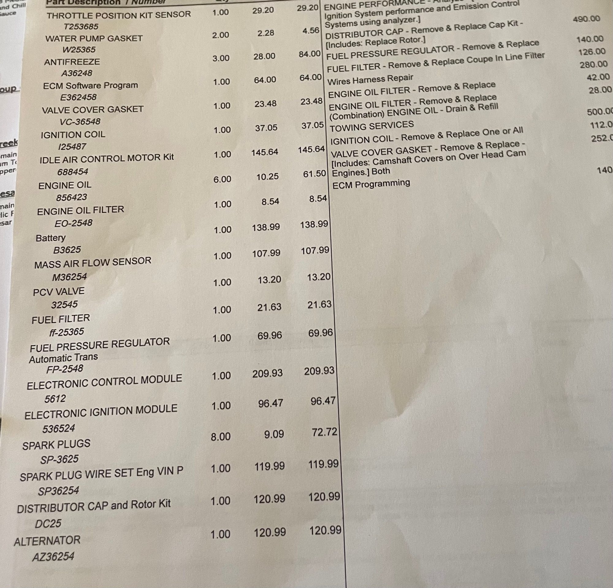

Hey guys so i got a quick question i have a 1996 C4 Corvette LT1
Its got a bunch of new things everything within ignition and sparks and such have been replaced i was chasing a rough-ish idle for about 5 months and $8000 later including a new trans and torq converter she still has a kinda shaken idle nothing crazy!
I was really thinking then i thought omg what if it was just motor mounts but my main question is i know it’s a basically 30 year old engine do most have a shake at idle?

Hey man yeah i’m in Naples Florida actually if you wanna shoot me a message i would love for someone to maybe look at it like i said the car was in the shop for 5 months
New Ecm
new ICM
new fuel pump
new fuel filter
new fuel injectors
and a bunch more
but if you can shoot me a dm id love to have you look at it

Will send a PM !!…5 months in a shop and all those parts ??…if it was a general repair shop or a dealership they just replace parts until they get lucky…99.99% of them don’t know how to diagnose unfortunately….would like to know what the other “bunch” was…LOL !!

This doesn’t include the rebuilt trans and new upgraded torq converter

HOLY CRAP !!…well this is what happens when shops don’t know how to diagnose...they just guess !!…I don’t care what was changed so I don’t base my diagnosis on that…I’d be looking for a EGR valve that may be stuck open or partially open giving you a rough idle and the car runs better above idle…saw in a previous post you had some starting issues…classic stuck open EGR…I’d be looking for elevated fuel trims and lower engine vacuum…also the solenoid is duty cycle controlled so I’ll be looking at that too.

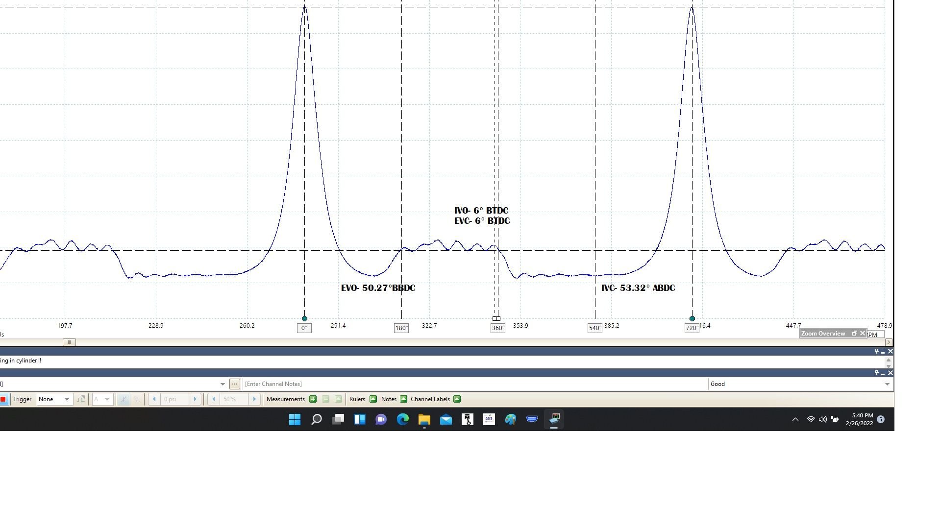

OP is bringing his car by this weekend….I do a relative compression on EVERY car I look at and everything will be checked and a 100% diagnosis’ guaranteed…LOL !!

Doing a relative compression on every car is always part of my “diagnostic process”…I also do a starting and charging system check too…don’t even have to open the hood for the relative compression…do it right from the drivers seat…thermo gun for me isn’t the best way to check for a clogged cat…I’ll either remove a spark plug on each bank and do an incylinder pressure analysis (below pic) on each side or remove the upstream O2 sensors and hook up a pressure gauge.
