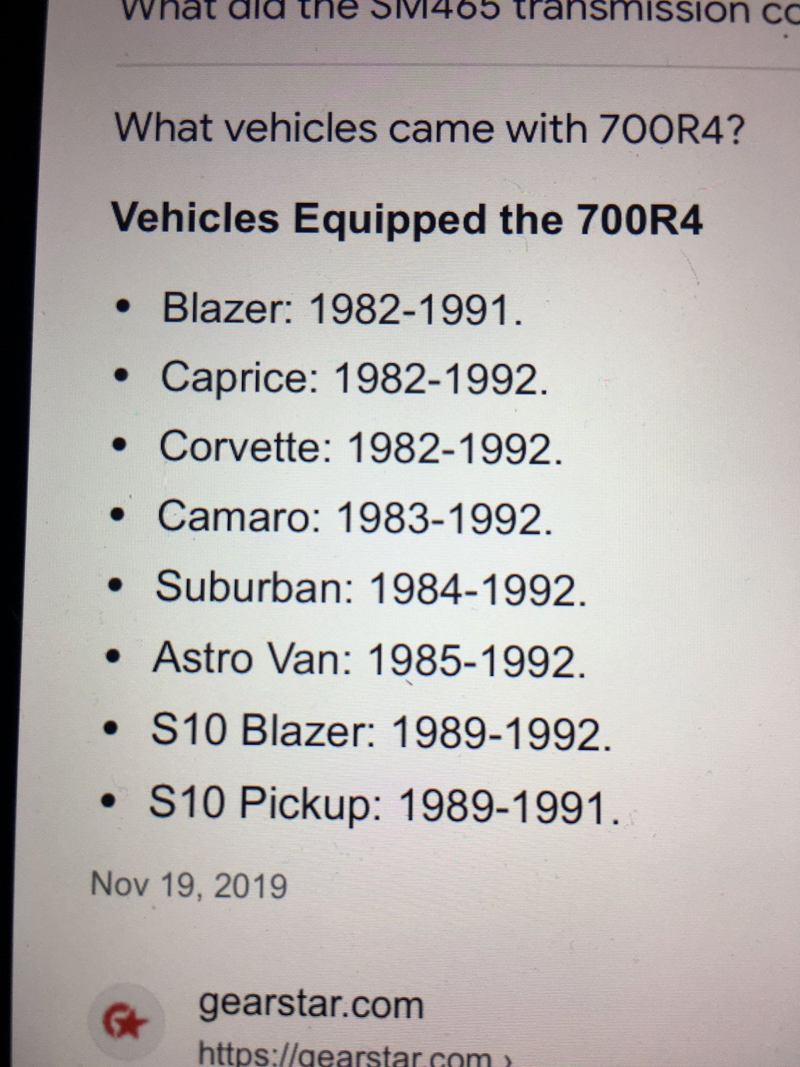

Does your 84 have the 700r4 trans? That trans also came in other GM cars that had the quadrajet carb. I bet cables from one of those might work. Look at the Caprice and Camaros in the years on this list

Get the brackets that mount to the intake off these cars too. Even if they don’t direct bolt on, you can usually modify and make them work
