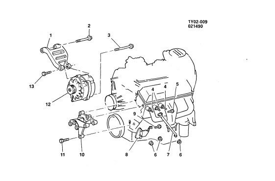

Hello - Anyone know the size of the top bolt for the alternator? The one that connects the Alternator to the motor. It is stamped 9.8 but I don't know how many MM it is.

The top bolt that it pivots on through the bracket OR the support rod on the back side of the alternator?
Which # in this illustration?

It is #13

M8 x 1.25 - 45
