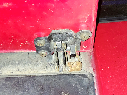

May 4, 2023 | 01:21 PM
So, today I did some more checking. My hatch striker looks pretty good (compared to some of the other photos I've seen:
The latch attachment nuts were also secure, no play. So I'm pretty much back to square one. I guess I'll replace the stabilizer link bushings, since I have them and the currently installed ones are original.

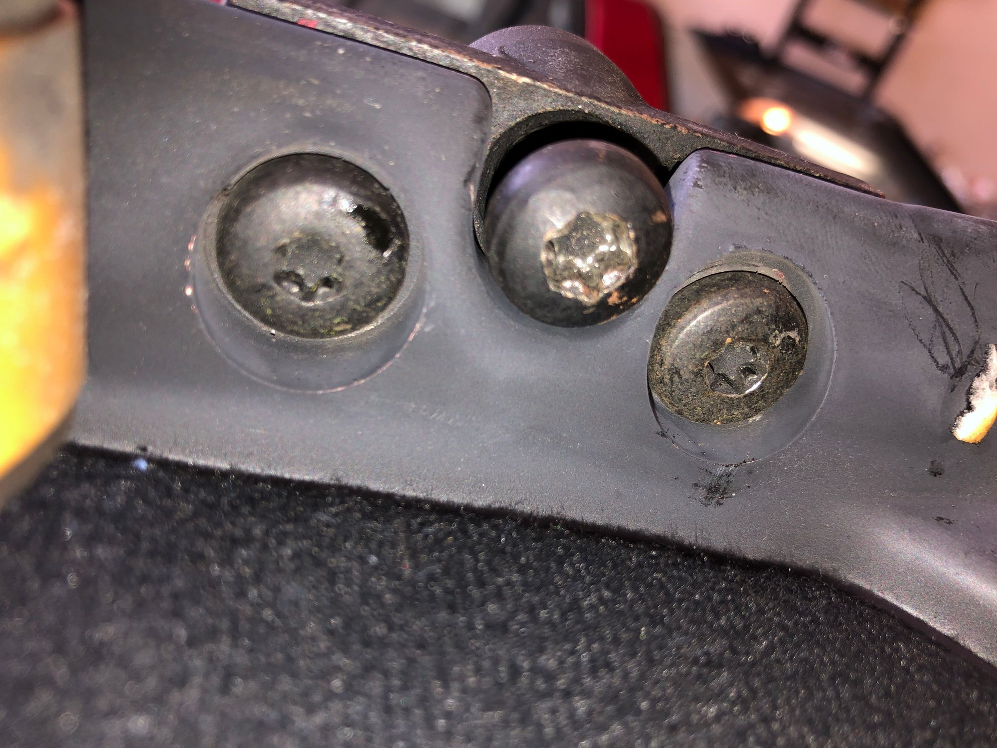

May 30, 2023 | 05:40 PM
Quote: Go over your roof hardware and mounting points
So, I had checked the 4 roof attach bolts and they were tight. Today, I removed the roof to check the rest of the hardware. Turned out that both of the rear roof panel locator brackets were loose:
About one turn with a Torx T-30 tightened them up. While I had the roof panel off (a rare occurrence for me), I treated all of the weatherstrip with Sil-Glyde. Test drive over many bumps didn't produce the previous clunking noise. So, no new stabilizer link bushings for me...
