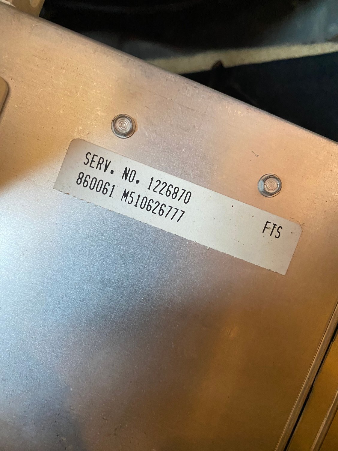

I have an 85 C4. Great car. It’s been a pain since day one. Got it from a kid.. he spun a rod. Lots of work later. I’ve rebuilt the original block but it’s now a 383. Slightly bigger injectors.. nice heads. Etc. Car sounds and runs well. Except one thing… code 33.
so. I’ve wired a new plug in. Checked my ground. replaced my burn off module and still.. code 33. MAF seems fine. Could it be my ECU?? Car runs okay till it hits a closed loop and then it’s just awful. Spudders. Runs up in rpm and then drops. Smells rich. Just can’t seem to figure out this code. Any Ideas??
im attaching a photo of my ECU numbers. If I go for a replacement is there a difference between a manual or auto ECU?
