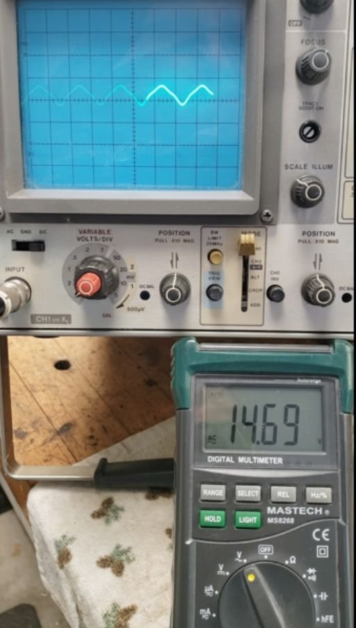

The I tested the replacement under the same conditions and this was the result:
The new one had a a waveform and the output voltage was 14.69 VAC. BIG DIFFERENCE.
So the new VSS went into the car with a fresh fluid change for the transmission and I now have my speedometer back!
