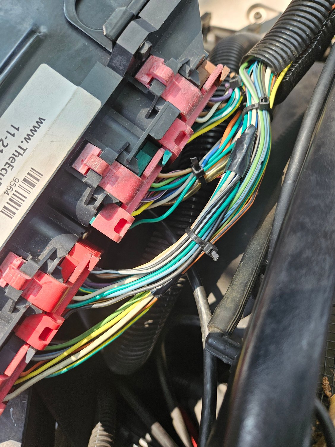

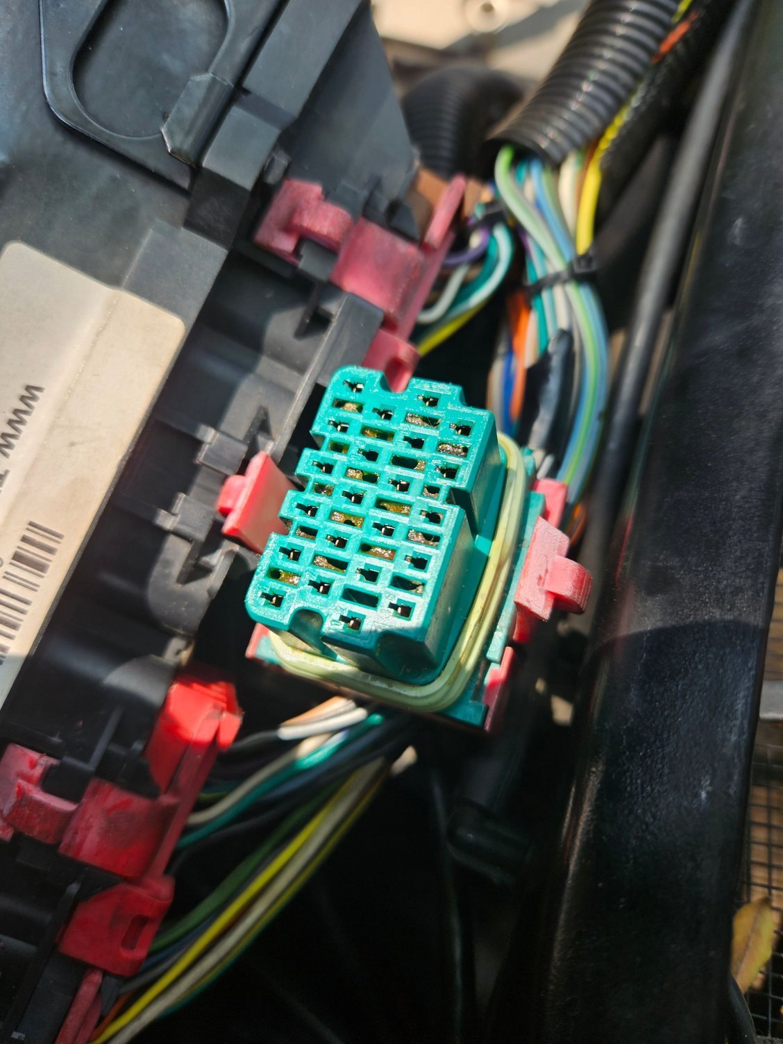

OK so sorry for the really late update. I'm checking the connectors for the ecm and they look good. Weird thing is when I put the cover it starts flashing the lights. I can't seem to find anything wrong
Those are some of them but they all look the same. Unless that goo inside has anything to do with it.
