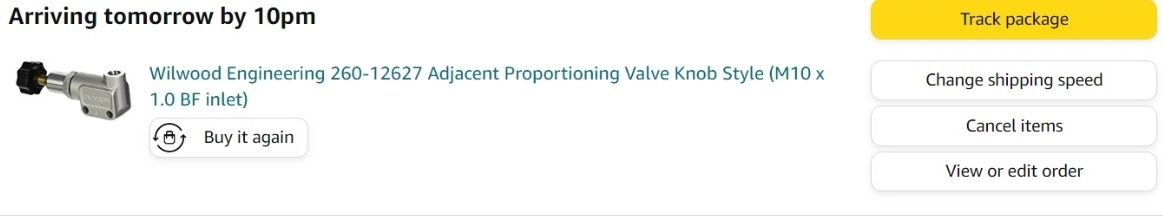

My 87 certainly did (ABS pump), I ended up installing a proportioning valve and removing the ABS pump. Pulling the fuse keeps the ABS light from showing in the drivers information panel and disables the ABS system. I tried to open the pump to clean it myself but could not, few have ever had luck cleaning them, they get clogged badly from old fluid. There are 2 repair facilities that are EXPENSIVE, like $1300 bucks expensive. I had to order short brake lines to bypass the ABS pump behind the drivers seat. Open the compartment in the floor and look under the tray. It is imperative you spend time adjusting it correctly if you install this. In the rain especially, too much rear brake and you spin, too little and you (lock up) slide the nose. The only reason I felt comfortable doing this is it is one of the first few iterations of chevrolet ABS, it is only 3 channel , the rears are tied together. My 87 uses I.S.O. also called bubble flare brake lines (not double).

"" Pressure adjustments range from 150-1200 PSI and provide for a maximum decrease of 57% in line pressure, the most of any available valve. Adjuster **** with fine thread tuning provides precise pressure adjustment. This adjustment lets you fine tune the front to rear braking balance by proportionally decreasing the rear brake line pressure.""
