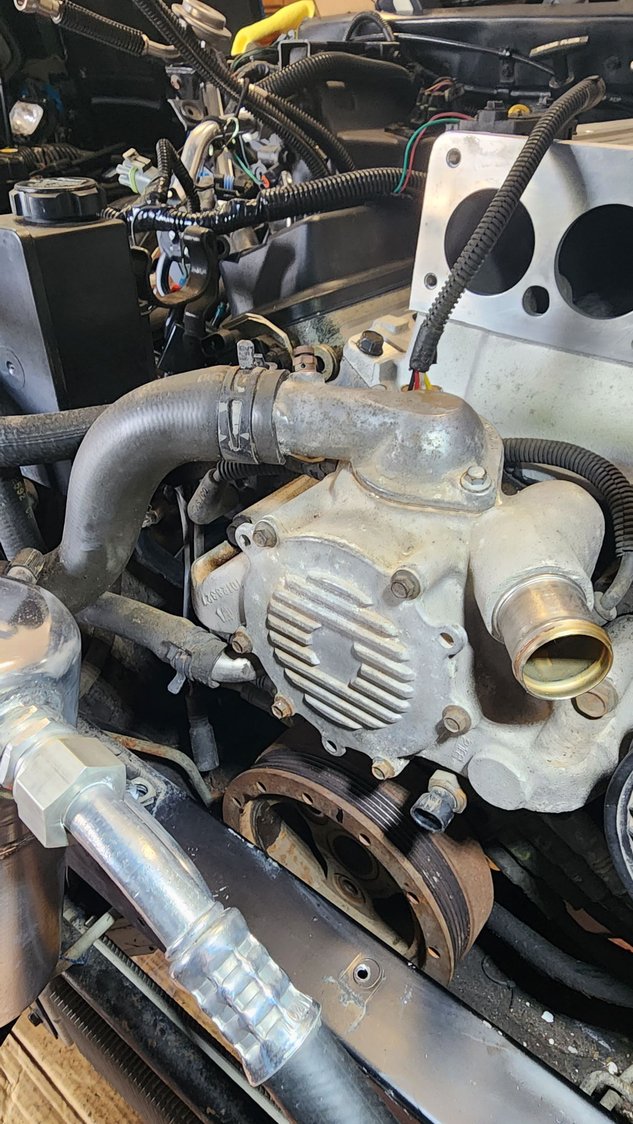

Before you pulled your balancer, did you just put the /\ at 12'oo? I haven't pulled mine off yet. I guess I could pull the number one plug and see if the piston is up.
I think all i need to do is get the mark at 12 and when I pull the hub, orientate it at the same position.
Mark
Balancer at 12
At 12. Will pull pump and then balancer, then hub.
