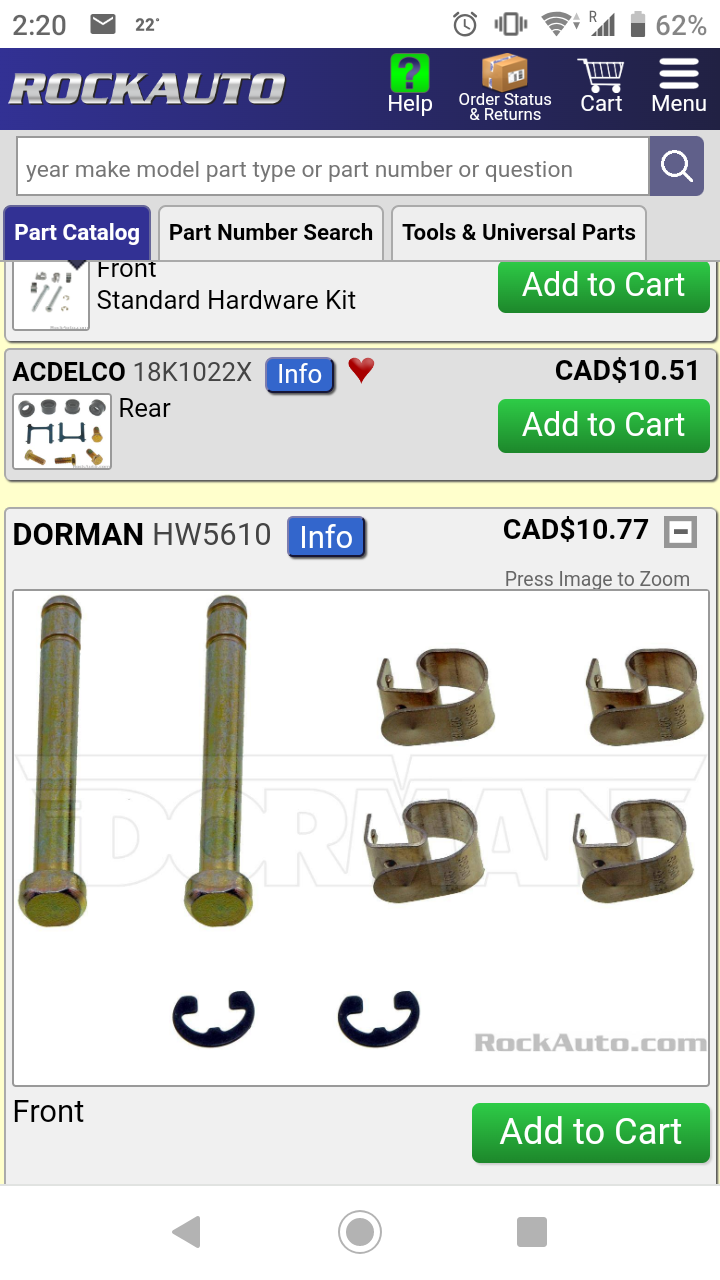

I think 2011KLR has the answer. The little "S" shaped anti-rattle clips that slip on the pads sometimes break off or more likely, the installer neglected to put them on. They usually come with the replacement pads. I haven't looked for them in over twenty years but maybe they are available in the aftermarket.

As stated, most likely the anti-rattle clips are missing. They are often included with a caliper pin kit.

I have a pair of extras. If you find you need em let me know.
