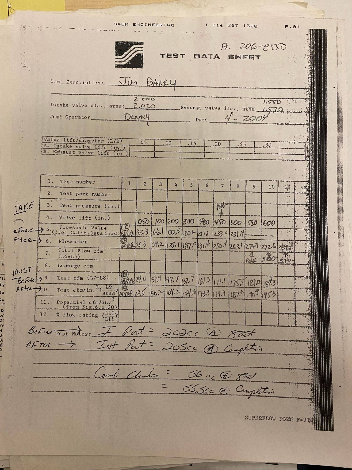

Welp, looks like I bumped into a "Problem" again.
After driving many many hours to go pick this engine up, under the assumption it was a 383, I dropped the pan when it got it home and discovered that it has a 14088532 crank in it. Doing some research on this, its an stock replacement for a 350ci, albeit stronger than original stock. Needless to say I was disappointed. A quick phone call to the seller leads me to believe that the person who originally sold it to him blew smoke up his *** and made him believe it was something it wasn't. I could hear he was upset with my findings and offered to take motor back if I desired, I declined. What i actually purchased looks to be a built 355ci with many many supporting mods.
Below is a list of things I have verified with my own eyes.
- LTCC opti kit
- Stock LT4 heads that have been ported and polished. (unless AFR heads from around 2004ish don't come with markings on the outside) these have 22224 stamped on them
- Stock LT4 ported intake
- JE 4.030 pistons
- Lunati rods
- 14088532 Crank
- Eletcric Water pump
- Tpis AC eliminator bracket
- Canton oil pan
- ARH long tube headers
- Spec Stage 3 clutch
- Spec solid Alum Fly wheel
- Holly 58mm TB
Things I still need to check
- What Comp Cam is in it ( the receipts have a few choices and i need to confirm but I'm leaning towards it being custom ground, I have a Cam serial number I can look up) Some of the specs are listed in an above pic.
Spoke with Comp Cams and ran the serial number listed above. I need to pull the timing cover to confirm, but this seems like decently large Cam for a street car. When tested by comp it made 402chp on a 355.
- What lifters/springs are in it
- What Injectors are in it
- What valves are in it
- Tune
All things said and done, this still feels like a decent buy for the price I paid ($2900). If i manage to verify what's in it and give it a good clean and once over it'll still be a decent motor. Anything else I should look for when i going through this?
Also, anyone care to speculate on the numbers a motor like this could produce? I have a dyno sheet posted above, but now I'm not sure if its crank or wheel HP or if its even real anymore.
Thanks for reading.
-Brick

Cam specs,
I called Comp yesterday and confirmed this cam was made and sold to the original builder. From what the guy at comp told me this is a "big" cam for a 355.
Intake/Exhaust
283/289
.569/.577
112 lsa
4° of advance
I need to find the piston dish/dome cc for these JE pistons that are installed, but if i leave it at 6 for the time being I get a compression of 11.3:1

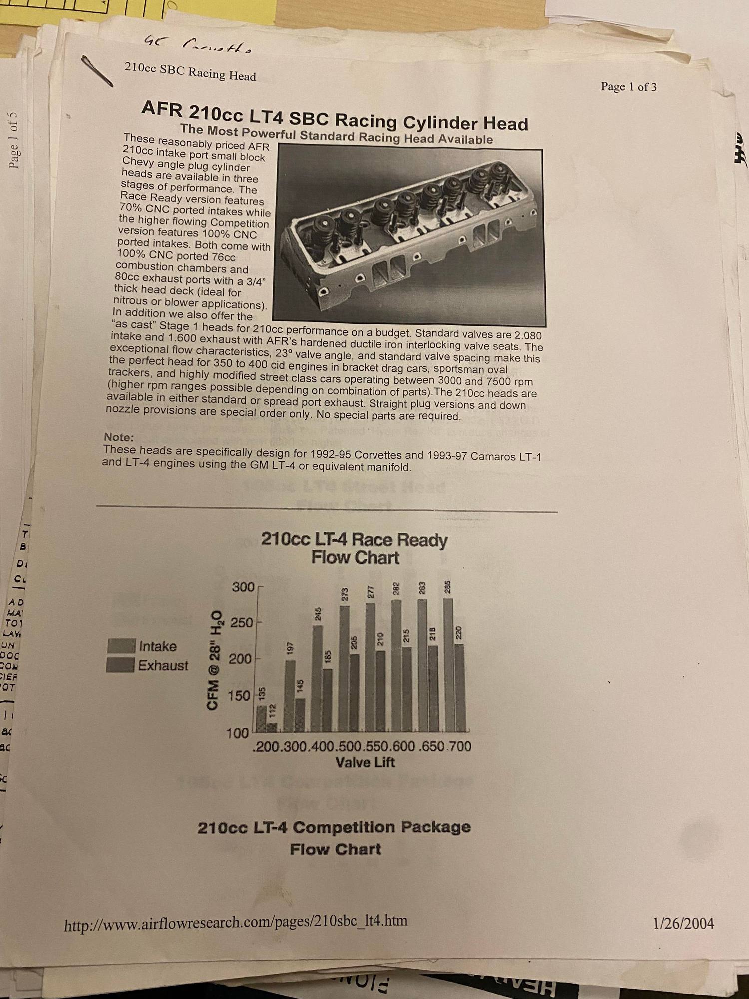

If the heads flow around 300, I am guessing the dyno graph is to the wheels.
Old Dec 6, 2023 | 06:19 PM
  #33
Brick330's Avatar
Brick330
Joined: Apr 2022
Posts: 109
Likes: 28
From: Massachusetts
even with it being a 355? Also looking at the flow chart it's seems to be 275/190 at pea, but who knows.
Old Dec 8, 2023 | 10:29 AM
  #34
95wht6spd's Avatar
95wht6spd
Joined: Jul 2000
Posts: 7,639
Likes: 326
From: Greenville SC
Info is confusing, so difficult to add up I think it could do that if everything is matched very well, and 300cfm, it's a big cam,...but I would think it would need to spin higher, around 6800.
My LE2 H/C setup with 280cfm heads, stock short block, made 402/360 wheel, but it was 6500+ rpm. Mine drives great with a 230/230 cam 106lsa.
You got good parts for the $, at worst, maybe have to change the cam to match the heads better, or for better drivability.
Or swap the short block now for a 383, and sell the 355 if you want more torque.
