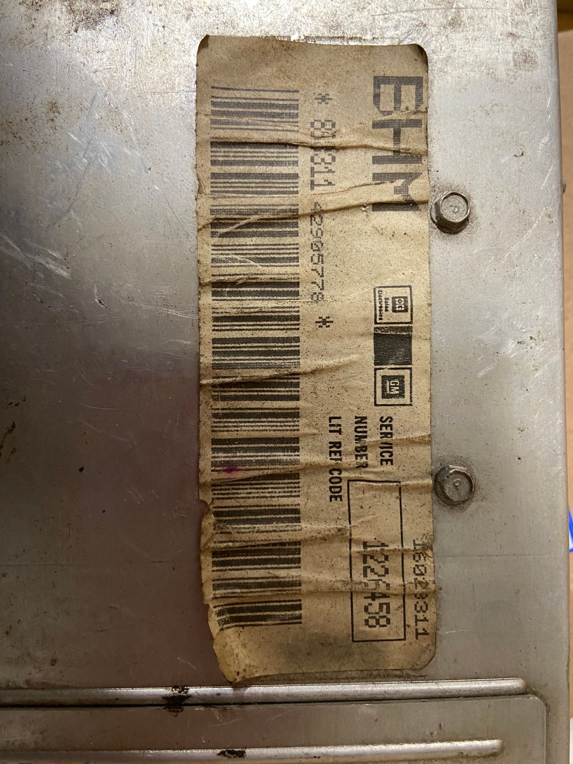

Hello.
I have an 84 with auto. No check engine light but a code 42. I picked up an ECM at a swap meet for cheap. What number on the ECM will tell me what it will fit? The service number says 84 Corvette but I’m not sure of the other numbers. THANKS.

1226026 should be the number for 84 Corvette. Googling the number you show, it says for Buick, Cadillac.

The BHM and the 16028311 seems to indicate it was OE to an '84 'J body GM'. The service number would fir several GM likely BUT an 84 Corvette isn't one of them. '84 Corvette I believe the service number would be different for an AT and a MT 4+3 car. That one you picked up won't do squat for your car.
