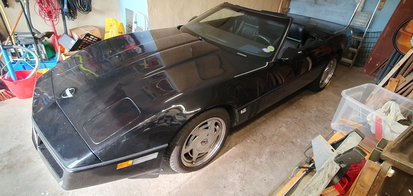

Vettis, I just want to point out that if your profile picture of your car is up to date, the front tires/rims are on the wrong side of the car. The back ones look to be right from what I can see but the front ones need to go on the opposite side they are in the picture. Enjoy your great ride !!

You might want to check and see if you also have directional tires. You need to be sure once the rims are going in the right direction that the tires are also turning in the right direction.

Thanks my friends! I must check it now and mount them right! I don't think of that before. WBR (With Best Regards) Laszlo

Hi All! Yes I 'v checked it and the directional tires is correct mounted. On booth side. Thanks for your attention! WBR Laszlo

Yes! You are right! The tires are correct mounted, but the rims are changed. Left rims on the right side and vs. Wrong directions of the spokes. I made an appointment with a tire company (my mecanic). A big thanks All for your attention! WBR Laszlo

Done.
Correct hood-logo and rimes/tires
Thx All! WBR Laszlo
