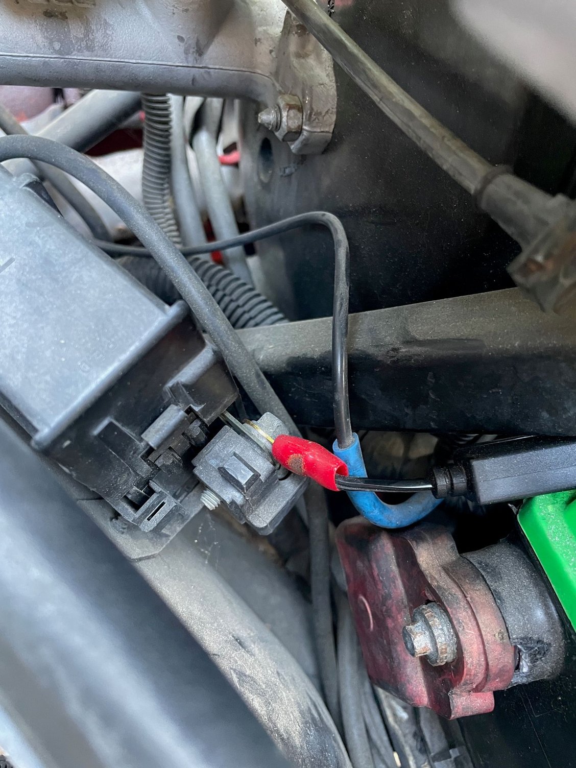

Positive to fuse block terminal…negative to chassis bolt middle top of pic.

My solution worked “just fine” but I like that idea for a more discreet install and as you say “owning” the spot and hiding it in the fuse block itself. Remember battery tenders are NOT putting out a lot of amps so don’t have to go overboard. A friend of mine just uses the cigarette lighter adapter version for his Porsche…
Also what can’t be seen is the charger lead attached there has a fuse in it…this should be present for any permanent charge lead install.

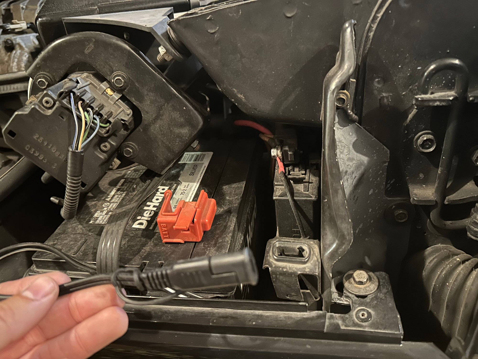

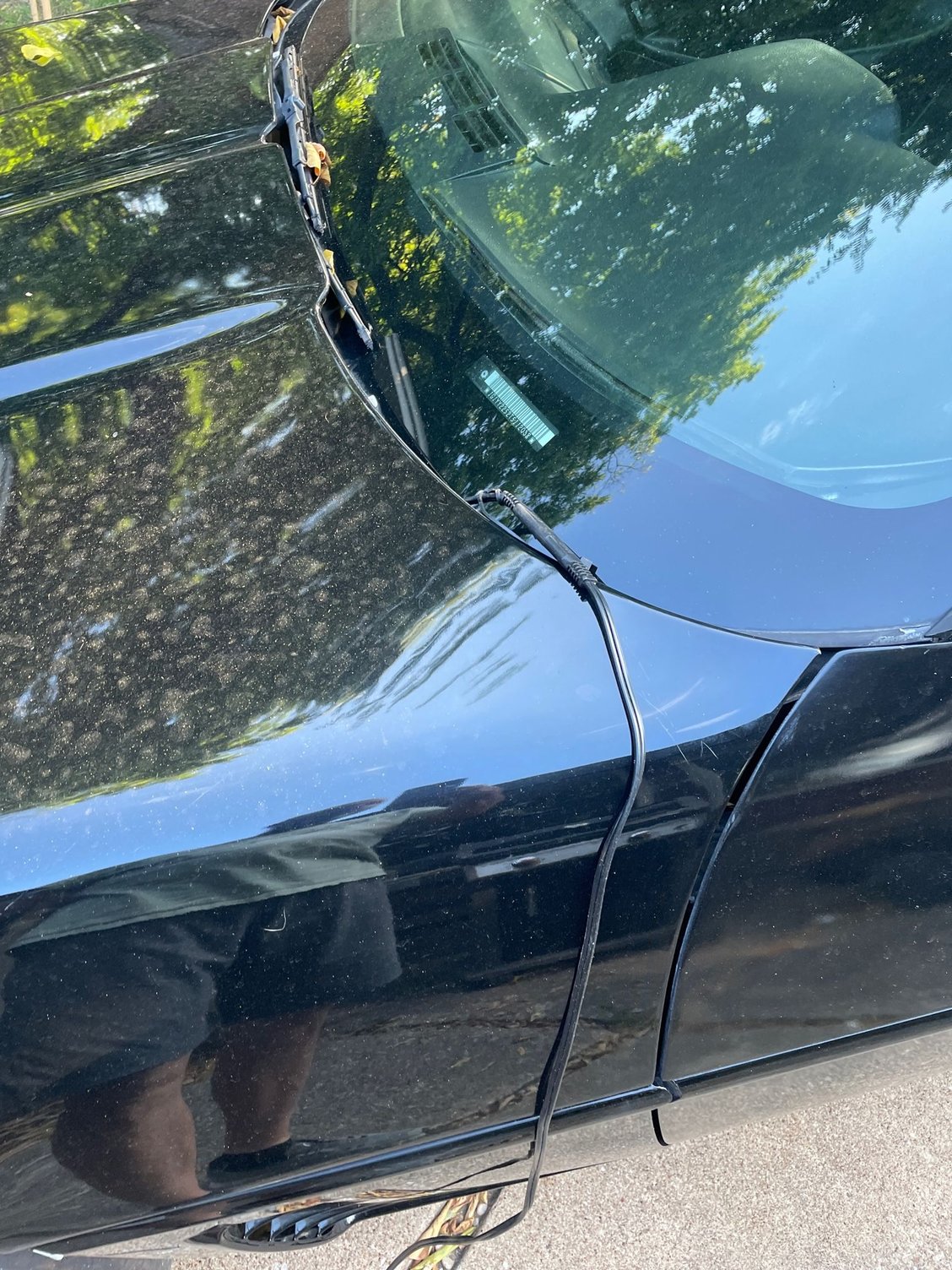

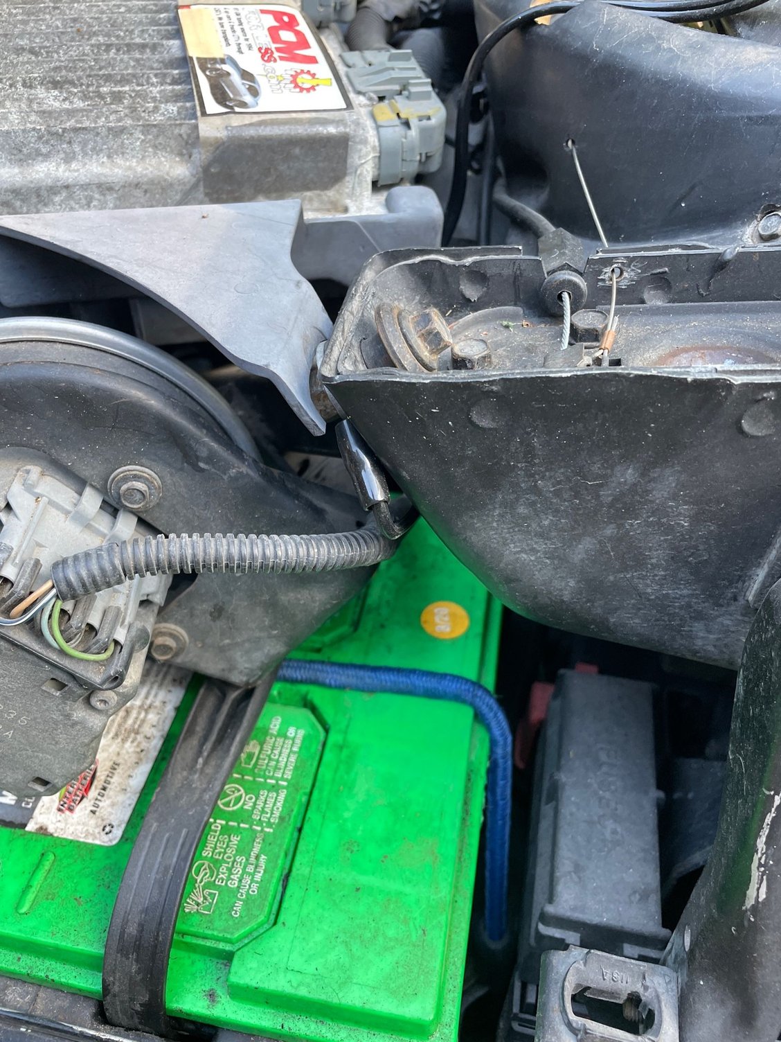

I ran into the same issue with the terminals not fitting the side mount battery screws. I set mine up on my 96 using the positive post on the block right next to the battery and then grounded the black on a frame support bar. My plug hangs out just under the hood by the windshield wiper. Works good.
The scratches on the hood were not caused by the tender. The neighbors cat did that. At least I think it was him...he loves my car. Doesnt hang out on any of our other cars. Only paw prints on the corvette. Can't fault him for that... Hahahahaha!
