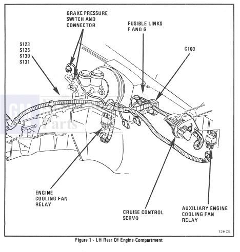

The photo I've added refers to locations in early C4's. Try doing the same test on it that you did on the auxiliary fan relay.

Thanks, I’ll try that. I found the main fan wasn’t running because the car was heating well over 250F and when I popped the hood the main fan wasn’t turning. Once it cooled down, the next day, I did this test.
