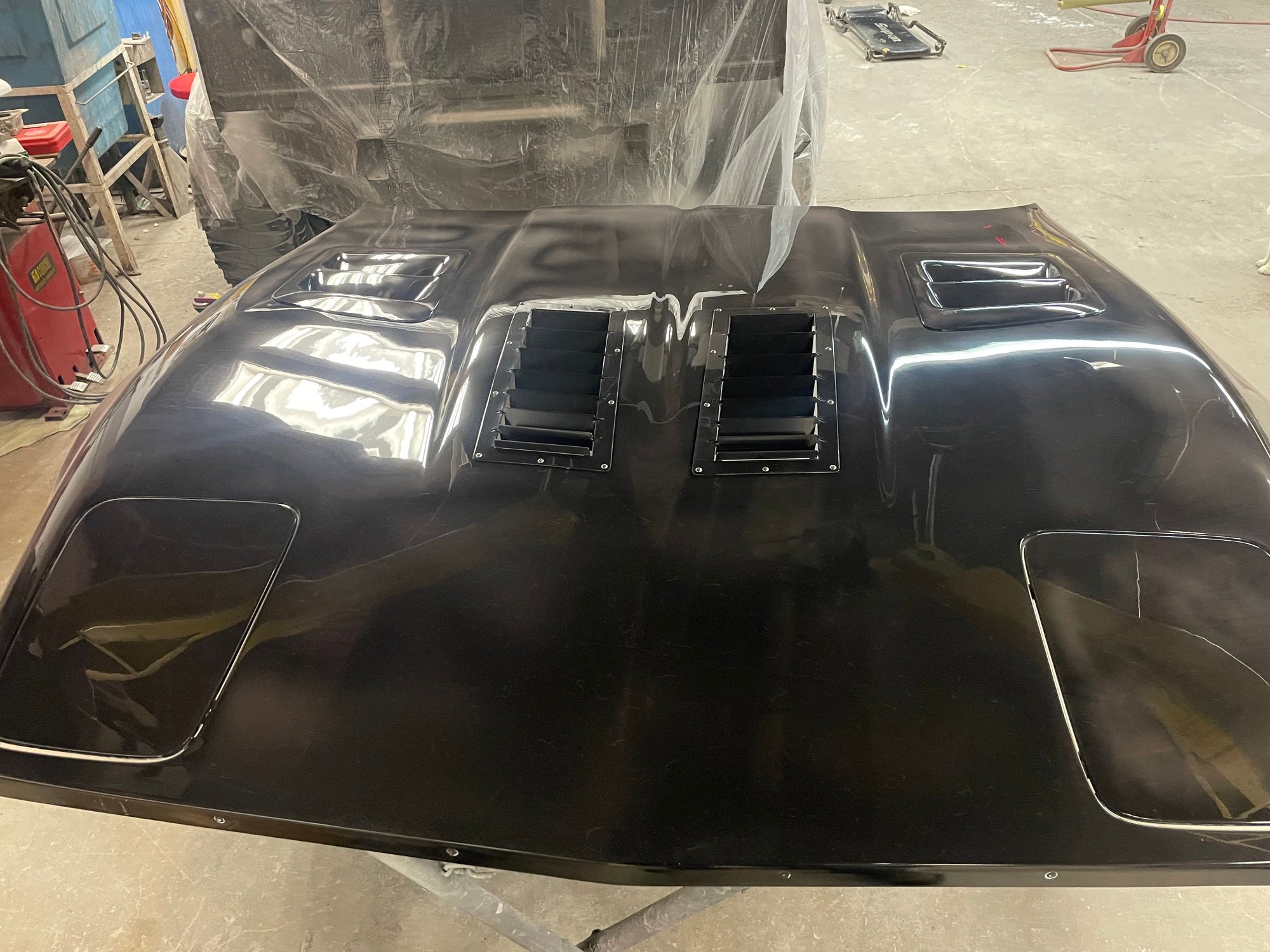

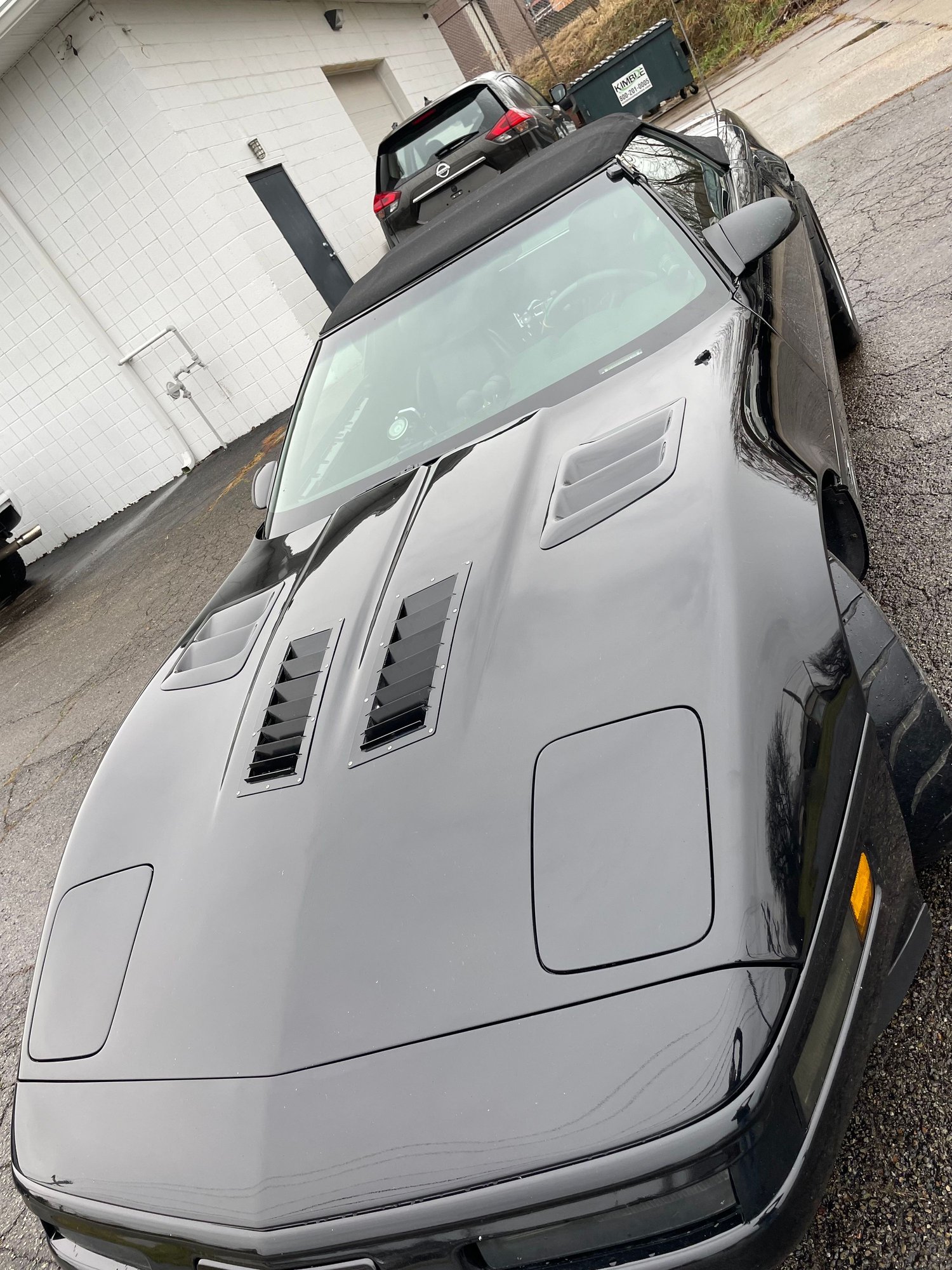

Old Dec 22, 2023 | 12:55 PM
dizwiz24's Avatar
dizwiz24
Joined: Sep 2001
Posts: 14,682
Likes: 753
From: NEwhere Ohio
This body shop has taken 4 months longer than expected
But here is the finished product
more pictures to come when i install it tomorrow
Note that those headight lids are boltable.
so i can ditch the pop-ups for more weight savings when i need to
Old Dec 22, 2023 | 05:52 PM
383vett's Avatar
383vett
Joined: Apr 2003
Posts: 17,700
Likes: 1,667
From: moraga ca
I liked the hood 3 pictures up before the jigsaw.
Old Dec 22, 2023 | 06:36 PM
dizwiz24's Avatar
dizwiz24
Joined: Sep 2001
Posts: 14,682
Likes: 753
From: NEwhere Ohio
with boost, i’ll be running an intercooler takimg air in thru the front license plate area and exhausting it underneath the hood.
so the air needs a place to go out
il may even need to put even bigger hood vents in at some point
the intercooler i have in mind is rectangular and can fit in the nose area if i cut out plastic webbing
i may also do body work to ‘widen’ the license plate gap on the front fascia
my biggest gripe is that i didnt have a higher rise hood option for this carbon fiber part.
At one time, Exotic Muscle did have a higher rise ligbtweight carbon fiber street hood option, but the molds for it got accidently destroyed somehow.
there is a plan for all of this
