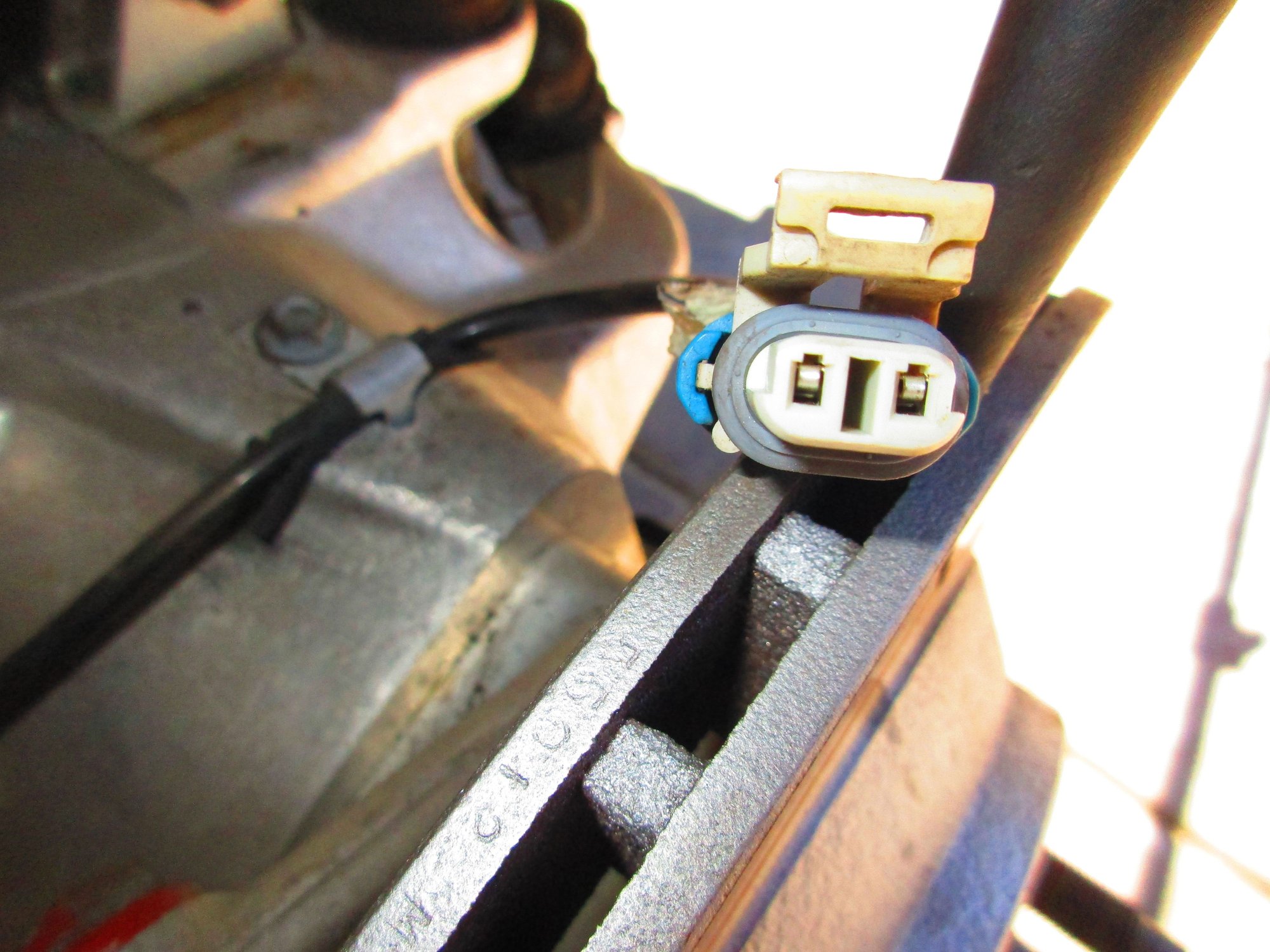

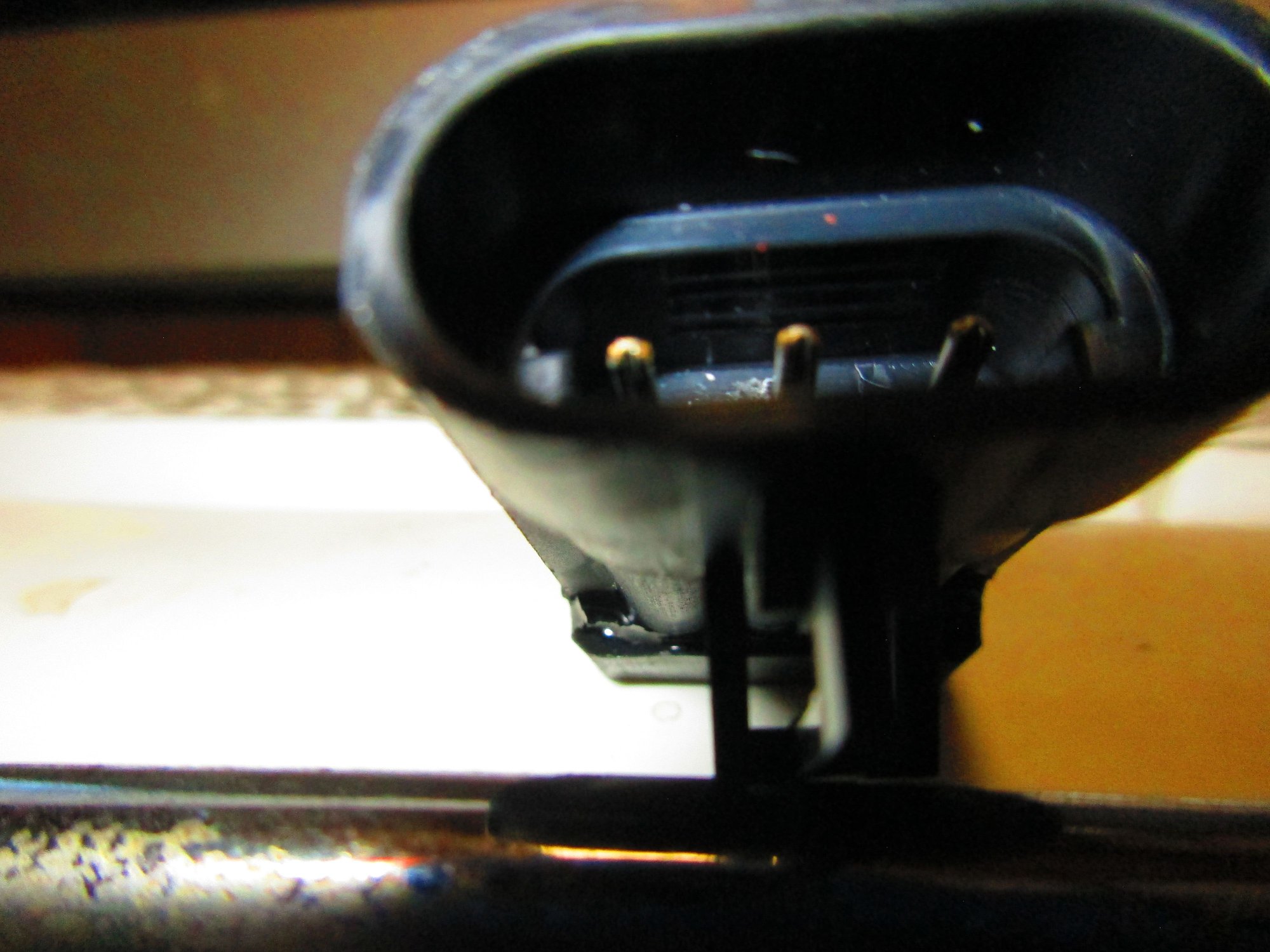

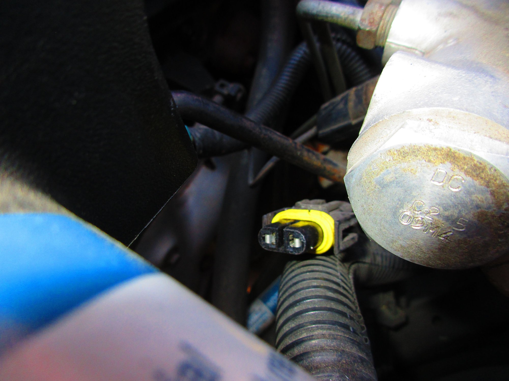

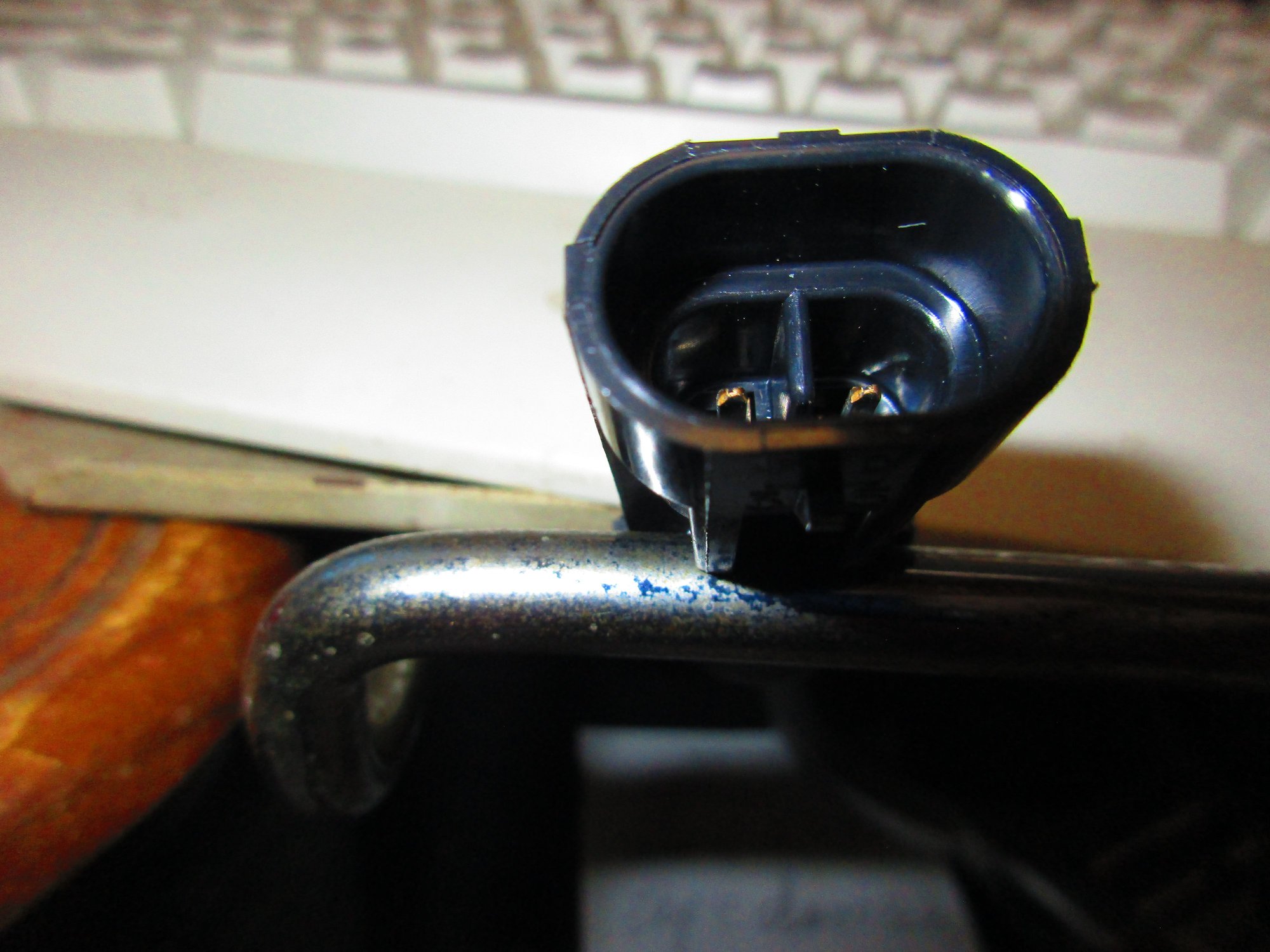

I’m having a problem understanding the suspension system on my 1996 C4 base. I was operating with the understanding that I had an F45 real-time damping system based on the year of my car.
So when I supplied the information to the vendor, these are the simulators that I received (pictured as “ordered”). Which I returned at a later date.
However, here are the connectors on my vehicle(pictured here that are marked as “Car connects”). So my question is could I possibly have an F30 of my 1996 C4 Corvette? Or did I simply receive the wrong shock simulators?

Is your question regarding 'identification' the 'last' snapshot you've included in your post?

1996 does not need the simulators. Just pull the fuse for the RTD system in the ABS compartment.
