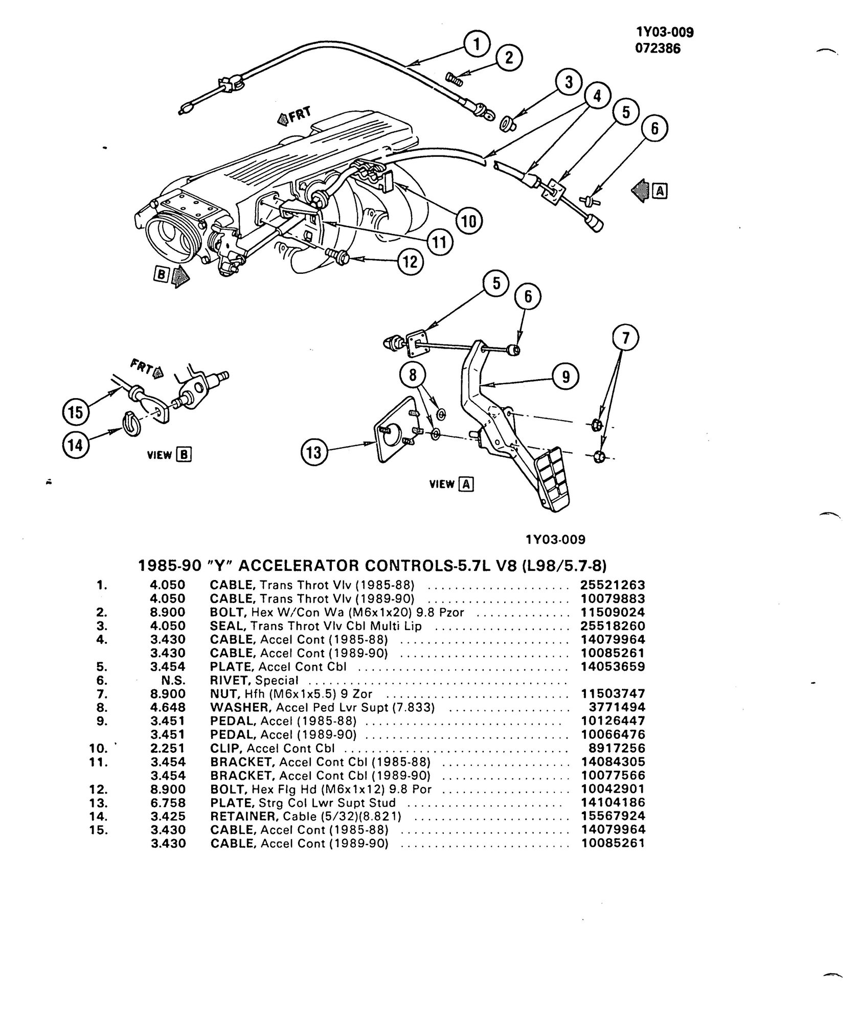

Am i missing a piece that mounts to the plenum where
the throttle cable mounts

I think i found the correct bracket mt looking at L98
engine pics. Another question is the bracket different
between the automatic and manual trans?

'85 - '91 Accelerator Linkage. Bracket is the same for AT and MT but different '85 - '88 and '89+
