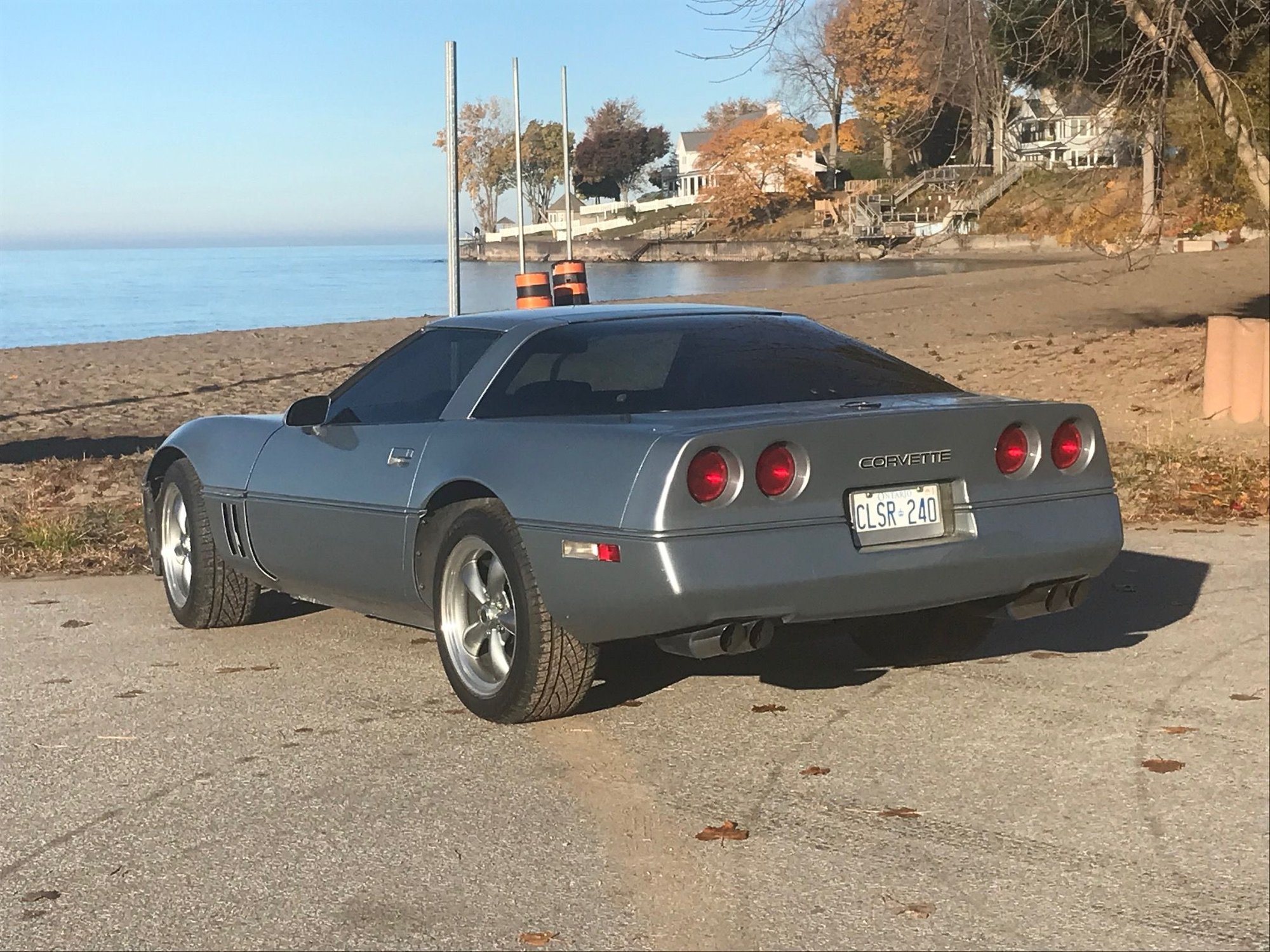

Default Full Throttle Vibration
In my 85 Z-51 4+3, I did a 500 mile trip yesterday and today. There's less than 100k miles on this car, and it has 17" American Racing mags with Continental Extreme Contact tires, one year old. I'm in Canada, and drove mostly on the highway, doing 79 MPH almost all the way. Just under radar trap speed. Damn, the car felt so good, drove great, and it was even getting great fuel mileage. Nice and smooth, and good acceleration, except... Under full throttle acceleration in second and third, I noticed a hard shake that seems to come from the chassis. Not a front end shake, and it felt good when driving at almost 80. It's the hard acceleration that makes it shake. I've changed all fluids this year, including putting Lucas Synthetic 75W90 oil in the transmission and differential. The transmission has never shifted so well, and the limited slip rear end functions perfectly.
The OD unit got a new filter and Dexron 2 and works great. I know it's no BMW, and there is some degree of vibration but this is much more than that. I'm wondering about half-shaft u-joints? Any ideas?
