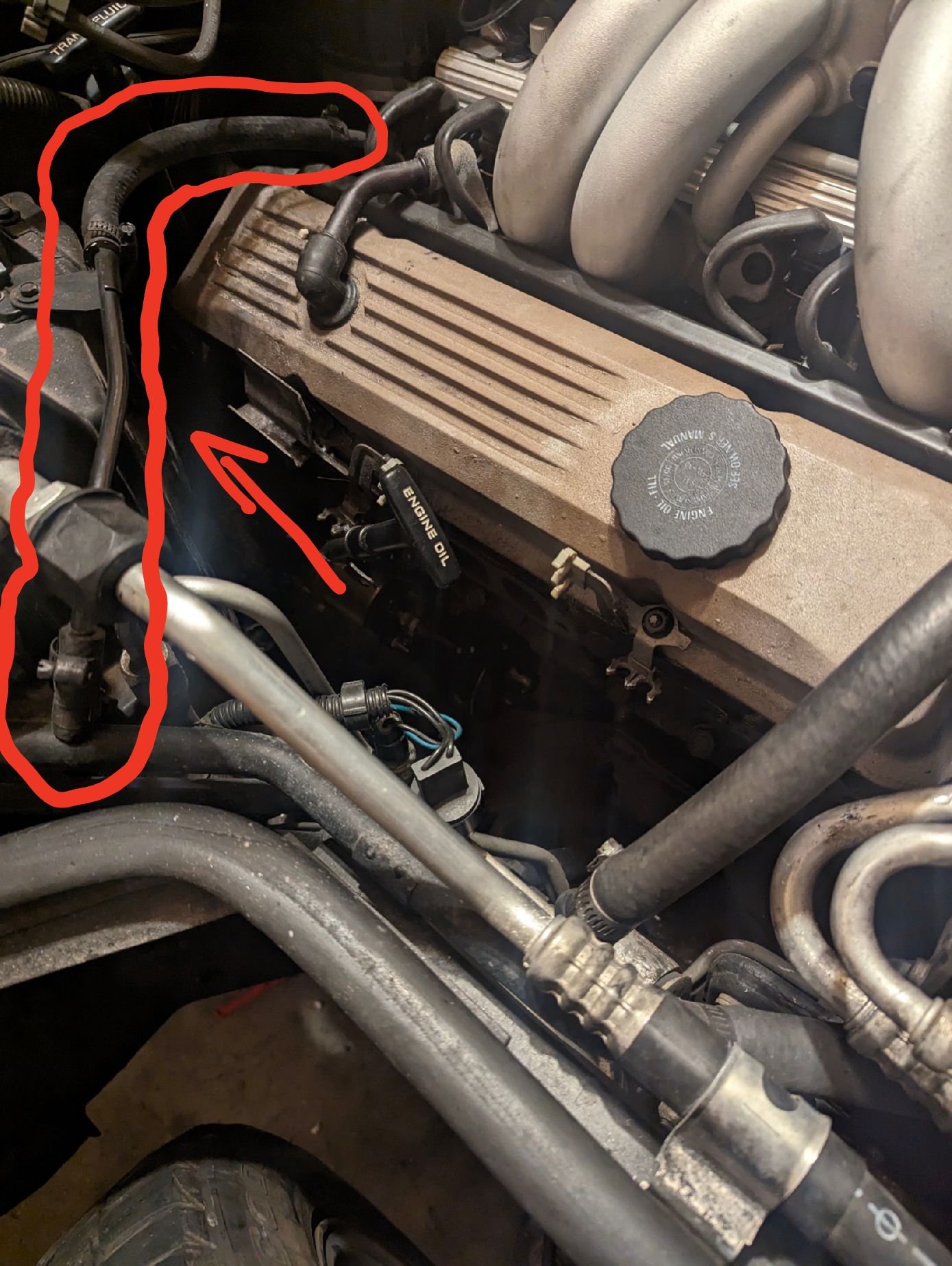

To bleed the system without a kit hooked to the radiator, I’ve just been pulling a small hose off the line to the heater core. It’s pretty high up in the system so it seems to clear air pretty well. I can send a pic if you’re not sure what I’m talking about.

this one here should get most of the air out if you disconnect it while filling.

Thank you guys! That was just about everything I needed to know. So the hose that sredwine posted a pic of....Ill disconnect that. And once its full, do I leave that line disconnected while its running and up to operating temp for a few? This is my first time in case you havnt figured me out yet (blush)

I connect it again once I’ve topped out the radiator and then run the car with the heater on to flush bubbles back to the radiator. Once it’s cooled down again, check and refill the radiator and I’m usually good to go. Not the recommended way necessarily but it’s worked alright for me.
