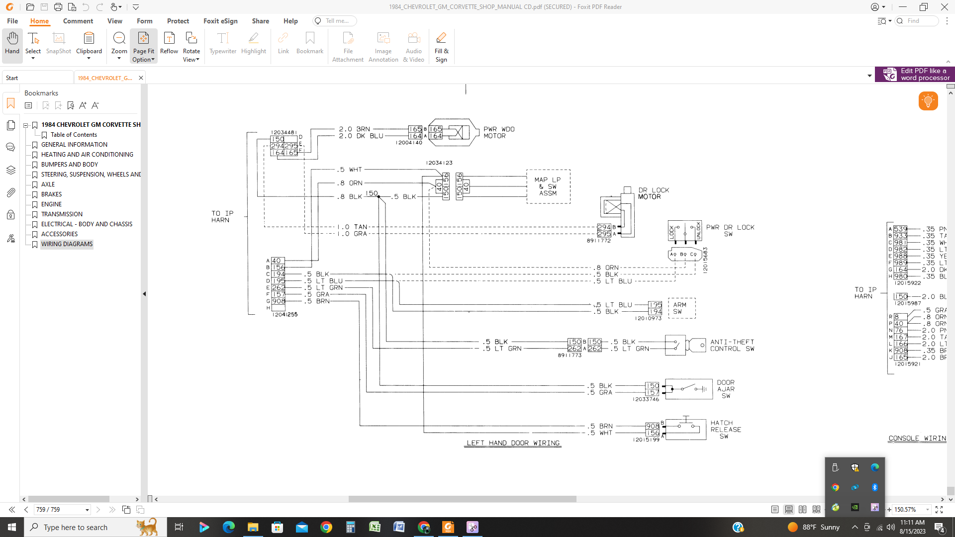

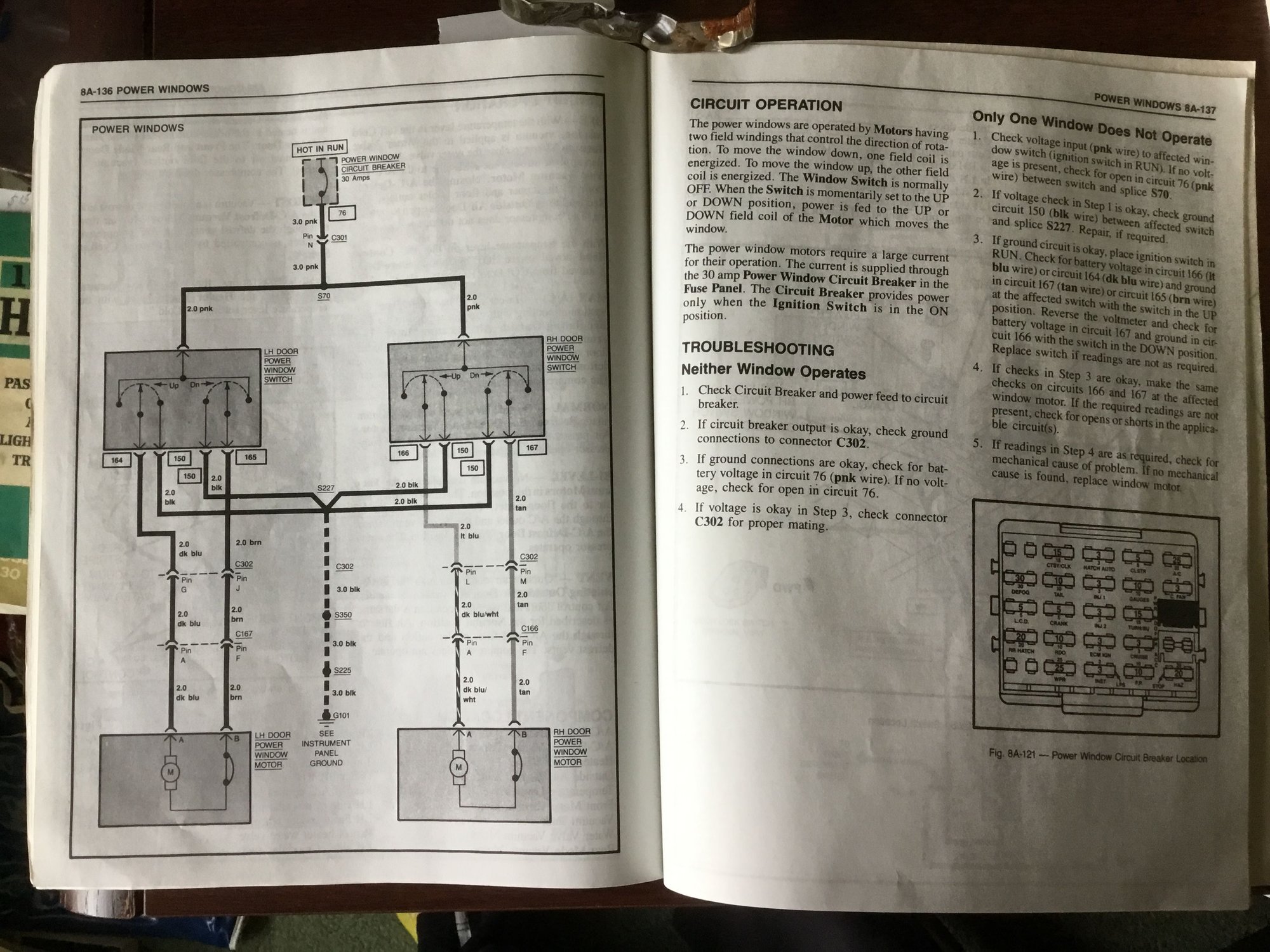

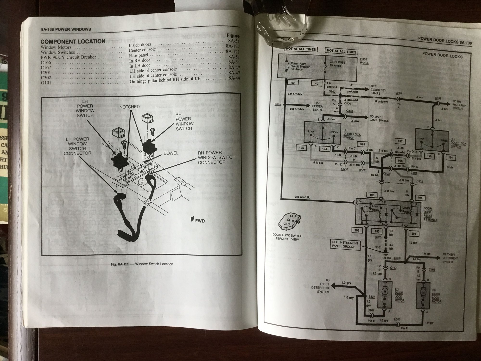

i am looking for a wiring diagram for a 1984 vette drivers door can't find the wires for the window switch and i have one lose wire no end on it with no place to put it if u can help thank u n advance .....

Hope these help... (From GM Electrical Troubleshooting Manual)

Hopfully this helps. PM me your email and I'll send you a pdf file of the 84 FSM if you don't have one.
