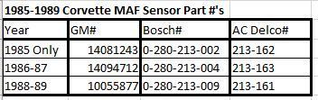

I am not sure your problem is your MAF, but I dug up some more information on 85-89 MAF Sensors that I want to share.
After some research it appears that the 1985-1989 OEM GM/Bosch MAF sensors are compatible with each other despite the different part numbers. Here are some old threads I dug up on this topic.https://www.corvetteforum.com/forums...n-an-85-a.html
https://www.corvetteforum.com/forums...geability.html
1985 is different in that it uses the one year only MAF Burnoff Module, while the 86-89 use relays instead. People in the threads above have tested the MAF sensor interchangeability successfully.
I'm a "Trust But Verify" Person, so I tested my spare MAF Sensor for my 88 (part # 10055877 stamped on it) in my 85 and it worked perfectly for over a week.
This opens up your options and you are not limited to 1985 only for MAF sensors. However, many (including me) have found that "New" Non-GM/Bosch Units do not work well. Buy a rebuilt (or NOS if you get lucky) GM/Bosch unit that is stamped with one of the numbers in the chart above.
