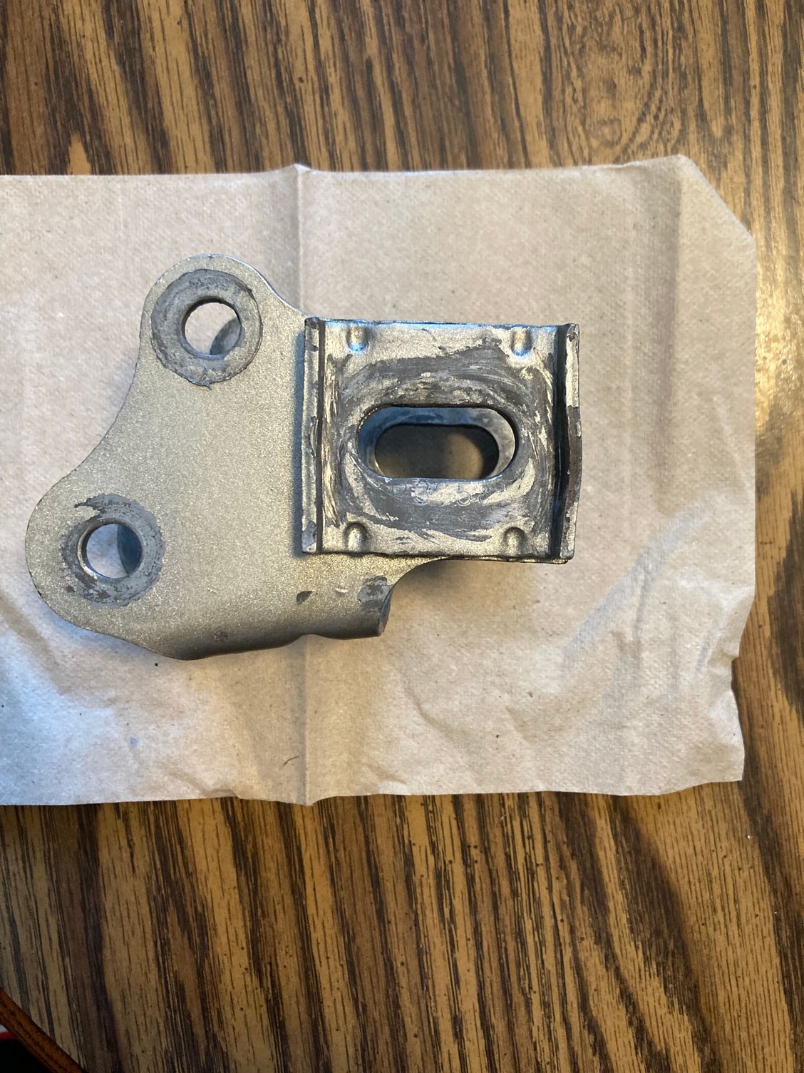

WooHoo...off to the alignment shop. I get it aligned as good as it can be because the RR camber bracket was ‘wallered’ out too much to get closer than -0.3. All other specs look good. I missed this when I put things back togeather:

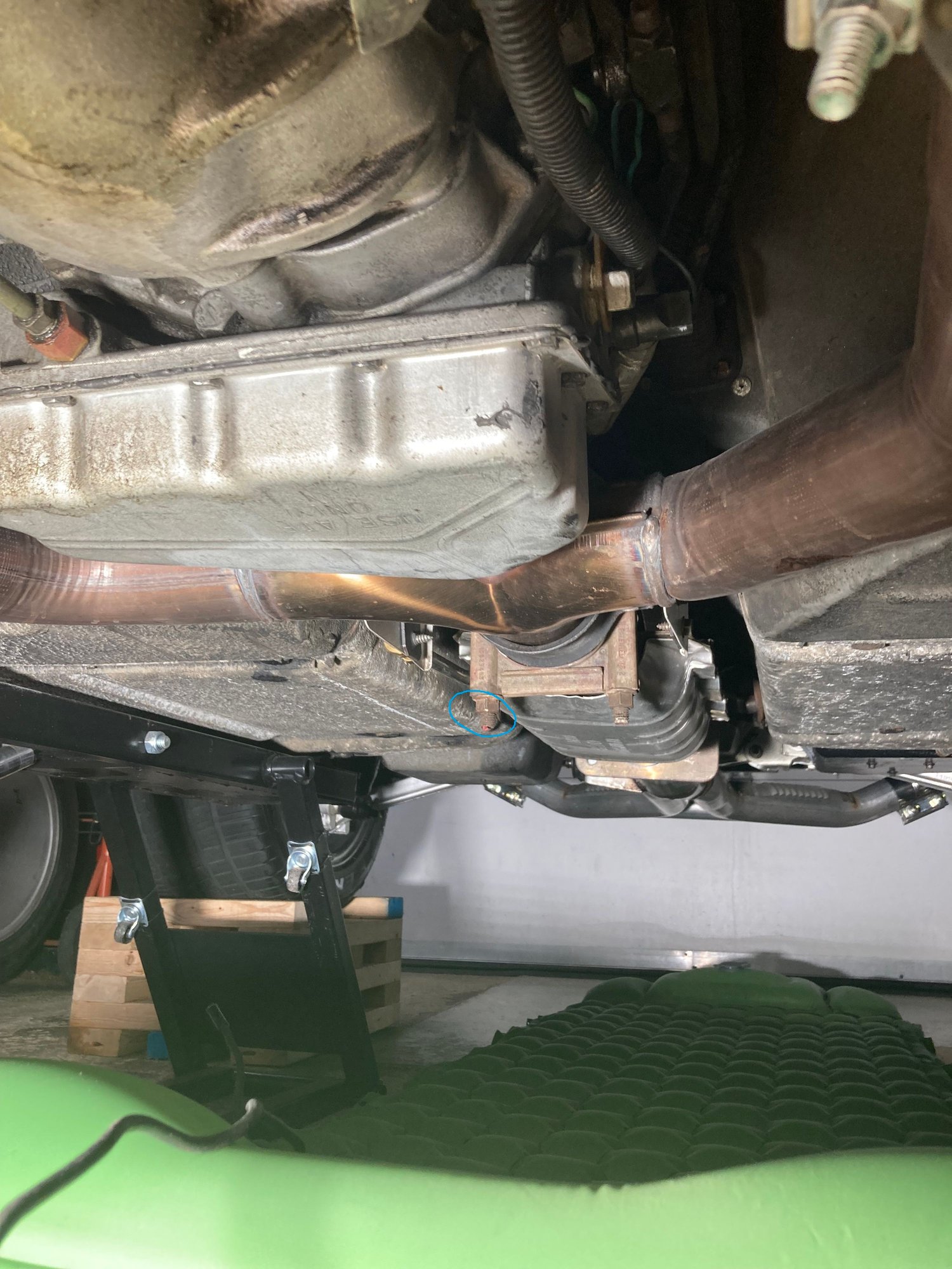

Alignment guy says that the exhaust is rubbing on the center jack part of the alignment rack and he will not be able to do an alignment. The exhaust on the car is all new but it is installed the same as the original exhaust.
So, to try to eliminate anything that will prevent me from getting this thing aligned the third time:
• I replace the RR camber bolt and bracket
• I changed the orientation of the saddle clamp that attaches the front y pipe to the main catalytic converter. The nuts are now more on the side rather than the bottom.

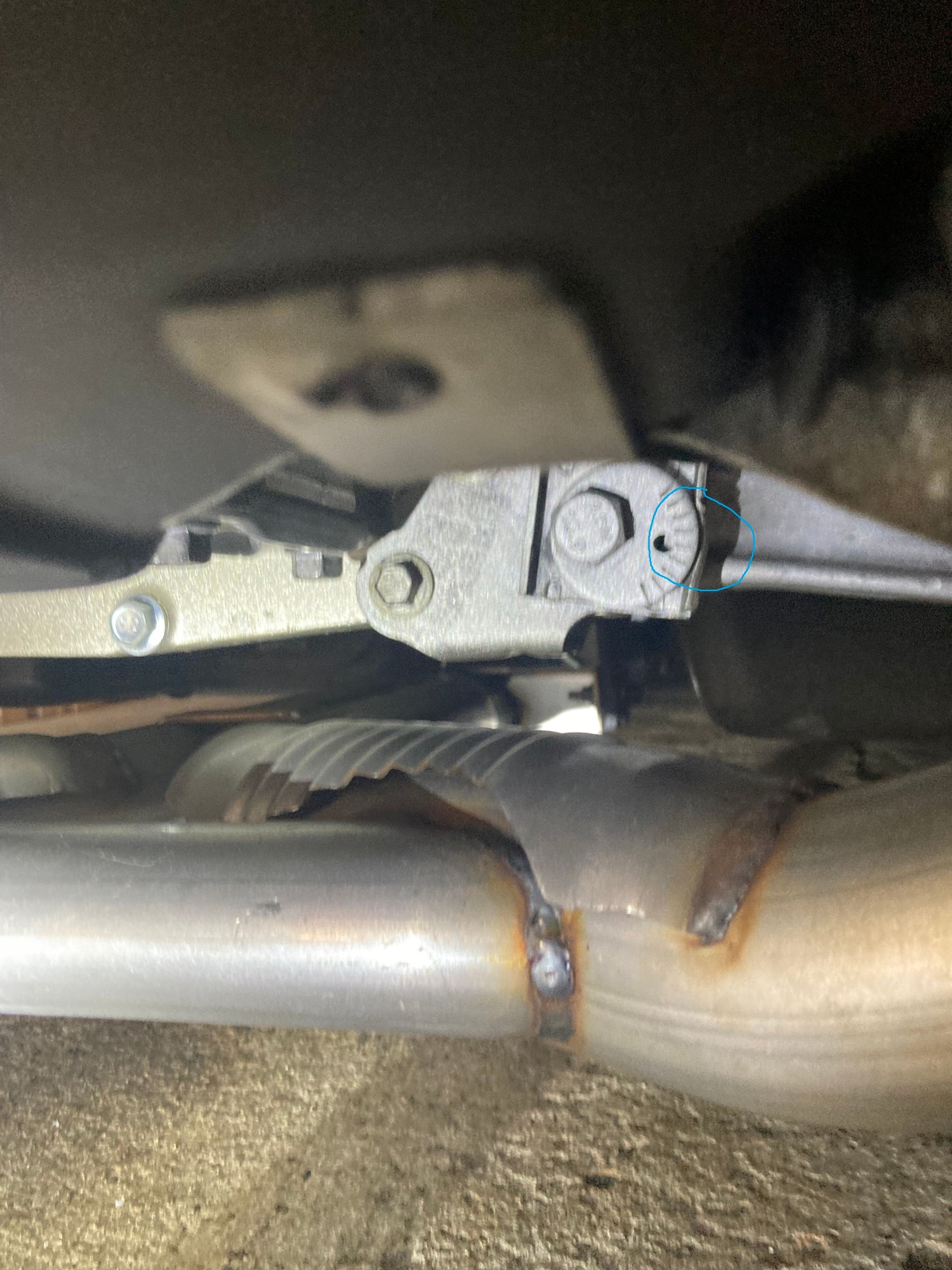

OK, so I am fairly confident that I can get it aligned this time, but oh how freaking wrong I am again. I am in the waiting room and I see the alignment guy going back and forth and then the manager walk back to the car and now I am really getting worried. The waiting room door opens and he brings me out to the rack and shows me why they can not align the car this time. The RR camber bracket that I replaced actually looks worse than the one I freaking replaced:
I remember this from Tom400CFI:
It seems like a lot of "Fuss" over little. You can buy the bracket and camber bolt, and shut the alignment shop up. But functionally, all the alignment shop NEEDS to do, is move the lower arm in....or out. It doesn't matter if there is slop in the mechanism that moves the arm in and out; that mechanism is not what holds the arm in place, once adjusted and tightened. It's the tightening of the mounting ears onto the inner steel sleeve in the bushing, that "locks" the arm's position in place. I'd think that w/a little effort, the alignment shop ought to be able to make the original cam and bracket work "fine", for moving the arm in and out.
When I mentioned this to the manager of the shop, you'd think I threatened to kill his dog, he was not listening to any of that, and in fact, in so many words he was telling me I was wrong. When I told him that I torqued that nut down to 185 ft/lbs, he told me that there was no way that was correct and that sounded more like an axle nut to him. He went onto AllDATA and could not even find the torque settings for that. There is not one thing I can do but take the damn thing back home.
I drove down the street about a mile to another shop that has been around since I was a kid, and had the guy come out and look at the car and get his opinion. He tells me that what Tom400CFI states is exactly correct, and that he has ways to get that to work. So I am taking it in for the forth time and hopefully I can "git er dun".
So to go back to the very beginning of this post.........What the heck am I doing wrong here? What did I do or not do that made that new cam bracket I installed get like that in just the drive up to the alignment shop? (about half a mile)

Looking around, I have noticed that the rear strut rod camber bolt kit that everyone is selling comes with a spring lock washer. If I were to replace one of these, would I use that lock washer? The FSM or the GM parts book does not show a lock washer.
