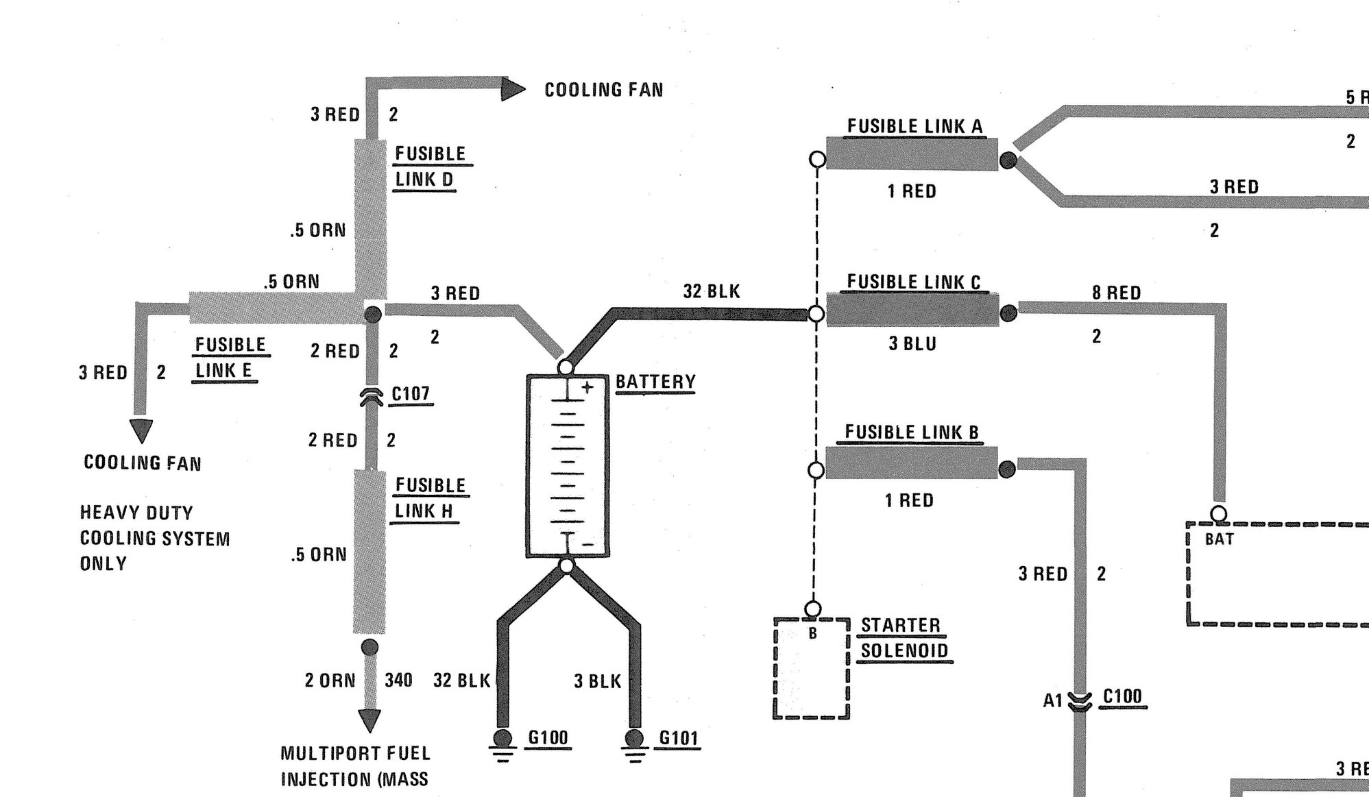

Besides fuses, there are fusible links. You really need the service manual. This link will get you a copy of the '87 manual which is 95% the same. Better than guessing.

I agree with the above post. Check your fusible links, right off the positive terminal of the battery.

Green posts don't help, fusible links for 84 & 85 I believe are off the starter hot lead.

Get a correct 1985 FSM - the '87 suggested is no where being usable for your '85. In particular the fusible links that have been mentioned.
