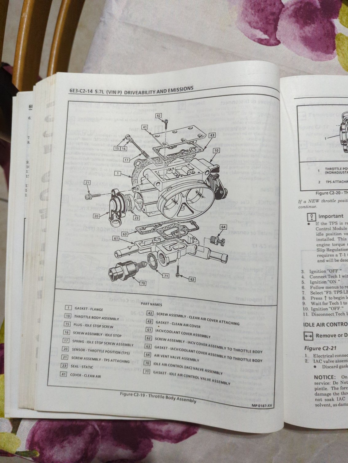

the photo of the iac valve in the 1992 fsm manual is different from the one mounted on my trottole body, are the installation rules the same?
also my tps sensor is different from the 1992 manual

Sounds like your throttle body may not be original to the car? Can you post a photo of your TB area on top of the motor? There should be a part number stamped into the side of it also....

Ah, I see the issue.
In the first manual above, you're looking at the section of the manual that applies to ZR1 Corvette engines. The top of the page which says "VIN J" means it has the LT5 motor, which is different than the second manual section that you're looking at. The pages marked "VIN P" apply to the LT1 engine that you actually have in your car. So use the installation rules for that IAC valve in the " VIN P" section.

ok I understand, did I buy the wrong FSM? these are mine.

Nope, you're good. Just be sure to use the sections of the manual that are marked "VIN P" for your LT1 engine sections.
