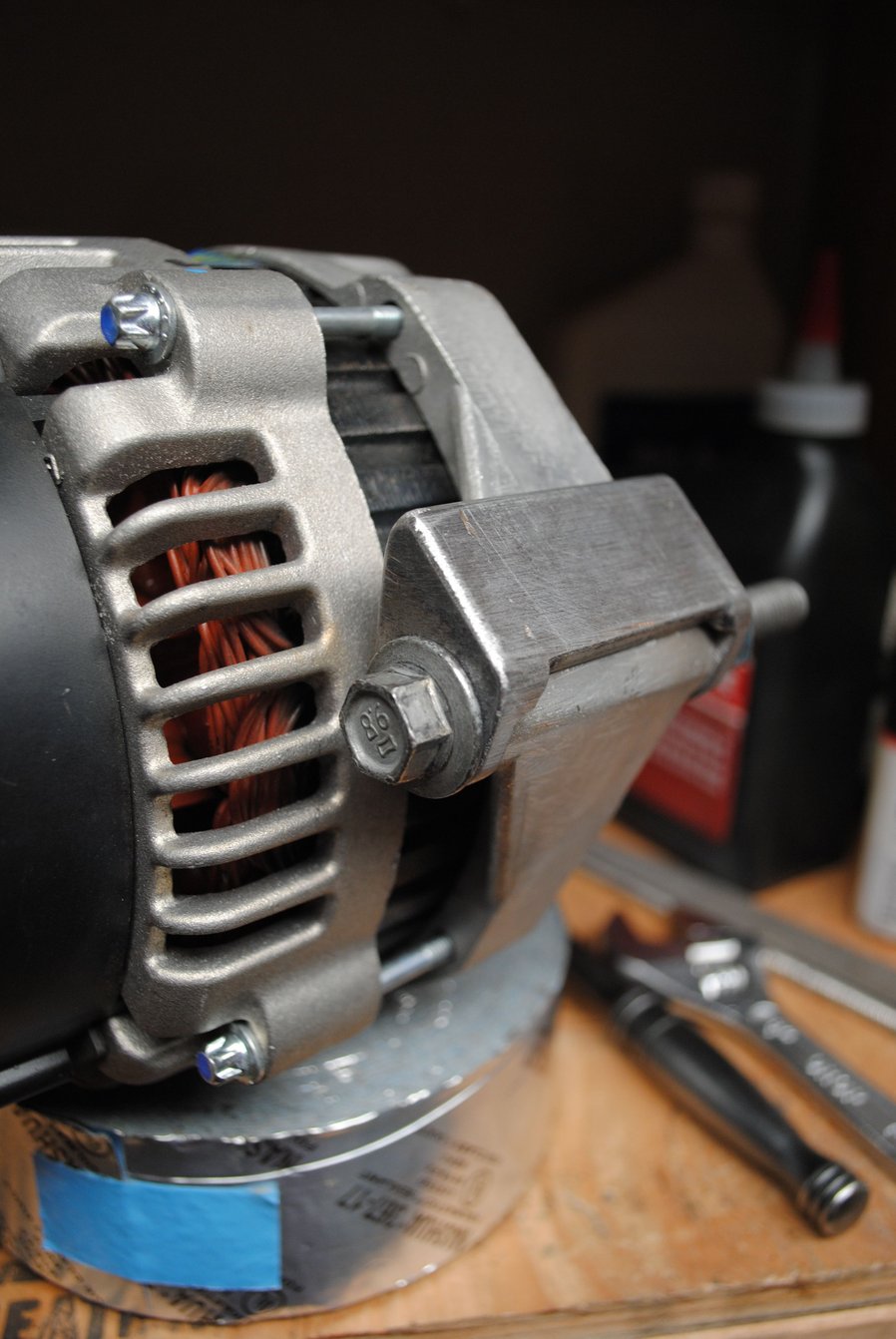

I've added a supplemental bracket to halt the rotation the torque on the pulley is imparting to the assembly. This would remove that duty from the previous combination of stock and new brackets and limit their duty to pure compression. Well, probably not pure but much closer to it.

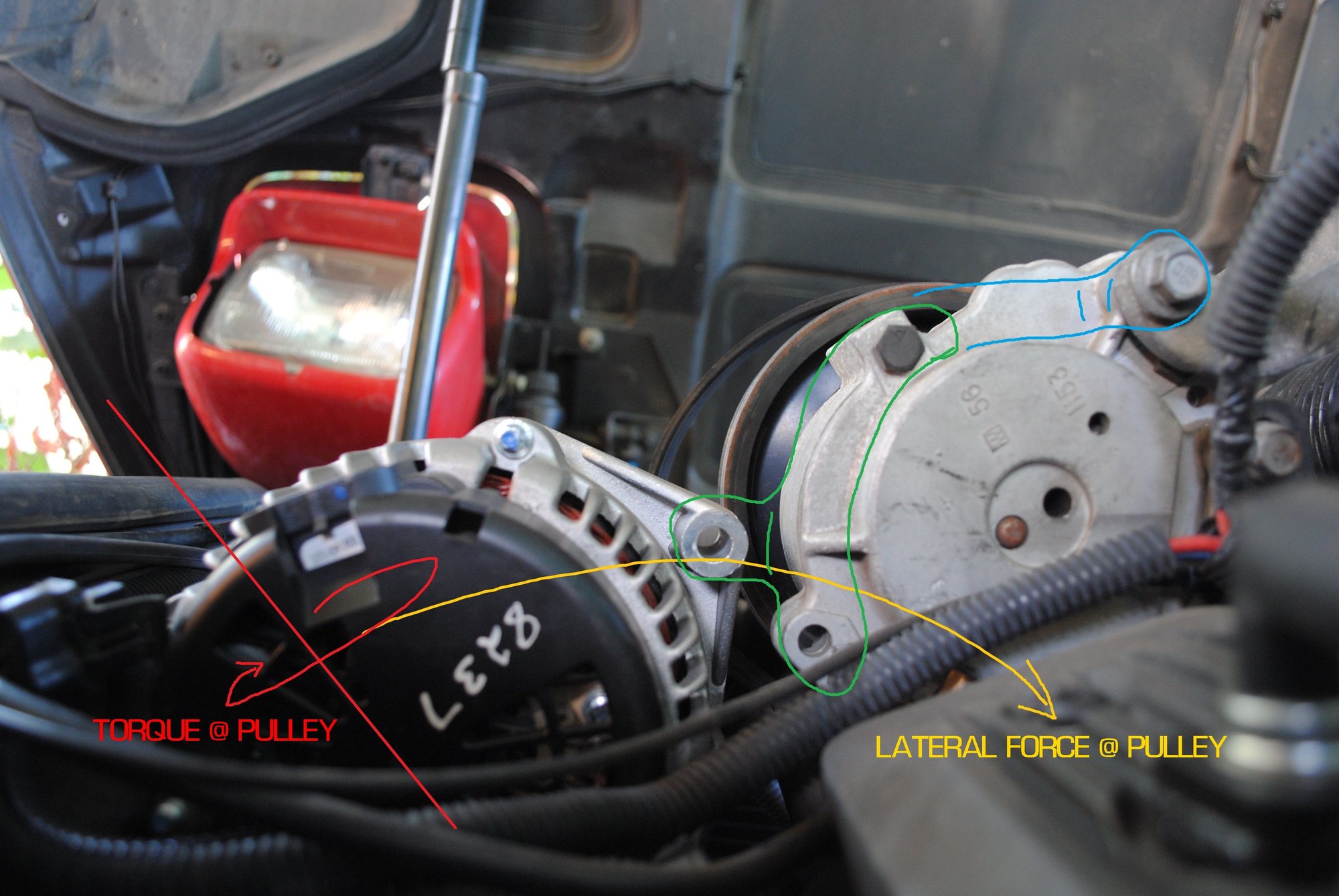

Here is the AD244 in place. I've sketched in the forces its experiencing, as I understand them. The red shows the tilted axis about which the torque at the pulley from the belt is attempting to rotate the assembly. The line goes from the bottom mounting tab up through the pulley centerline. So my fabricated upper bracket should help oppose this torque. The frame on the AD244 is quite robust at the mounts and the bottom one seems like it could probably handle it on its own if it had to but still, it shouldn't have to.
The yellow curve shows how the belt pulling roughly horizontally on the pulley is also trying to rotate the whole assembly around the established bottom mount. For this reason, I don't think the simple red tab ajp01 propoesd above would be adequate. It would be subjected to some weird forces, pushing really hard down on the air pump side mount while trying to force the alternator upwards.
What I've shown in green is a bracket that could use the existing air pump body bolt locations (green) and maybe even add in the stock upper bracket mount (blue) for extra strength. I prefer the idea of using the intended factory load points to improvising my own, wherever possible.
The big issue with the bracket ideas shown below is that all the bolt locations are at different levels so the brackets would be anything but flat plate. I'd have to add a bunch of double bends in them to get them to lie flat in direct contact with each hole. This would be rather annoying.

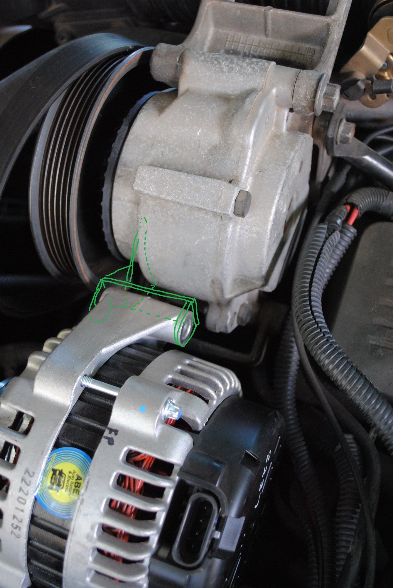

I've settled on this arrangement. An adapter bracket in yellow to mate with the stock upper brace. A second Z-shaped bar in green to resist the twisting of the alt body. The two bolt holes it uses are virtually coplanar, in that the rear face of the alt mount hole is pretty much the same plane as the front of that unused air pump hole. So I'm going to make the green piece separate from the yellow bracket and add it on the outside of that bracket. So it will need the Z to traverse two thicknesses of steel. I think I can manage this bend in my vise.
The bend I'm more concerned with is the loop at the end of the yellow bracket, through which the stock bolt is to run. Not sure if I'll be able to wrap this 3/16" plate into a tight loop like that but it seems easier to tune the width of that looped plate than it would be to stack multiple little tabs together and weld them onto the base and get them to the precise width to fit snugly in the stock upper arm. I reckon I'll screw with that BEFORE I weld that piece to the other piece running across the alt at the mounting ear.
Oh--one last issue. That unused hole in the air pump is in a good spot but it's not without problems. It's very close to the adjacent hole that IS used and the bolt head there is very close to the unused hole. So close, in fact, that there isn't currently room to accommodate a new bolt head or nut. So I'll try getting two allen head bolts to use in these spots and hope they leave room for one another.

Well, I made a disappointing and embarrassing discovery today, having spent the weekend farting around with this bracket.
Turns out the bracket was a non-starter from the beginning, only I didn't know it because I waited until now to confirm that there's clearance under the hood. And there isn't!
This photo shows my last ditch attempt to reposition things and make space but closing the hood on this pushes it all down 'til it's "sitting on its stops."
So Plan B is something I came up with earlier on and decided against because I wanted to use the stock bracket. I call it, "Little Green Nasty." And I'm not sure if an engineer would love or hate it but it is the embodiment of two desirable philosophies: simplicity and efficiency.
I'll modify what I've already created by welding a simple little leg on the opposite side of the current one. This new leg will torque against the front face of the air pump and the main body of the bracket is just going to rest against the body of the air pump. Yes, that's right--no upper bolts at all! The tension of the serpentine belt will pull the alternator against the air pump and hold it secure laterally and the little torque arm will stop it from twisting and breaking the lower alt mount. I think...

Sorry about the hood clearance. I was going to ask when I saw your finished bracket if it cleared the hood, but thought that was already sorted.
On your tab, I'm concerned about pressing from that finger slightly deforming the soft alu of that air pump housing if the force is concentrated on a small area. Those cases deform really easily; the older ones used to have a marking cast into the housing that said "Do not clamp in vise" or something like that.
Wouldn't it be easy to extend that ear further upward to the mounting boss already cast into the air pump housing (the one that the bolt is on the rear plate) and just drill a hole in the front of that boss, tap it or helicoil it, and use a bolt to solidly mount your extended ear and keep the alternator stable?

That is a valid concern. I've created a couple of tiny, high pressure contact points here. I don't think getting up to that boss is really very feasible but I can certainly add a vertical element to my torque arm to spread the load out a bit more.
The contact between the main bracket and the air pump body is also a single point, which isn't ideal. I've been thinking about how to address that. Some kind of hardening plastic putty/resin material I could build a form for and fill the entire void between the two bodies?

Yes, but I still have concerns with any solution that doesn't use at least one solid bolted mount point to that alternator ear.
The alternator and smog pump are going to be subjected to different vibration, torque, tension, and compression loads in different axes. So when those shock loads are distributed through the serpentine belt through A/C clutch, RPM changes, and resonance forces at different speeds, the thing is going to shift/vibrate front-back, side-to-side, etc.
I'd still try to bolt it somewhere if at all possible, otherwise it's going to notch and twist its way to something failing.

I too would like a solidly bolted mount. I'll keep working on it. I do have a curved plate I made to sit against the back of the air pump. You can see the two studs I replaced the existing bolts with in previous pics. I didn't figure out a good way to implement it so I had abandoned that route but maybe I'll keep working on that.
