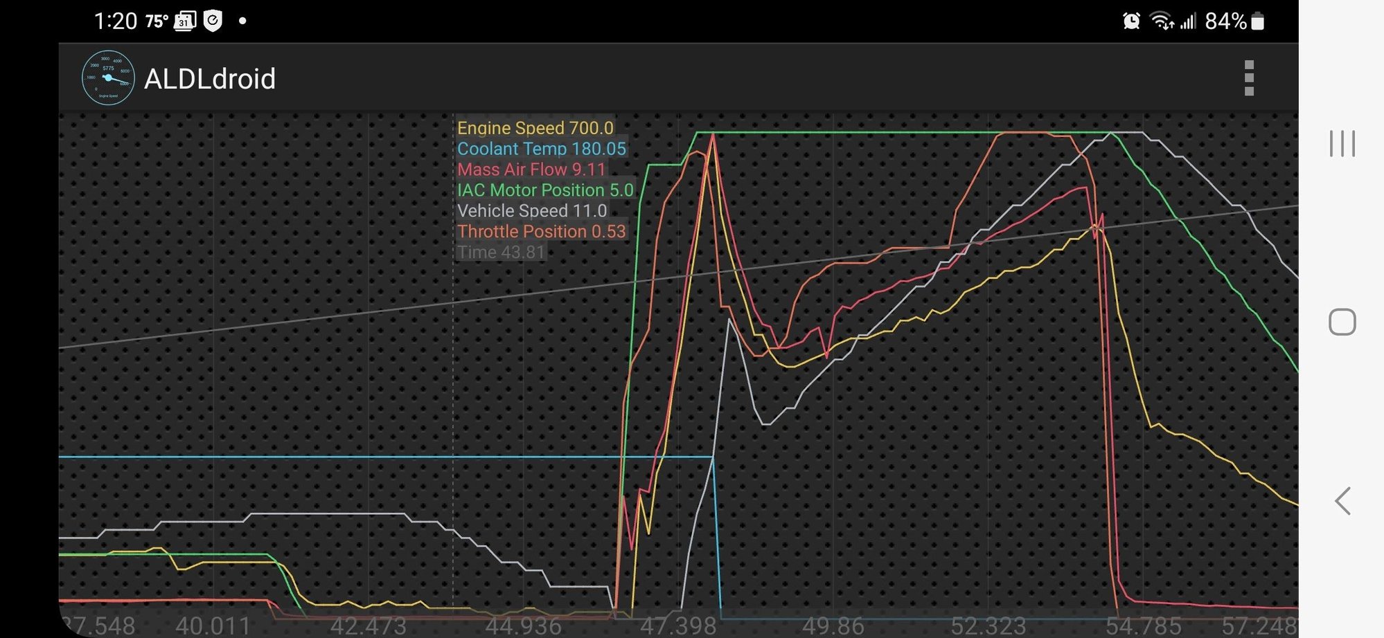

Hmm, interesting. My TPS is at 0.55V, and when car is warm - it is about 600-700.
Also, I updated the Max AirFlow vs RPM table, buy adding +50 to each (max 255) at ACKY. Behavior probably the same (I guess), maybe a bit less smooth than with stock table, but a bit better acceleration (?). Also found interesting IAC behavior with ACKY in comparing to Hypertech on the graph - the drop after high revs is smoother.
Also, made 2 hard accelerations with WOT (second screenshot and csv) and new MAF vs RPM table - second acceleration was with wheels spinning, so thats why speed dropped once I got grip.
New table, normal drive
New table, WOT
New table, WOT, wheels spinning

The good news is that the maf is no longer being limited by the table, or at least not limited by very much. I would add a bit more to the max maf table just in case.
Now for the bad news: The TPS voltage is low. Max observed only 3.1 volts. Its just barely getting into power enrichment mode above approx. 2.7 volts (70 % tps in the table). You should see maximum tps voltage of around 4.5 volts. Check to be sure that the throttle is opening fully. To be safe, reduce the tps % required in order to enter power enrichment mode (WOT). I would suggest 50% until you get the tps voltage issues sorted out.

Yeap, seems it was my mistake during hard acceleration - was afraid to put pedal hard
So now I checked the whole TPS range (by hand and pedal) - it is end to end - 0.56 to 4.18 V. Cant' get it higher on the top of range - it pushes against the throttle body limiter.
So just re-did the WOT test, and it seems more accurate now - reached 4.18V during the acceleration (graphs and CSVs below)

Throttle position looks better now. No issues with PE entry. Strong mass airflow readings of 240 gm/sec (maximum observed) with a bit of headroom left. It is knocking, but not severely. Fuel is safely rich at WOT.
