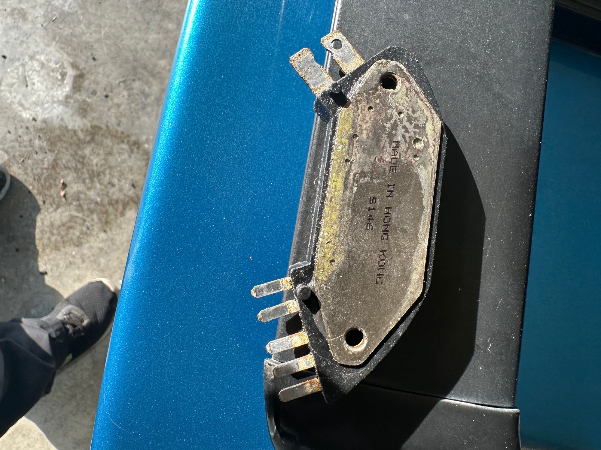

Are you sure the factory memcal is in the ECM? Maybe someone played around with it.
Also check the ignition module and make sure its a factory GM. Aftermarket ones can actually alter the timing delivered to the engine despite what the ECM is commanding.

Opening the ecm is not something I had thought about. I’ll give that a try. I did look at the ignition module and saw no numbers or ID on it at all. Guess I’ll dive in there as well. Are GM replacements still out there?

GM Ignition control module
https://www.rockauto.com/en/moreinfo...t=7172&jsn=934

Found this one in the distributor. I’ll yank it tomorrow and see if I can find any ID on it.

Total ID is "Made in Hong Kong" and 315 5146. All connectors were incredibly brittle, so probably had been in there awhile.
