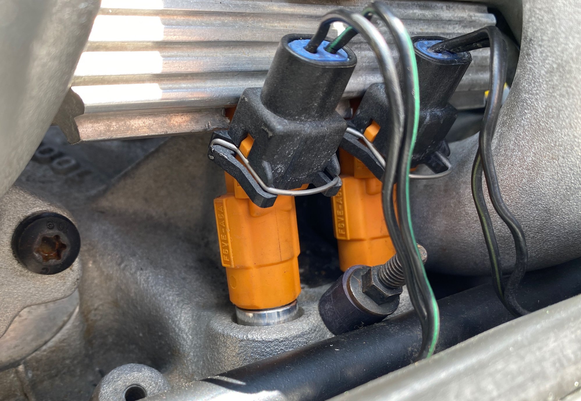

I don't feel much, if any, difference between these and the Delphi injectors I swapped em out for honestly. But it runs fine.
​​​​​0280155710 is the part number on mine, btw.
Still haven't got used to the yellow though...
