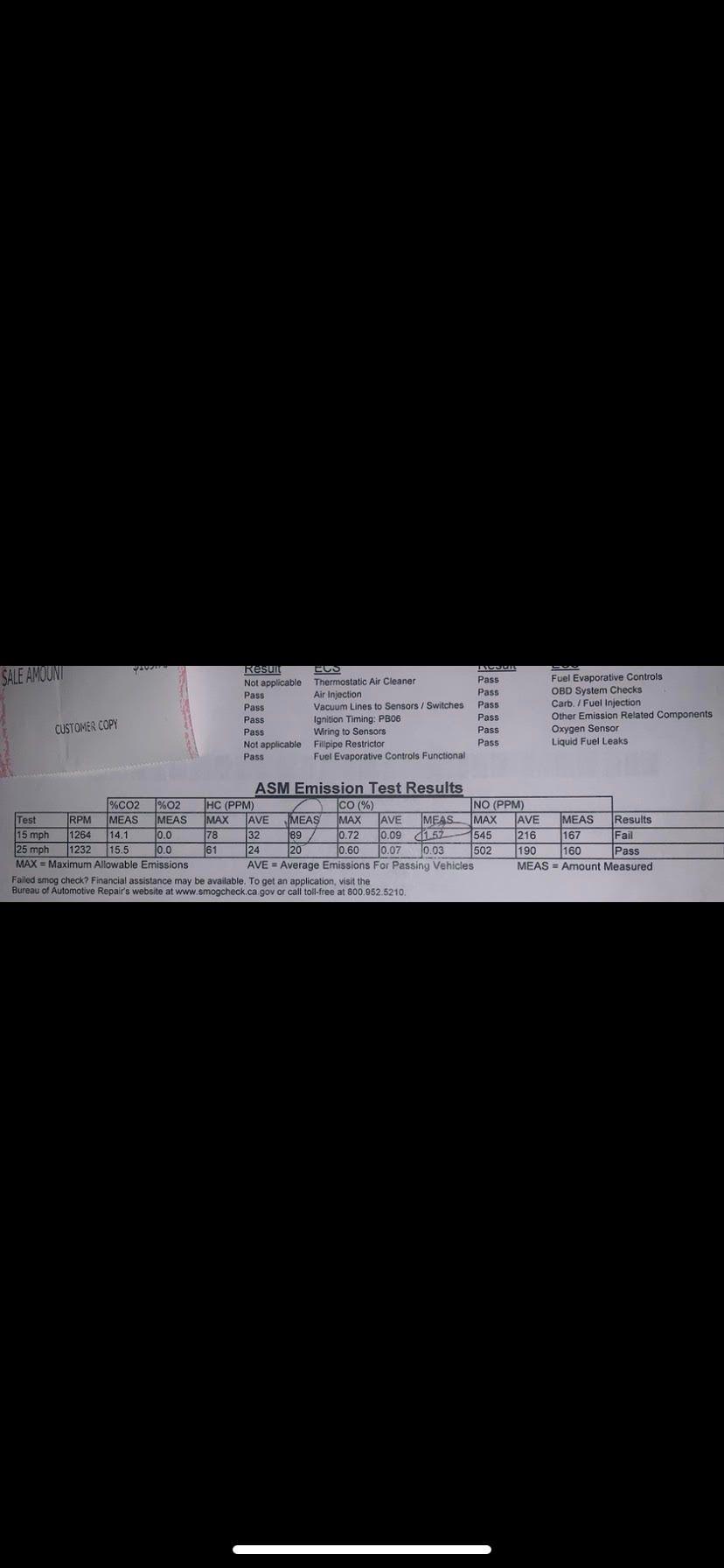

Your smog results show 0% O2. This is indicative of a rich condition. (There is more fuel than Oxygen available to burn it. O2 readings of 2-3% are nominal.) Surprisingly, your Nox is below limits, which indicates the cat converter is effective.

You changed several parts. Did it run correctly after all the parts were changed, or did it begin to run 'rich' at the same time you changed the parts? One hint: There are two basic "one wire" O2 sensors for these early cars. A black wire sensor and a purple wire sensor. They can't be interchanged electrically, but fit in the same hole in the pipe. Does the replacement O2 sensor have the same color wire as the original that came out? ( I think the 87 uses a purple wire sensor, but don't hold me to that. It's been a long time.)
What is the fuel pressure when it is running? Both with the hose on the pressure regulator, and with the hose off. Can you access or borrow a scanner and read the BLM and INT values? (These will be <128 in Closed Loop for "rich".)
I wouldn't worry about "valve stem seals". Worn seals cause blue smoke on start-up, but generally aren't anything to fret over. If your seals are original to the car they've been bad for at least 20 years. Nothing to worry about now.

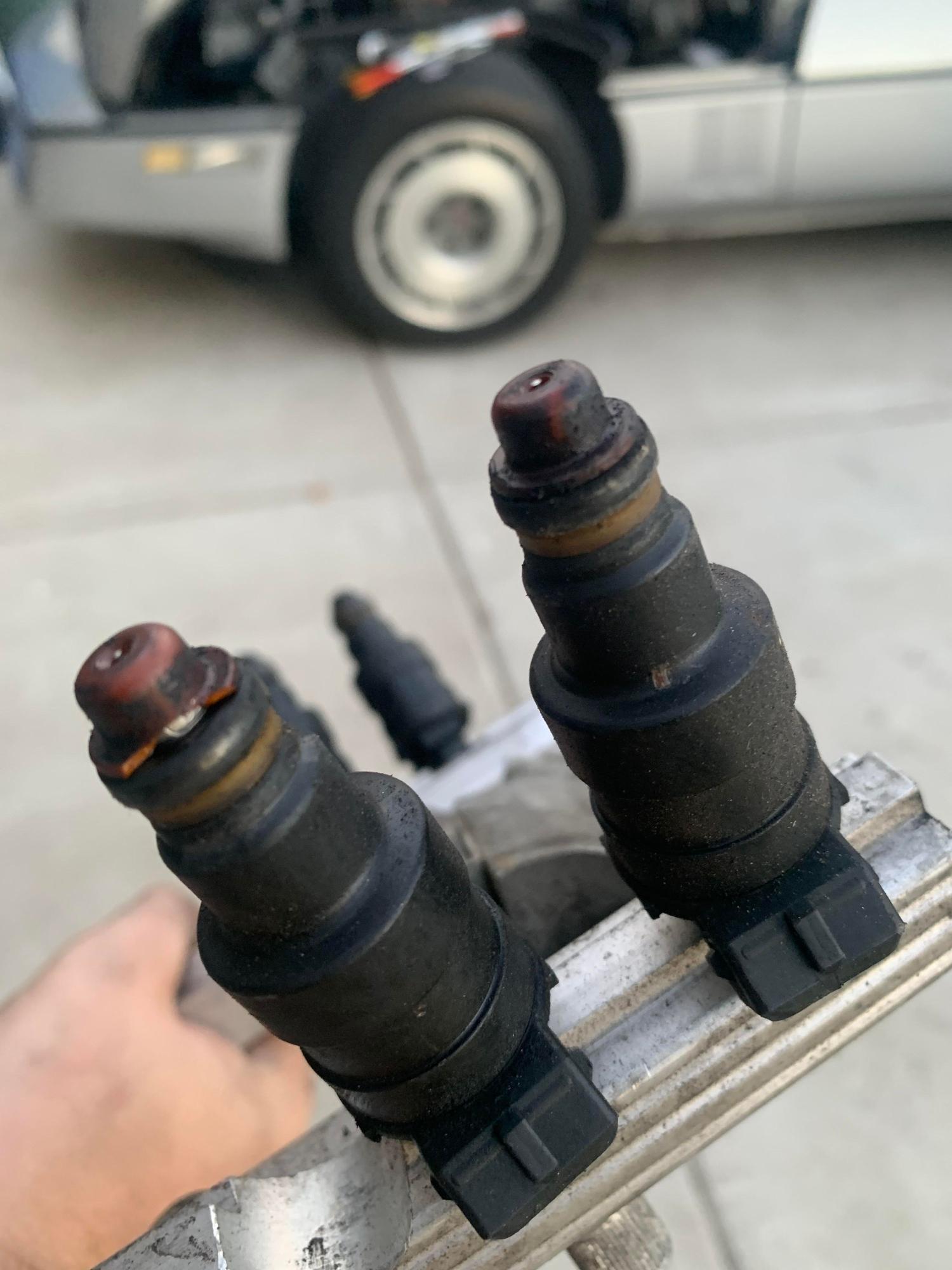

I looked at the injectors in your pic. While grainy, they appear to be the original Bosch EV1s that were used in the 86-88. These injectors are very reliable, and don't develop the issues from ethanol that the Multecs (1989-1991) do. If yours ohm out correctly, they are probably ok.

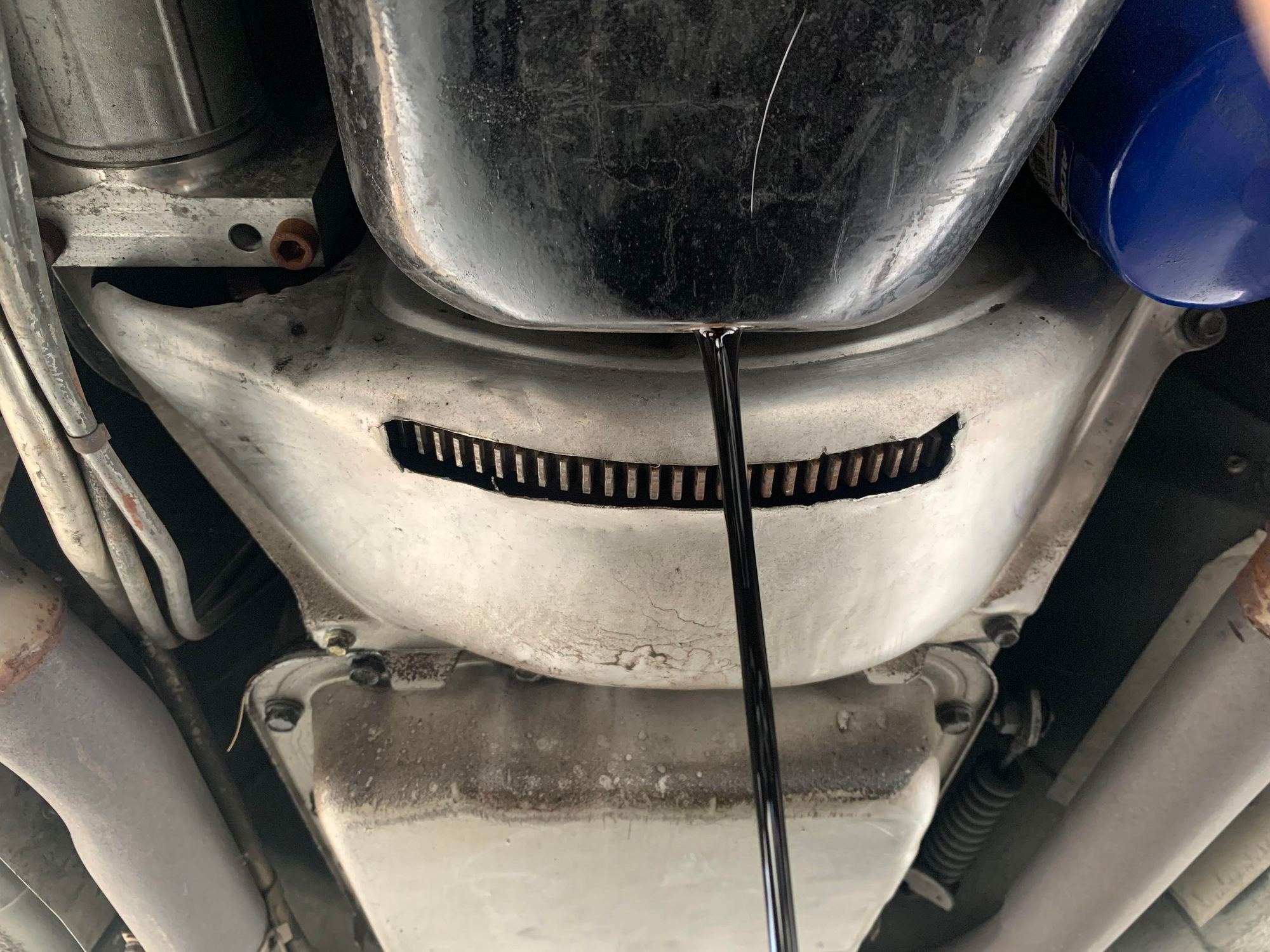

The Cut out in your Flex Plate cover Simple someone was to lazy to remove the cover when they were probably trying to find TDC and couldn't find by bumping, So they butchered. Easy Find in bone yard.
The Plug is a Wheel sensor It will be fine as is just Dab a little RTV to seal the crack, worst you would get is a Wheel Sensor Code and sensor isn't cheap.

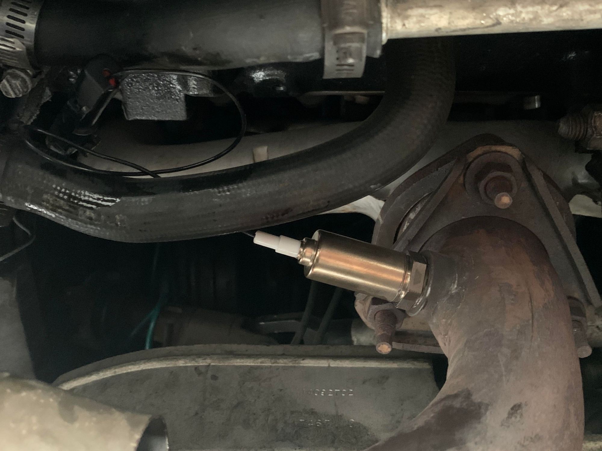

I think I found the problem, anyone know the part number, item name?
The main wire connected is also broken outside of the picture

Those injectors look original and need to go. They can't handle the ethanol in today's gas and had a tendency to short. They are likely the cause of your FP not holding with the key off.
Also, how's your vacuum at idle? There's a lot of old brittle vacuum lines in there.

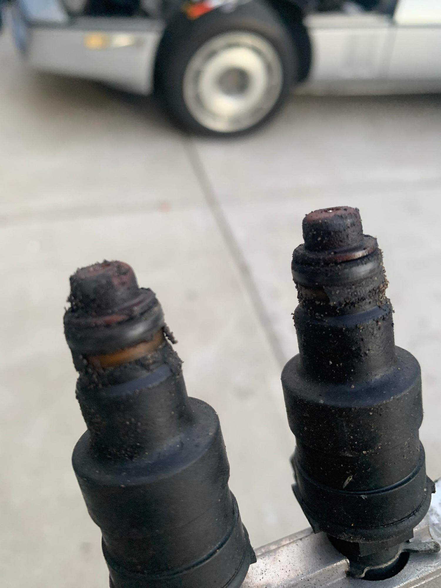

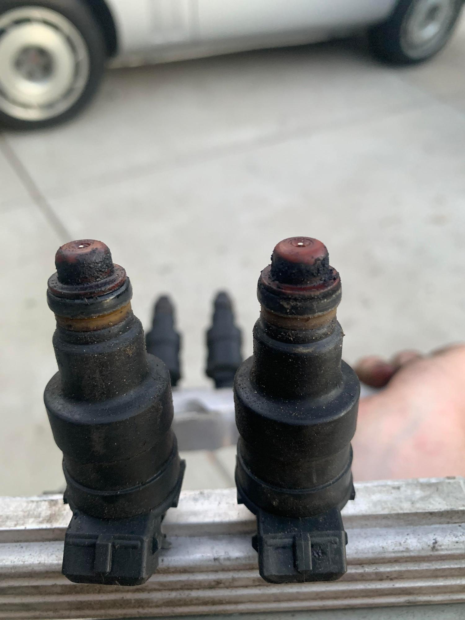

What do ye know, these injectors are all gummed up. hopefully, this is the final solution to my problem. then I'll be passing that smog test and cruising. Gonna give my EGR a clean and some vacuum line replacement. Should I delete the cold start injector, if I do will the car have a hard start?
