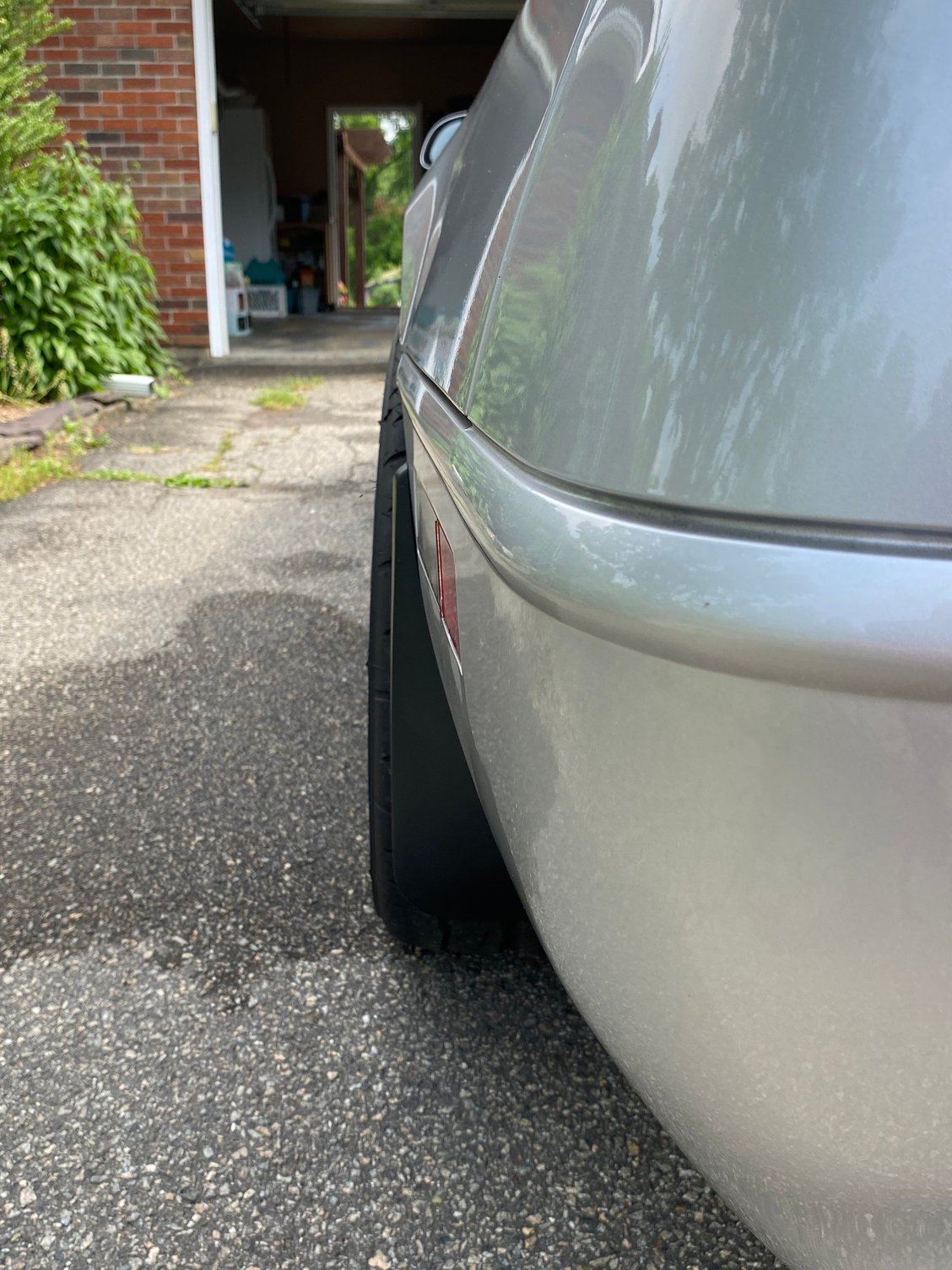

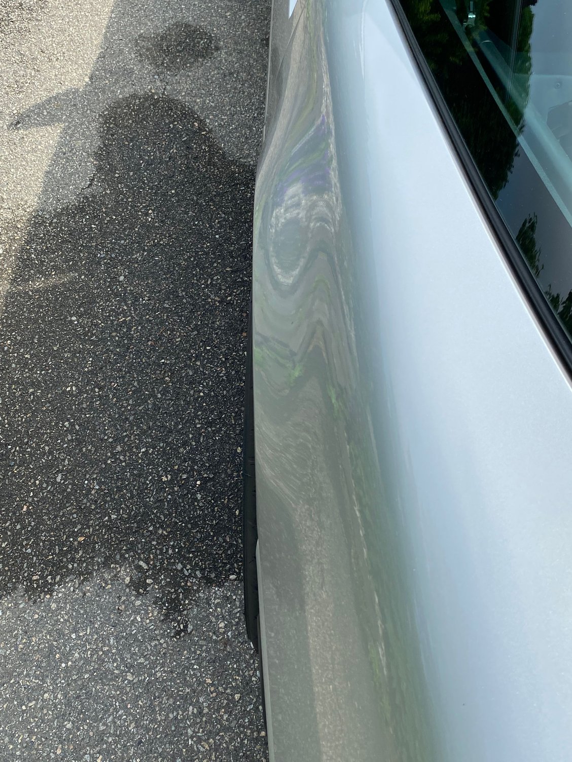

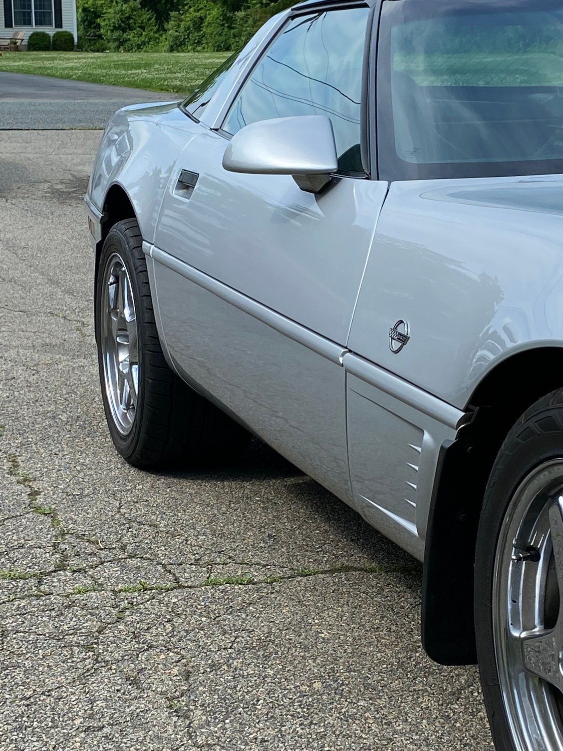

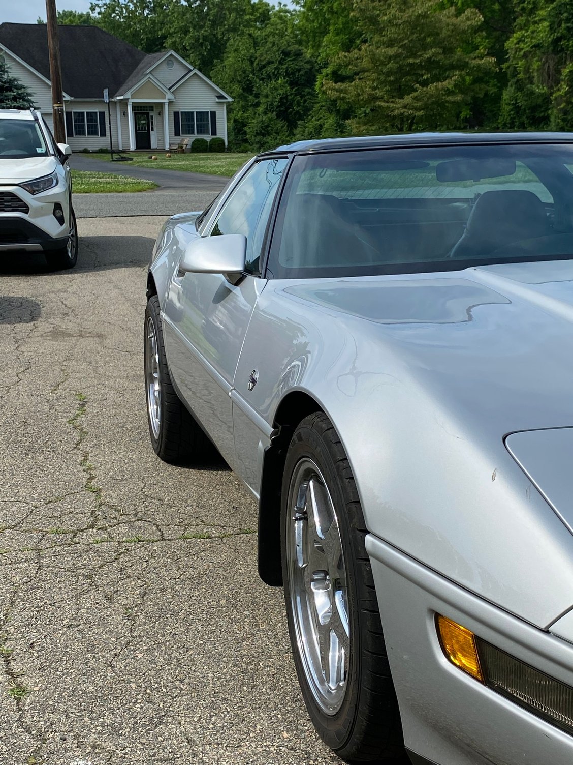

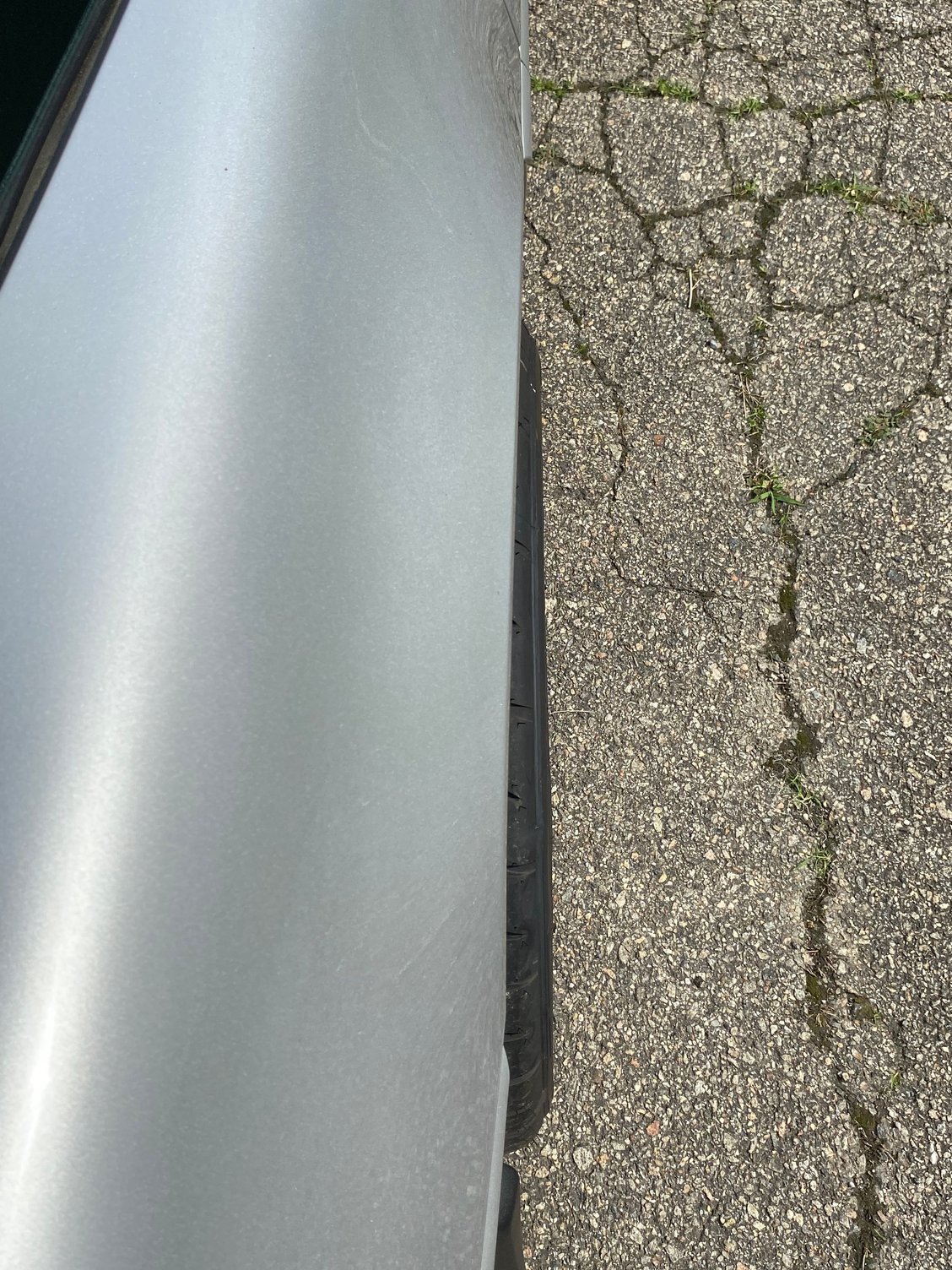

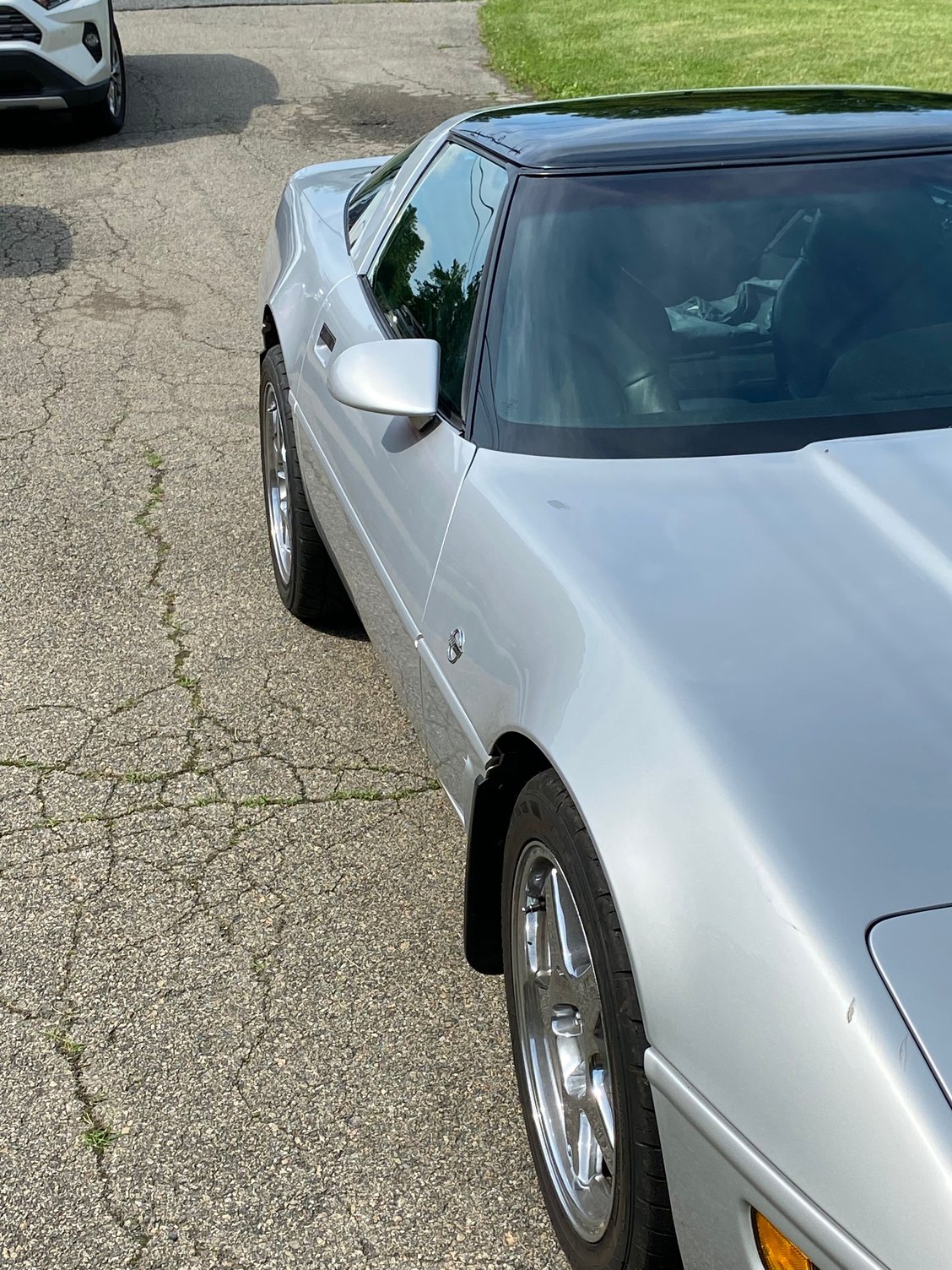

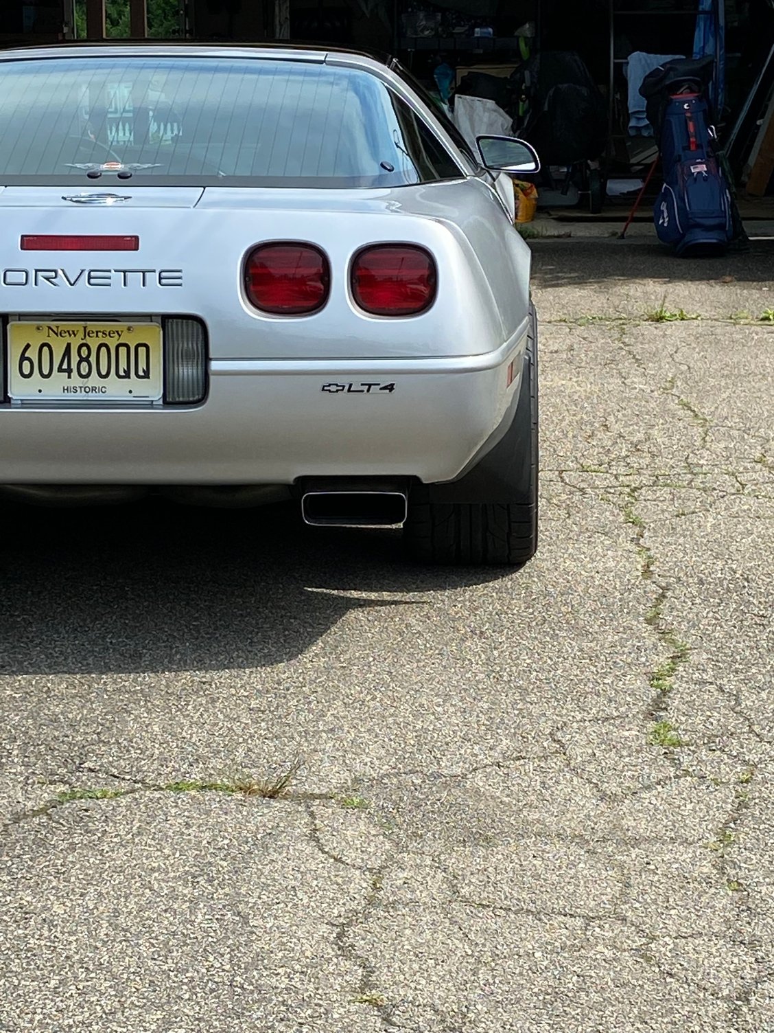

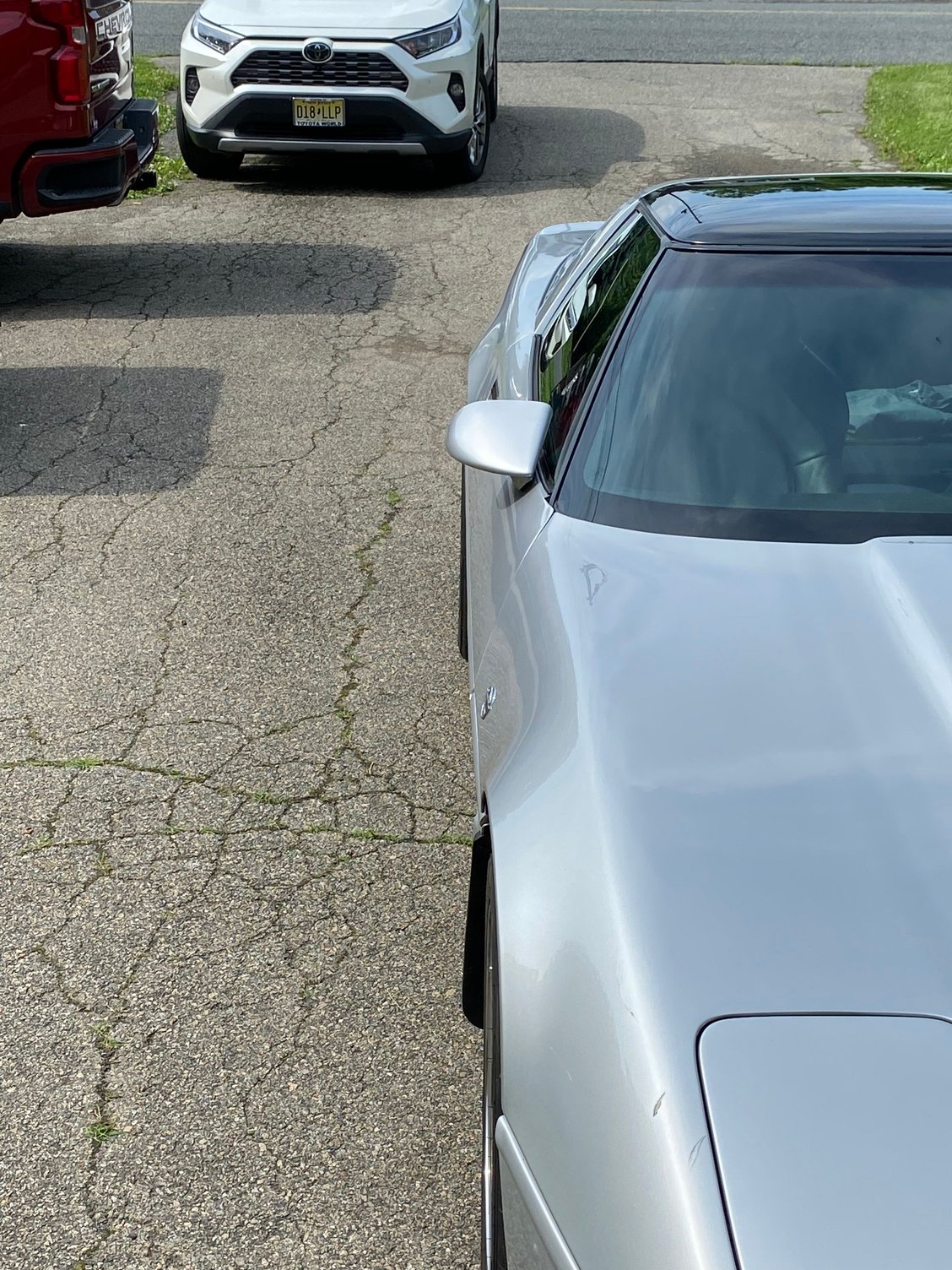

Heres some photos of my dad’s otherwise stock car with 17x11’s and 315’s. Just enough poke to give it the on steroids look without being too much. 50 mm offset

Looks great!
