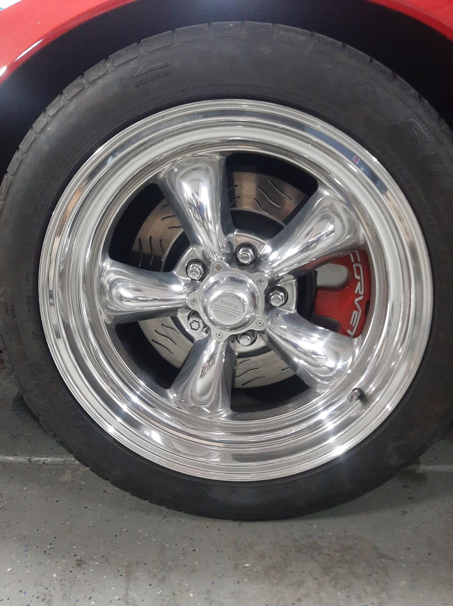

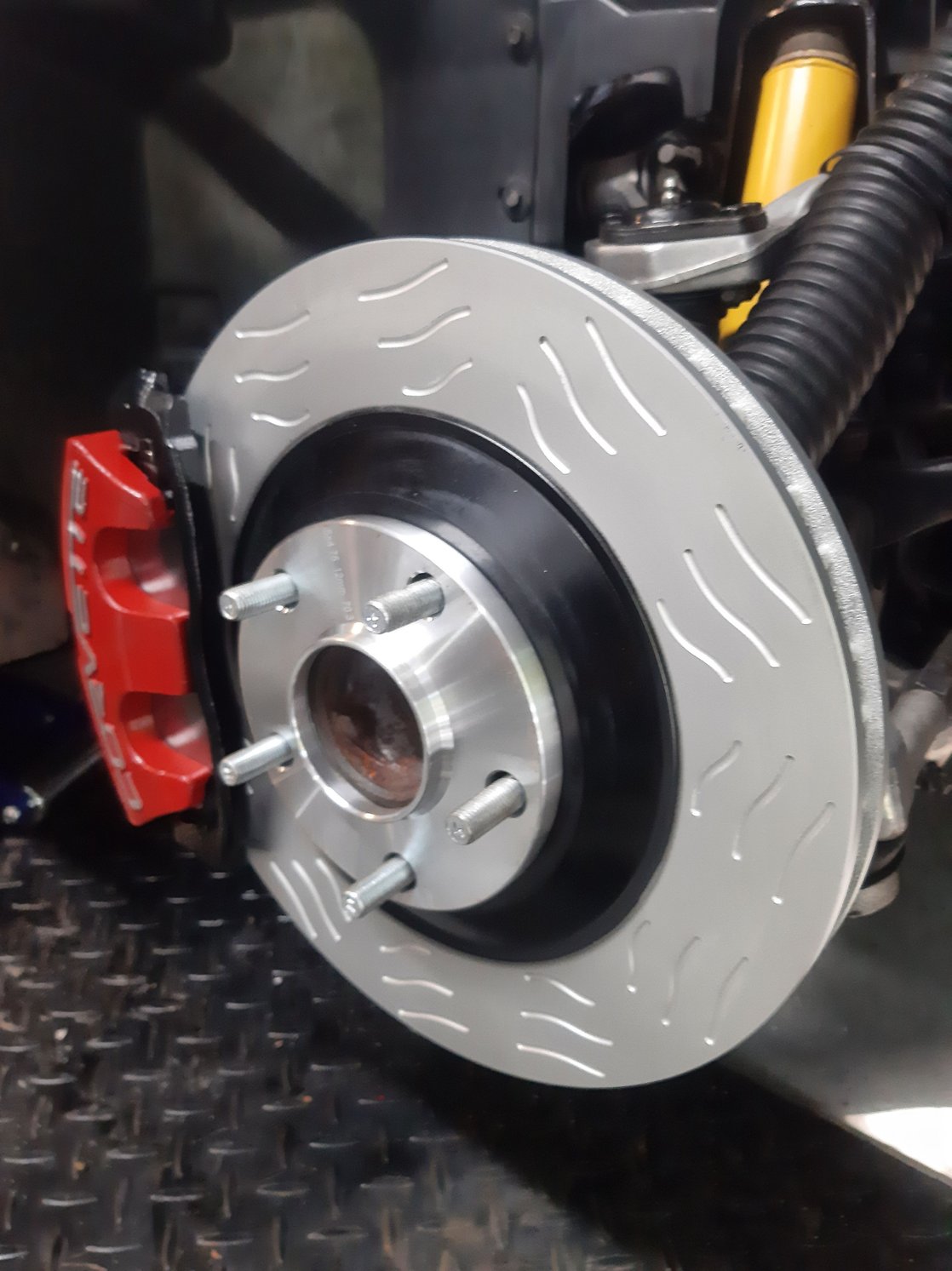

I just put the c6 base front brakes on my 86 earlier this year. My understanding is their a little more ridged than the c5 calipers. I got the calipers at advance auto parts and the brackets from send cut send. I will post some more info of the part numbers a little later.
Old Nov 28, 2023 | 06:42 PM
red86silver78's Avatar
red86silver78
Joined: Aug 2012
Posts: 337
Likes: 71
The calipers came bare I painted them. If you use the c6 brakes like I did just make shure they are the base ones and not the z51. The brackets for the base c6 are the same as the brackets for all c5's.

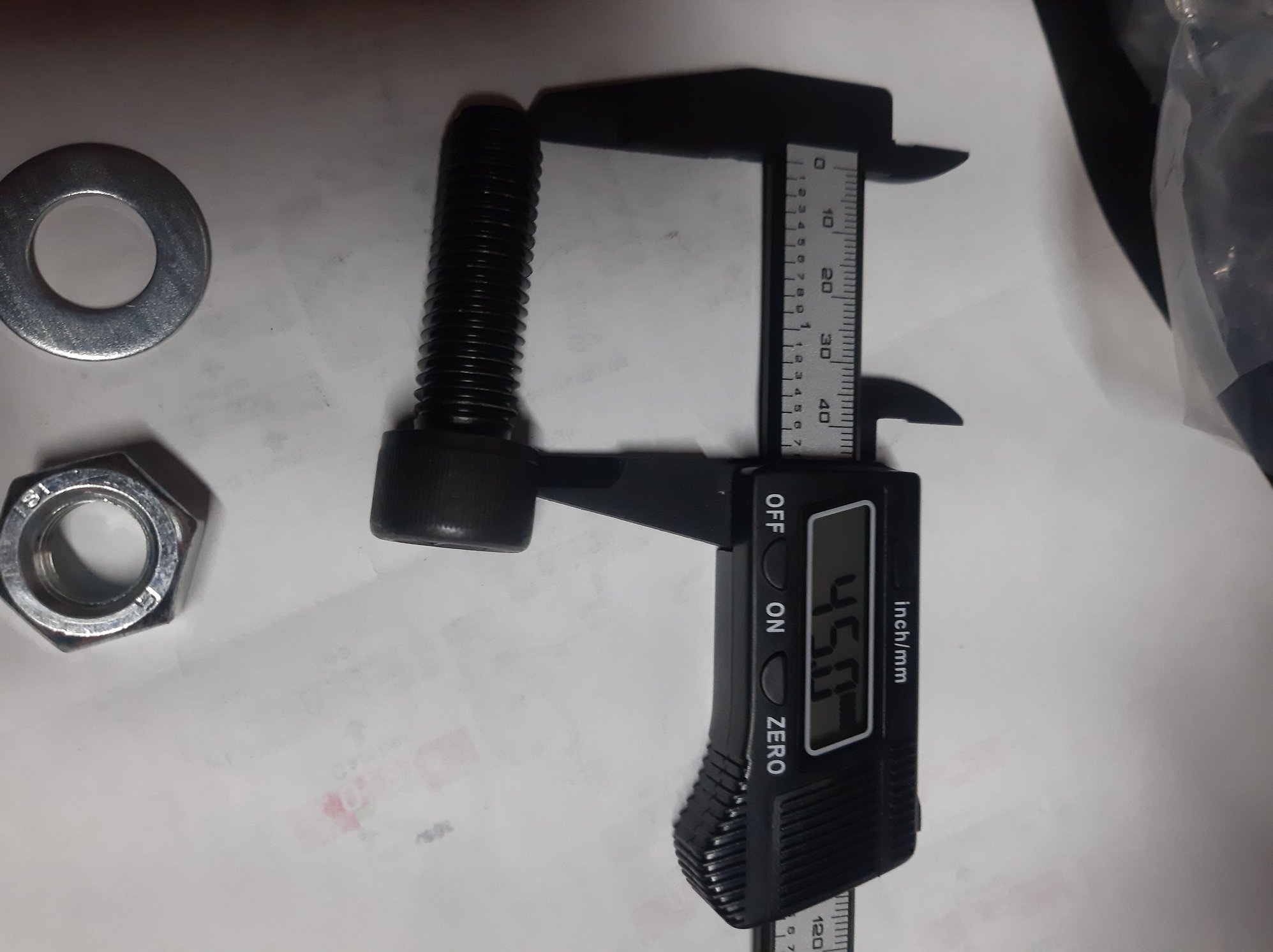

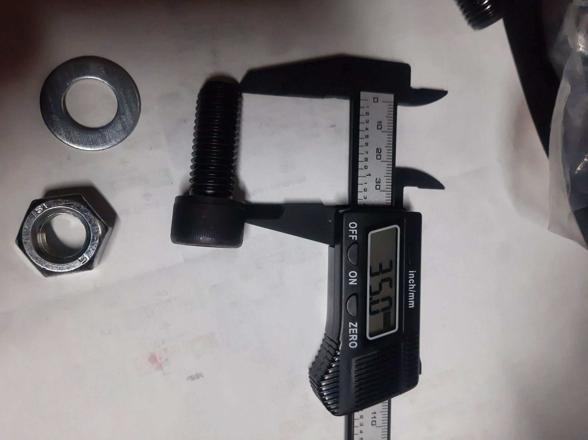

I bought these bolts and nuts locally. They are 12mm x 35mm and 12mm x 45mm socket cap bolts 12.9 grade. Hope this info helps. The brakes were a major improvement. I had also before doing this got the master cylinder bias spring years ago.

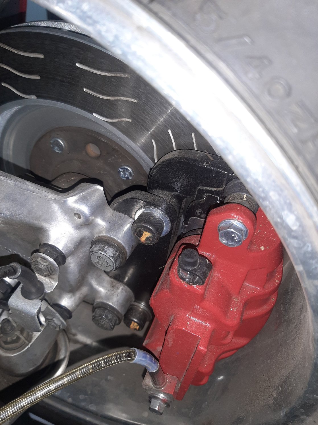

Here is one more picture of everything bolted up. I actually only need to use the 35mm bolts I bought and reused the longer factory hex ones. And my existing lines worked.
