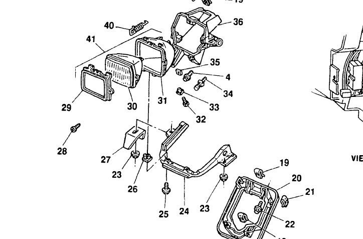

Ok when I rebuilt my headlights a while ago, these brackets never got installed. Headlights worked fine. But for the love of God I cant tell where these go. I might just leave them off as lights work fine, but im fitting my new hood up so figured I'd make it right. I had saved someone's photo a few months ago but lost it....thanks!

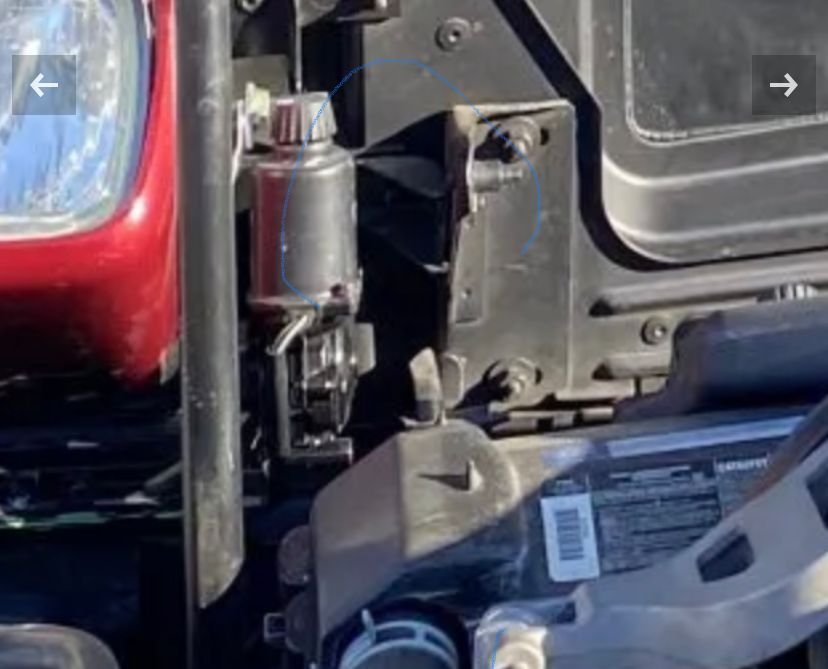

Additional support/bracing to the hood hinge.

Those are hood hinge supports

You can see it right between the motor and the hinge.

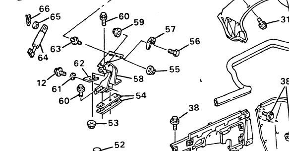

Only from a GM SPO. #27 this image?
Another from a hood hinge illustration. #57 and is serviced if needed.

Got it, i see now thank you...when I redid alot of these parts (hinge etc), I glass beaded then painted them, so no witness marks...
thanks again!
