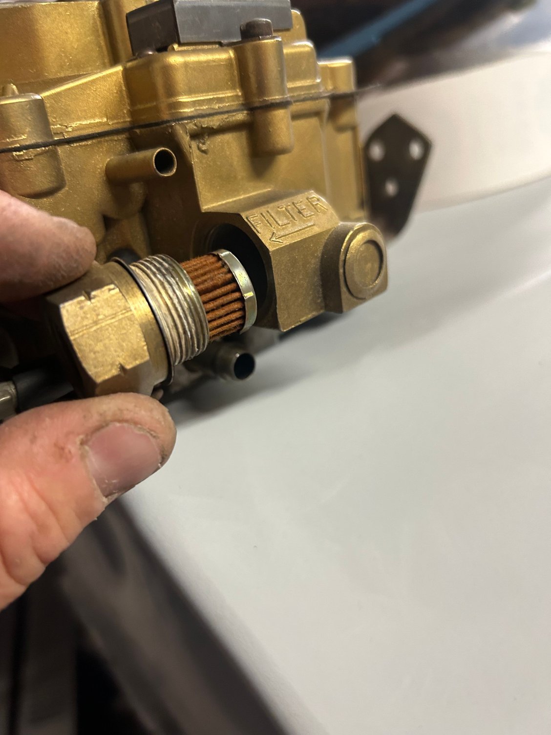

This is the filter I’m talking about

Sorry wrong forum
To 1992 Cold Start Problems
