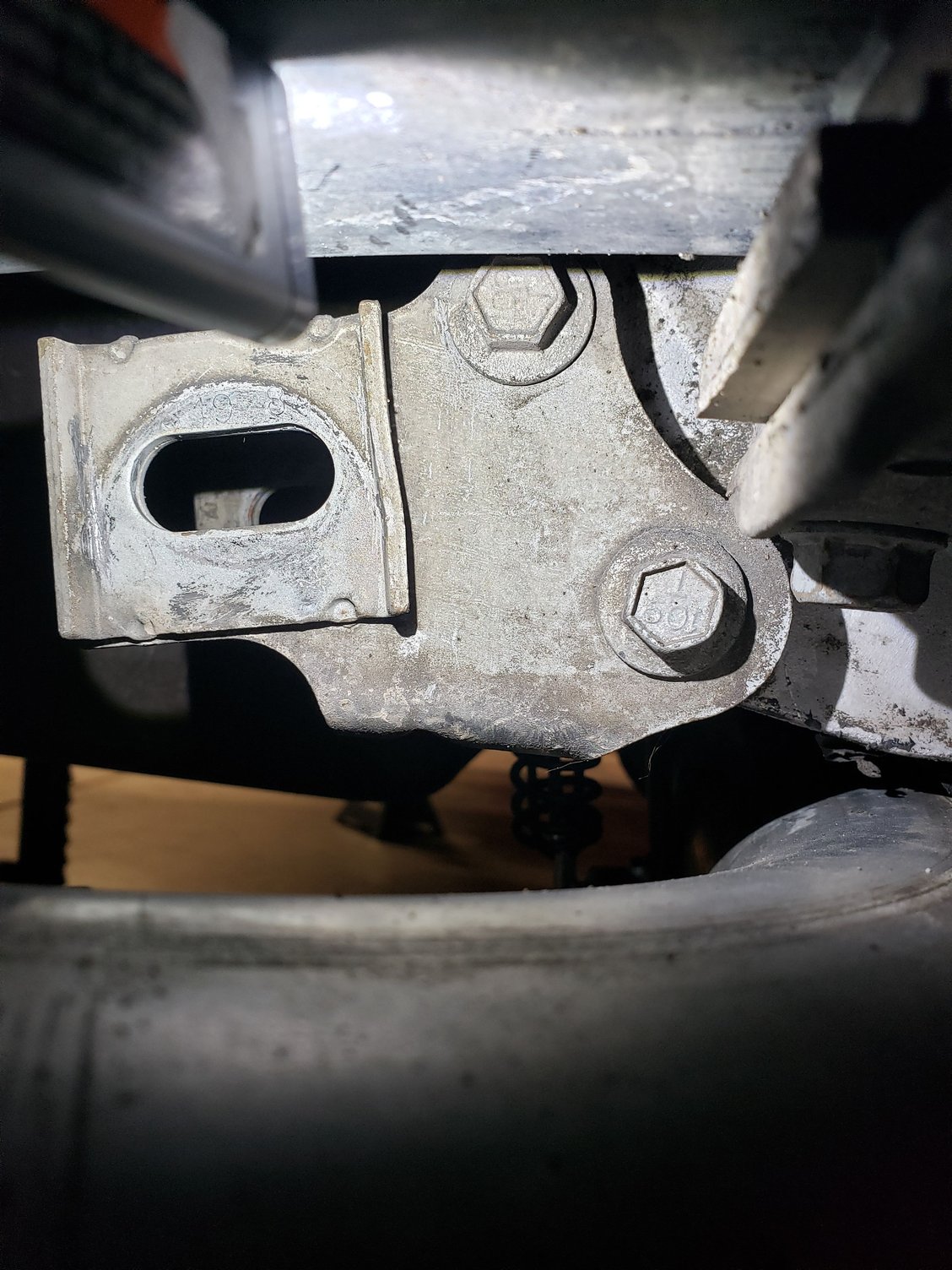

Dang I am a bone head. I tried loosening the lower strut camber arm bolts by wrenching the bolt heads facing rearwards, and I put a bend in the metal tabs of the brackets and interface with the eccentric washer thing.
Here is a pic. Did I trash these brackets or can an alignment shop still get me aligned?

Pic isn't showing up, but if you can't bend the bracket back then I bet you can find replacements from a salvage yard cheap. Or on eBay. Or use this as the perfect excuse to get rod-ended camber links from After Dark Speed!

find a set of stockers or as Matthew said venture over to ADS and get a set of his brackets.

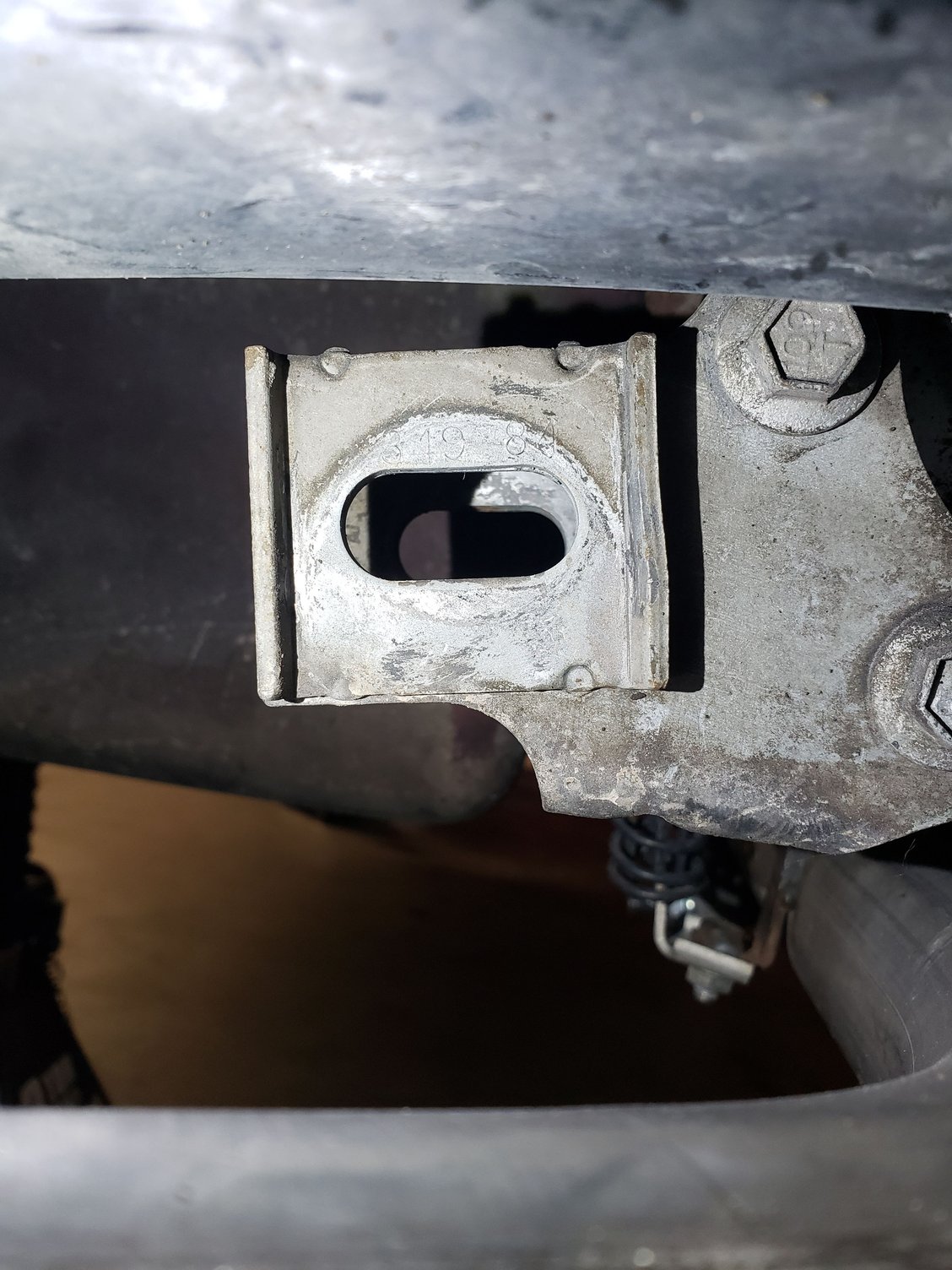

Is this camber bracket salvageable or did I goof it?
can I bend it back over?
I have a spare set of camber brackets from a 88+ car, but I assume I can't use them?

I'd take it off and give it a squeeze in the old vise, that should straighten right out!!! Should be fine, IMHO👍

sounds right to me! I hope not to repeat that error! I would say you torgued in that pretty hard.

Yak, your camber bracket doesn't look too bad to me. I agree with trying to straighten it in a vice, if possible; but after that I'd probably send it.
