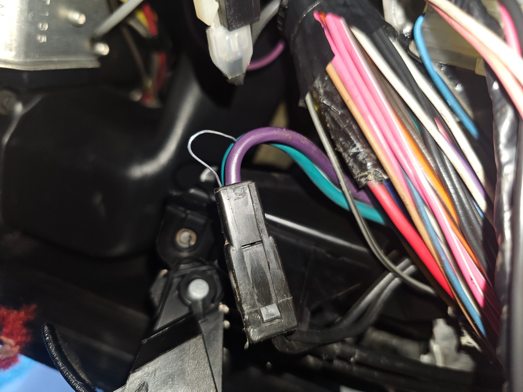

Clutch safety switch is #9 in this image. It will have 2 black wires to a connector that has PPL & GRN/WHT (8A-30-0 FSM). You need to 'jumper' PPL & GRN/WHT to by-pass. It sounds like maybe you didn't jumper the correct switch. Don't know but a jumper at the starter solenoid to battery stud should give you 'CRANK'. If it doesn't bad cables?

OK I just got the opportunity to try jumping that switch. It was really hidden up there! If you didn't show me that diagram I never would have found it. I couldn't figure out how the connector comes off so I went ahead and jumped it from the back of the wire like so.
Jumped clutch switch
Put the car in neutral and tried giving it a shot, still no start. However I do hear a clunking/clicking now when I try to start it, so I think you've put me on the right track. My dash is now measuring the battery at 11.5v, so maybe it just needs a jump now? I'd measure it with the multimeter if it weren't raining so heavily right now. Wondering if I just drained it from trying to start it.
Not sure how I'd go about adjusting this switch... I'm wondering if it would be easier to just put the spacer back on.
