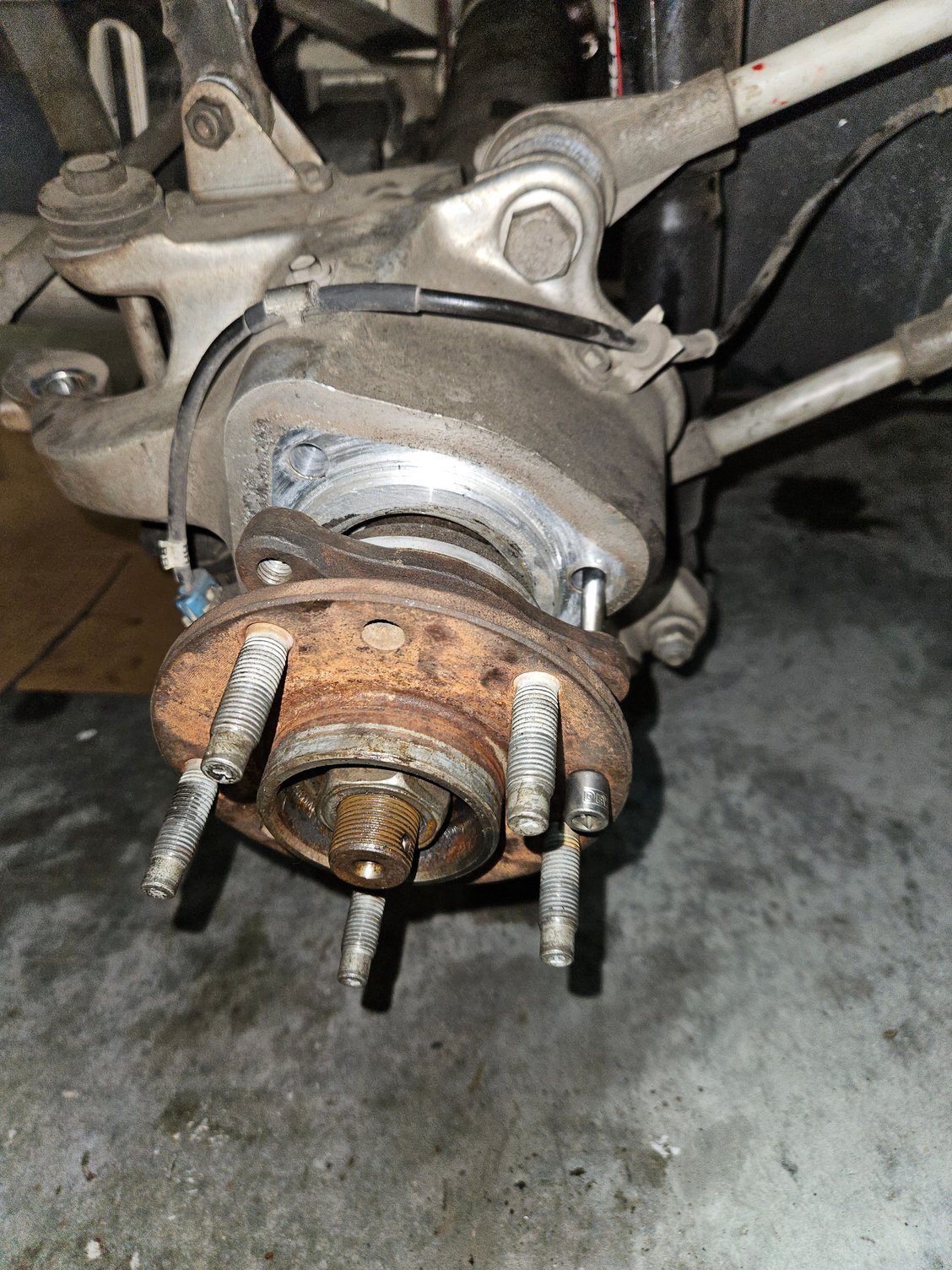

I was able to get the last bolt out. I was going at it at a slightly wrong angle it seems. Anyway, both wheel hubs are out.
In preparation to remove the half shafts, I removed the tie rods. No need for a fork and mess up the boots..I simply loosened the castle nut all the way to the end of the rod and tapped with the hammer. After 4 light-medium blows, it popped. The driver side popped out on it's own.
I moved on to the caps on the passenger side u joints. The bolts had a lot of surface rust, so it was a bit tough getting the socket on. I then realized I couldn't take the bolts off because the whole thing was spinning. So I got a bit smart and rigged a stop. See below. Notice the 1/4" ratchet extension.😉
Anyway, removed all cap bolts and caps. However, the chips were frozen in place, so I had to tap on them until they broke loose. After all that, I had a hell of a time removing the shaft, so I removed the cross link at the bottom of the knuckle. No dice, so I loosened up the trailing arms. After slicing my forearm with the cutter pin on the spring bolt, I was able to drop the shaft by pulling the knuckle out and allowing for clearance.

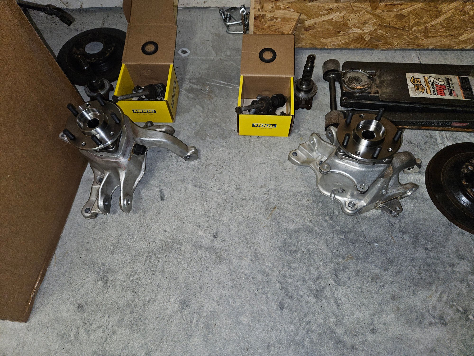

At the end of the day, I had to remove the driver's side knuckle. The u-joint caps were frozen in place against both inner and outer yokes. At that point I figure I'd remove the passenger side as well. Even with the knuckle removed, the shaft was still hanging there without support.

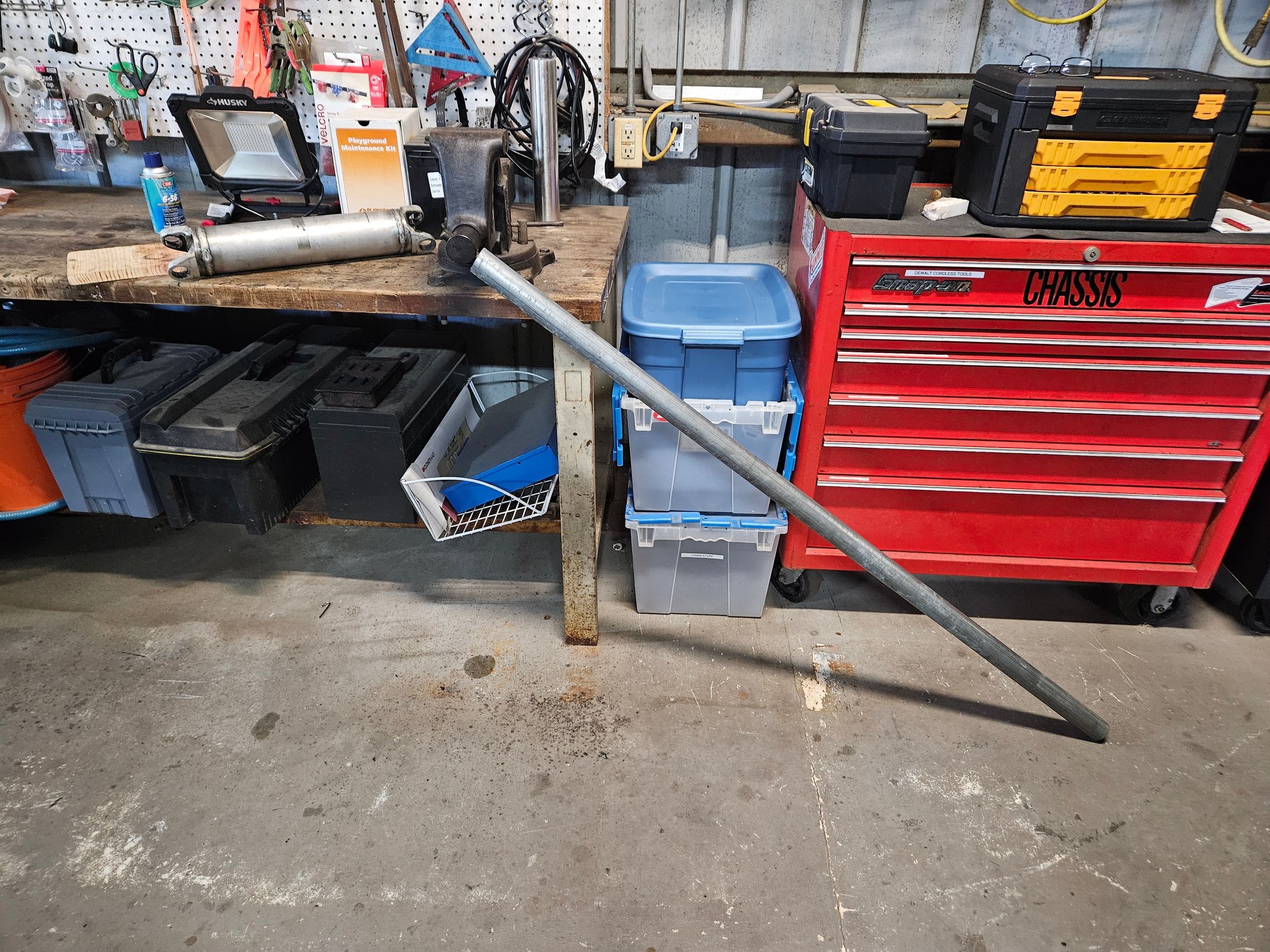

The old u-joints were also a pain. Again, completely bonded to the aluminum ears on the shafts. It too a heavy duty vice and 5"3" pipe to break them lose.
Knuckles all cleaned up with new Moog hubs installed and torqued to 65 lbs-ft.
One last update, I had also ordered Moog u-joints which are now installed on the half shafts.
Since I was already there, I ordered Super Pro bushing for the trailing arms (dog bones), which I installed today.

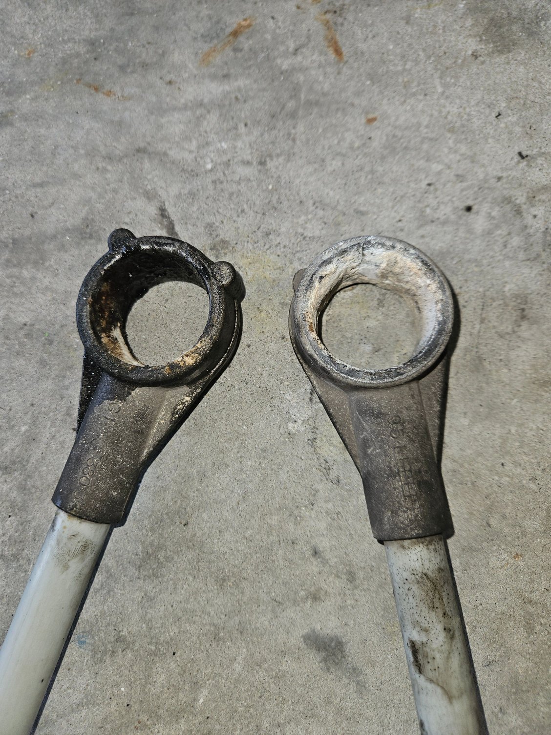

One other thing...this is what the dog bones looked like. HEAVY buildup of deposits right between the bushing and the aluminum. It was most prevalent on the ends, both bottom and top, that attach to the body. After removing all that corrosion, there was heavy pitting on the aluminum.
