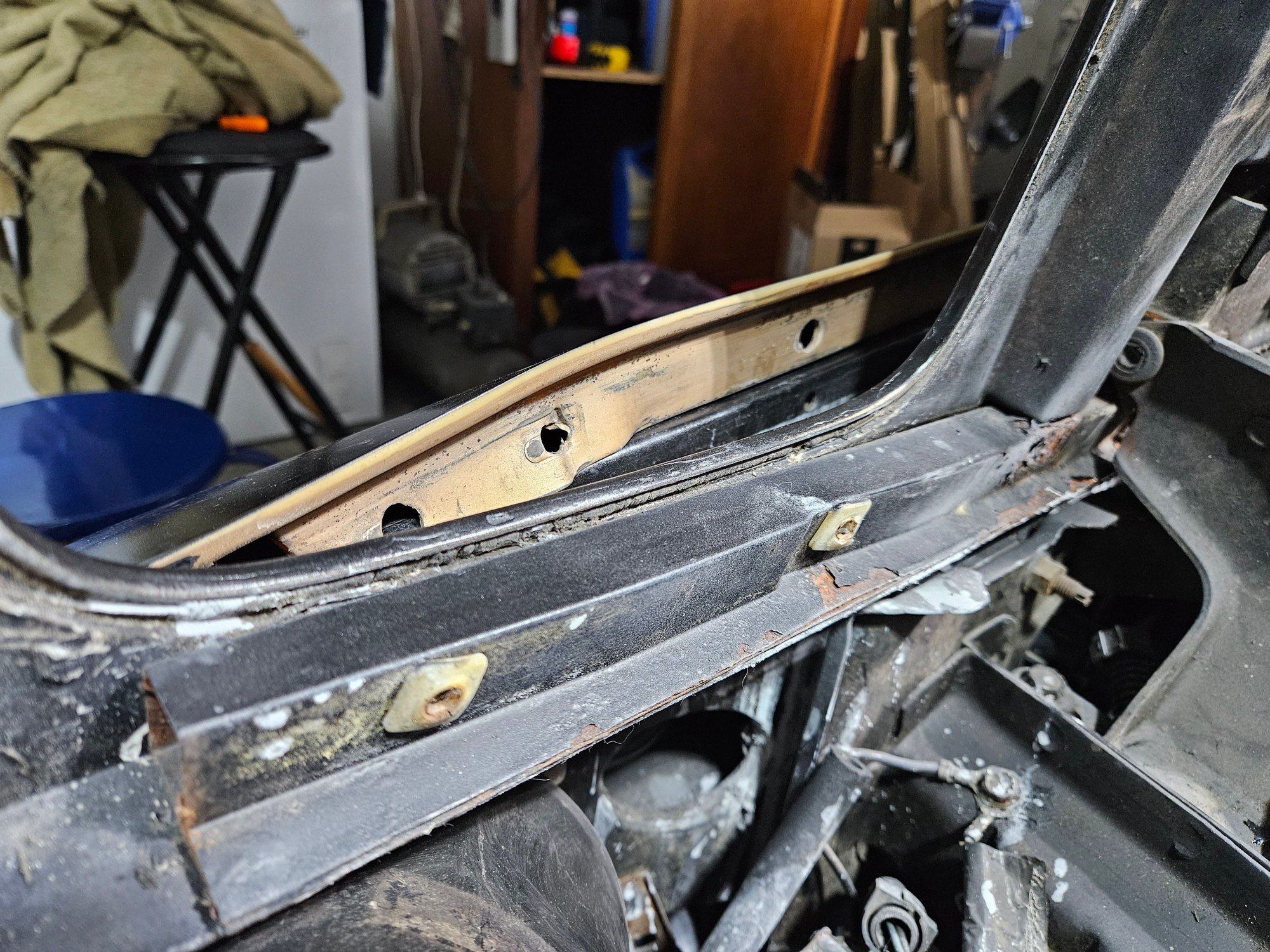

I'm attempting to reinstall the front bumper cover on my '84, and can't get it that last 1/2 inch or so to get it over the reinforcement.
The cover is in place at the bottom and the openings are clear of the fog lamps. Is there some "weird trick" I'm missing?
