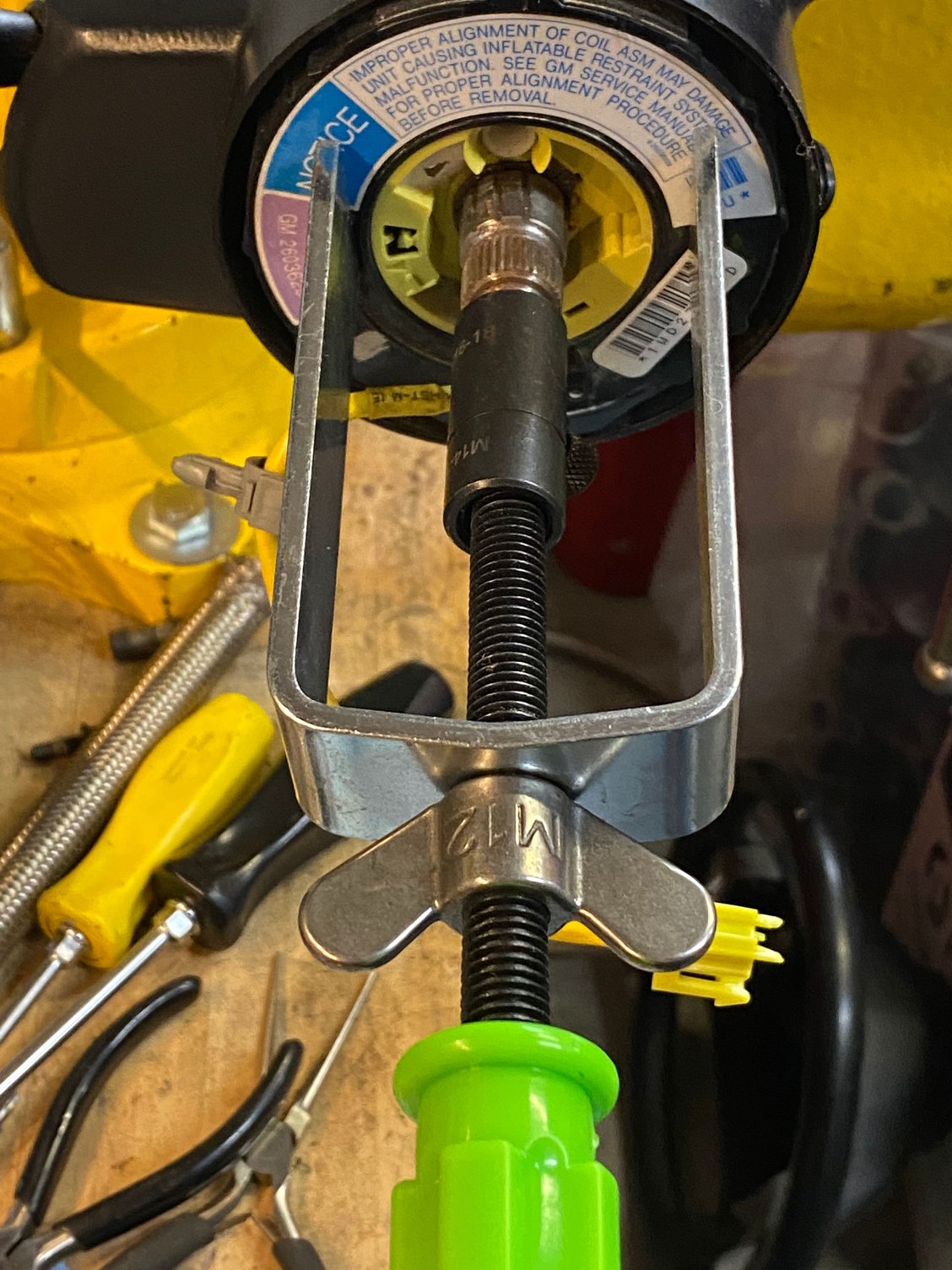

You need a clock spring removal tool. It will compress the clock spring and you will remove the snapping that holds it in place. Then from there you use the tool again to help remove the lock plate that is next.

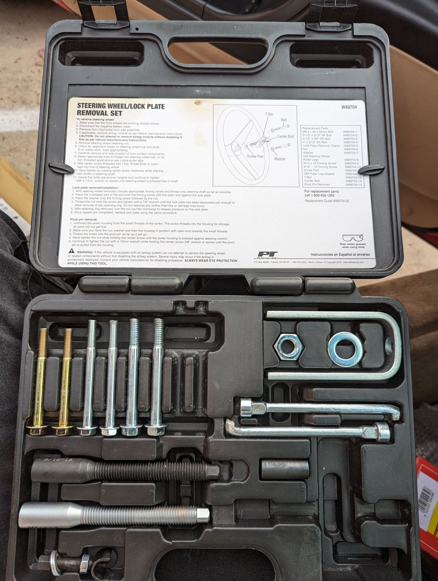

Ok, good news the Clock Spring Remover was included in the Steering wheel removal set, or it might be the same as the Lock Plate remover in this kit—they look identical. However, could you provide a quick walkthrough on setting up/using this tool? Unfortunately, there aren't many online resources on using them, and after reading your advice, I want to make sure I do this correctly. Thanks a lot!

It's not tough thread tool on to shaft position the U on each side of the lock plate and compress enough to take pressure off wire clip. Take a trans pick and slide clip off, release the spring tension remove tool and secure the clocking coil with the tie wrap so as not to damage.

From your point, screw the lock plate remover on and spin the wing it down to put pressure on the clock spring.

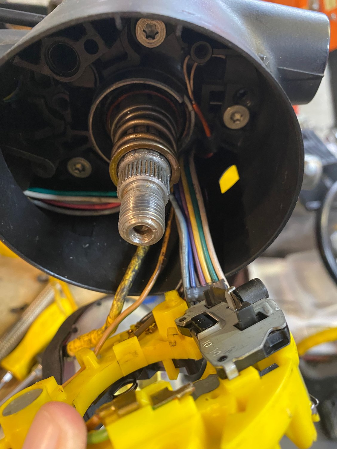

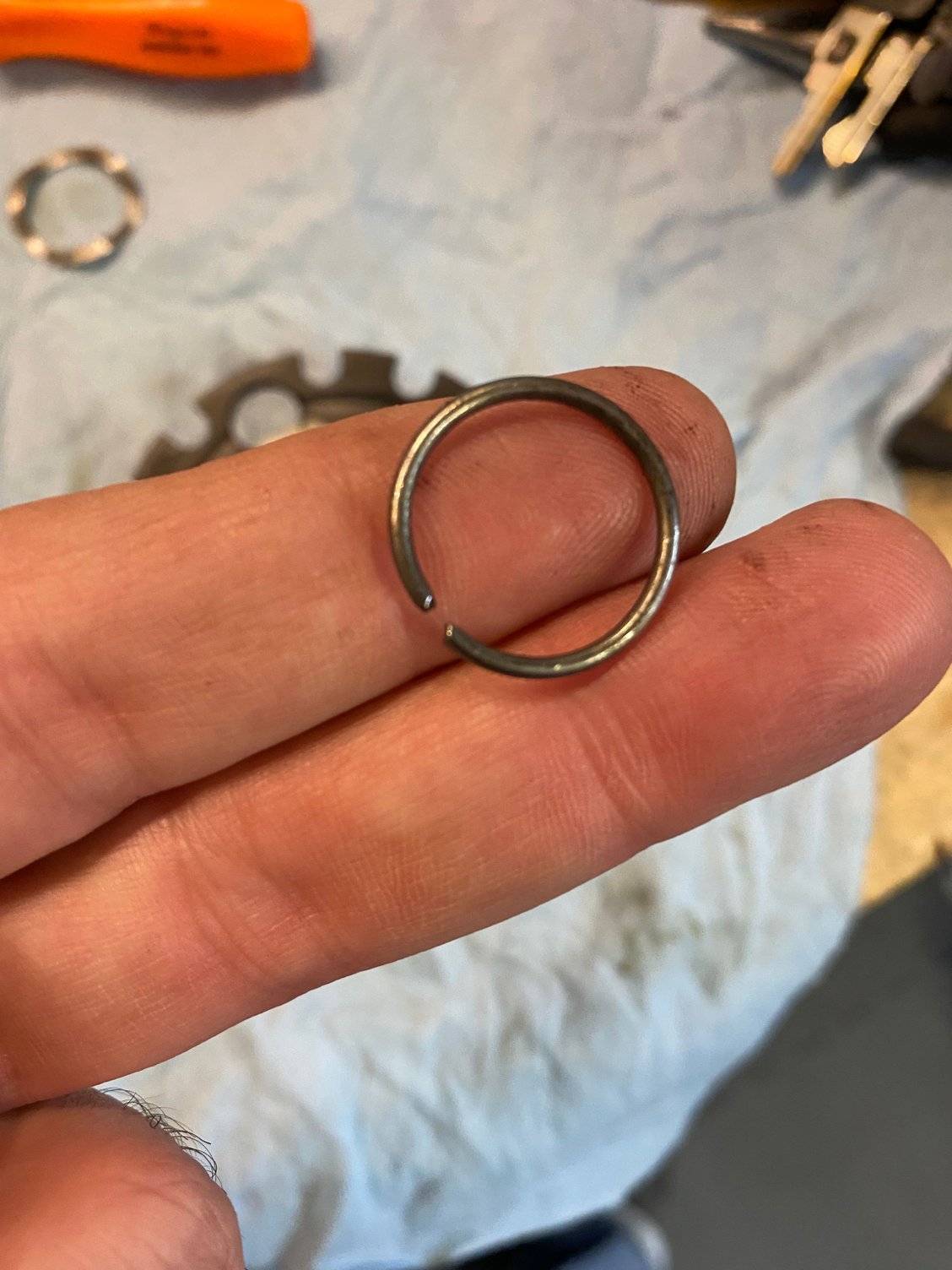

you will then create a gap and either use a pick or snap ring pliers to remove the snapping and slide it off the shaft. Remove the lock plate tool and then flip the coil out of the way, you tug on the harness snd get a few more inches to let it dangle. No need to worry about locking it in place as it has a brake on the back to keep it from unwinding,

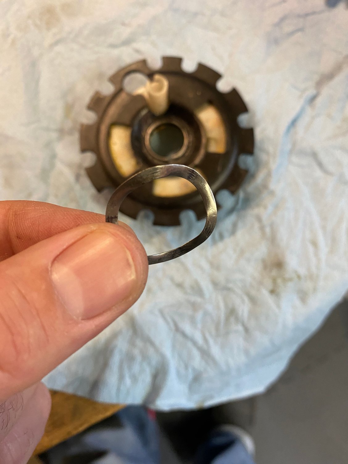

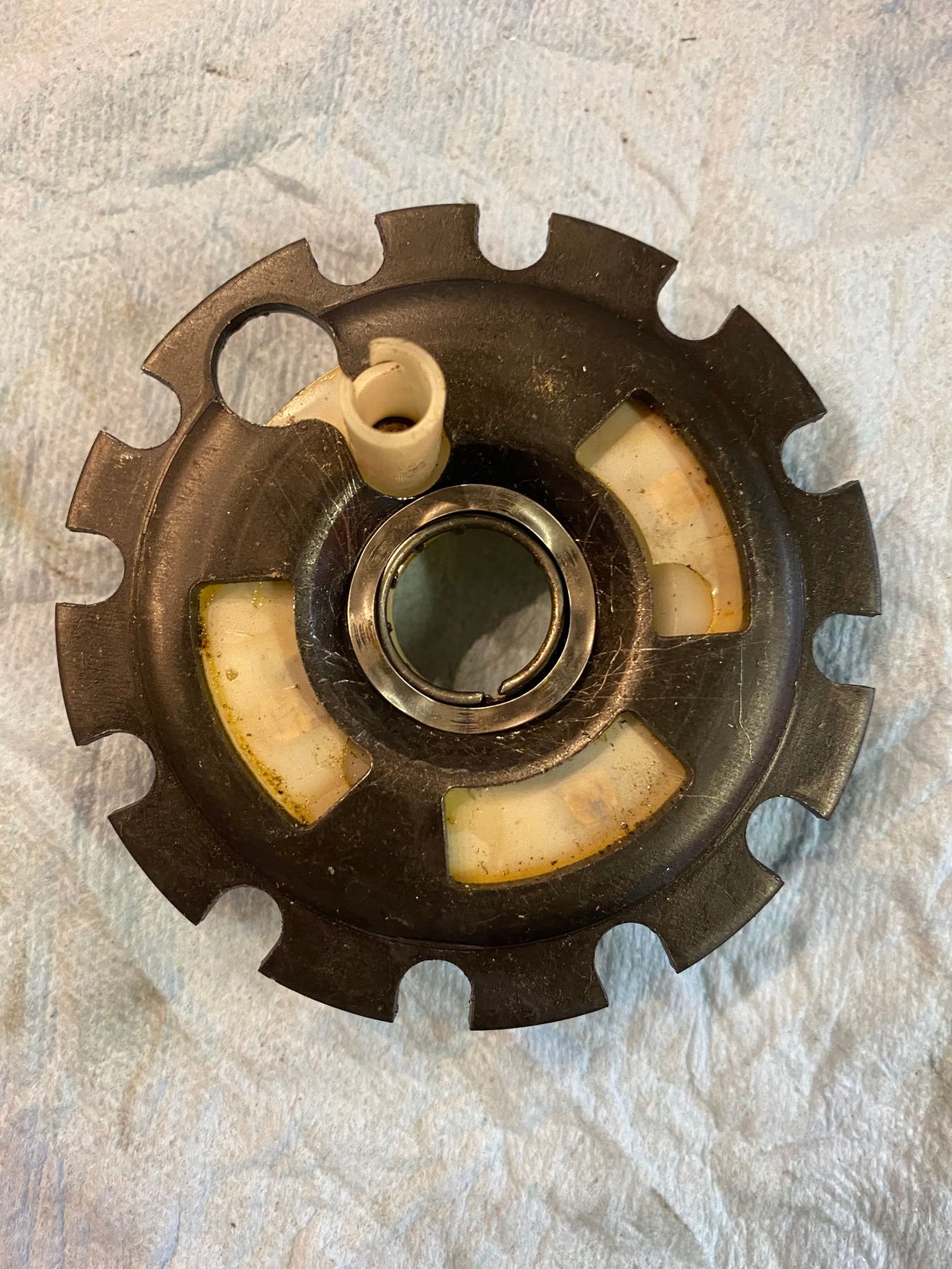

Install the lock plate tool and depress the lock plate. There is a wave lock washer that will slide off. And then beneath it a cir-clip. Use a pick to remove the cir-clip and slid both it and the washer up the shaft. Now the lock plate and the plastic guide for the horn ground contact will come off.
at this point you are done with the upper end.

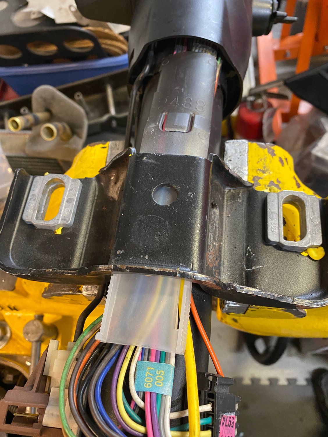

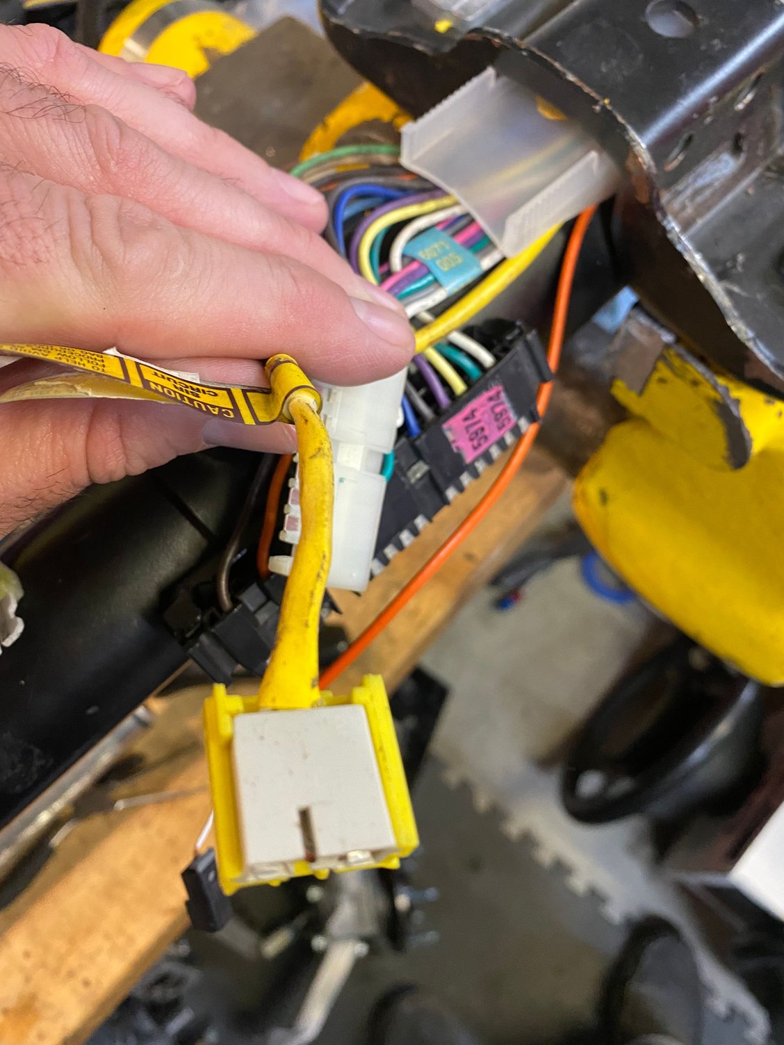

Now go to the mid line of the column where all the connectors are. Disconnect the yellow wire. And then slide the protective sheath off the column. This should give you all the room you need to get the harness out.

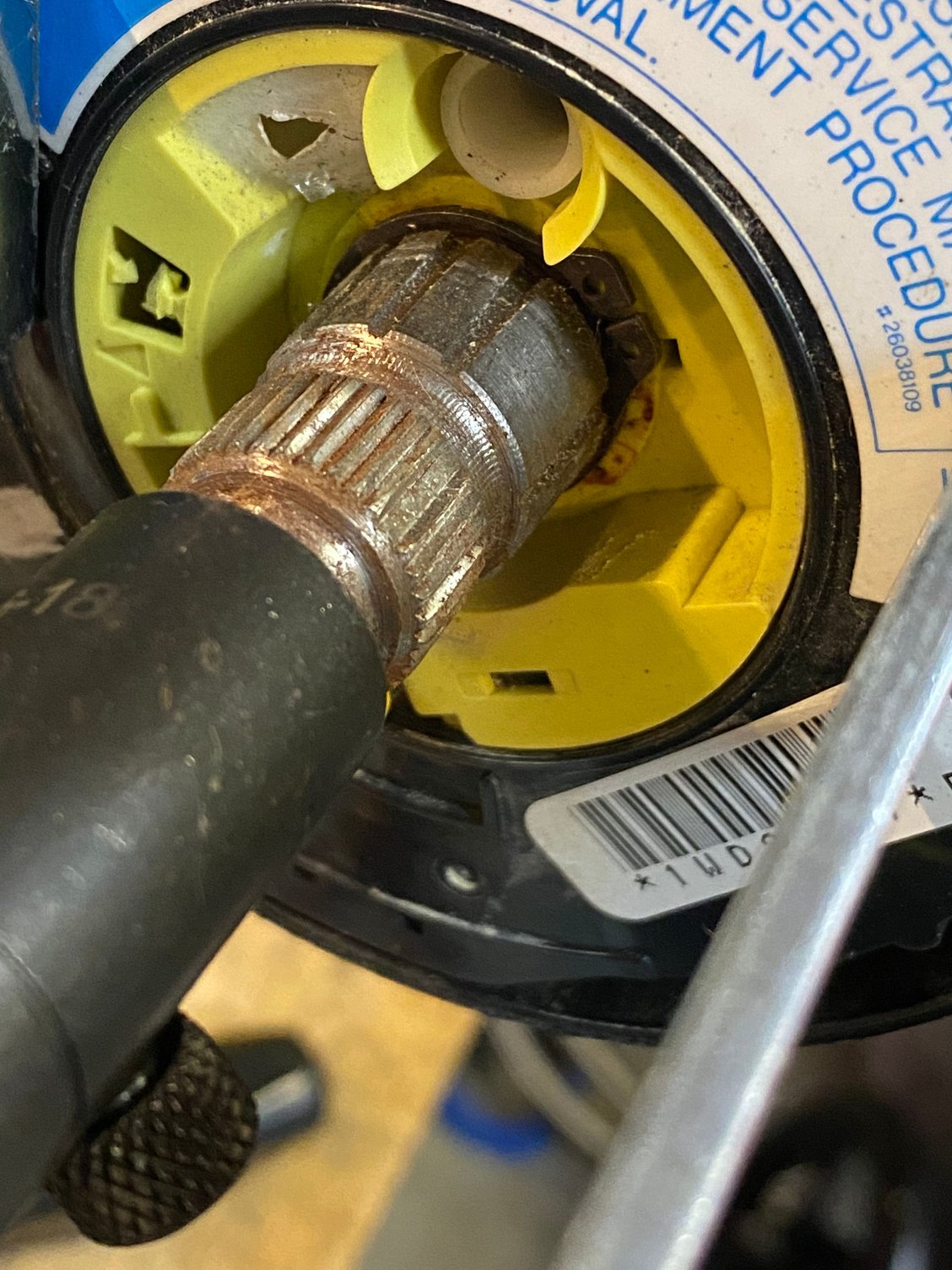

Sorry to bother but I have one more question. I've applied pressure with the tool on the plate, but I'm uncertain about where exactly to use the pick for sliding it off. And I'm supposed to apply enough pressure to create a visible gap between them before using the pick? I started hearing cracking before seeing a gap, so I wanted to confirm before attempting trial and error.

You need to get enough pressure off to wear the snap ring spins freely. At that point you take the pick and start working the clip off or preferable snap ring pliers.
Is there a way to de-pin this connector? Then just pull the other end of the cable from the steering column?
Yes, you can de-pin the connector. But damage to the exposed pins is higher when you pull them through the column.
